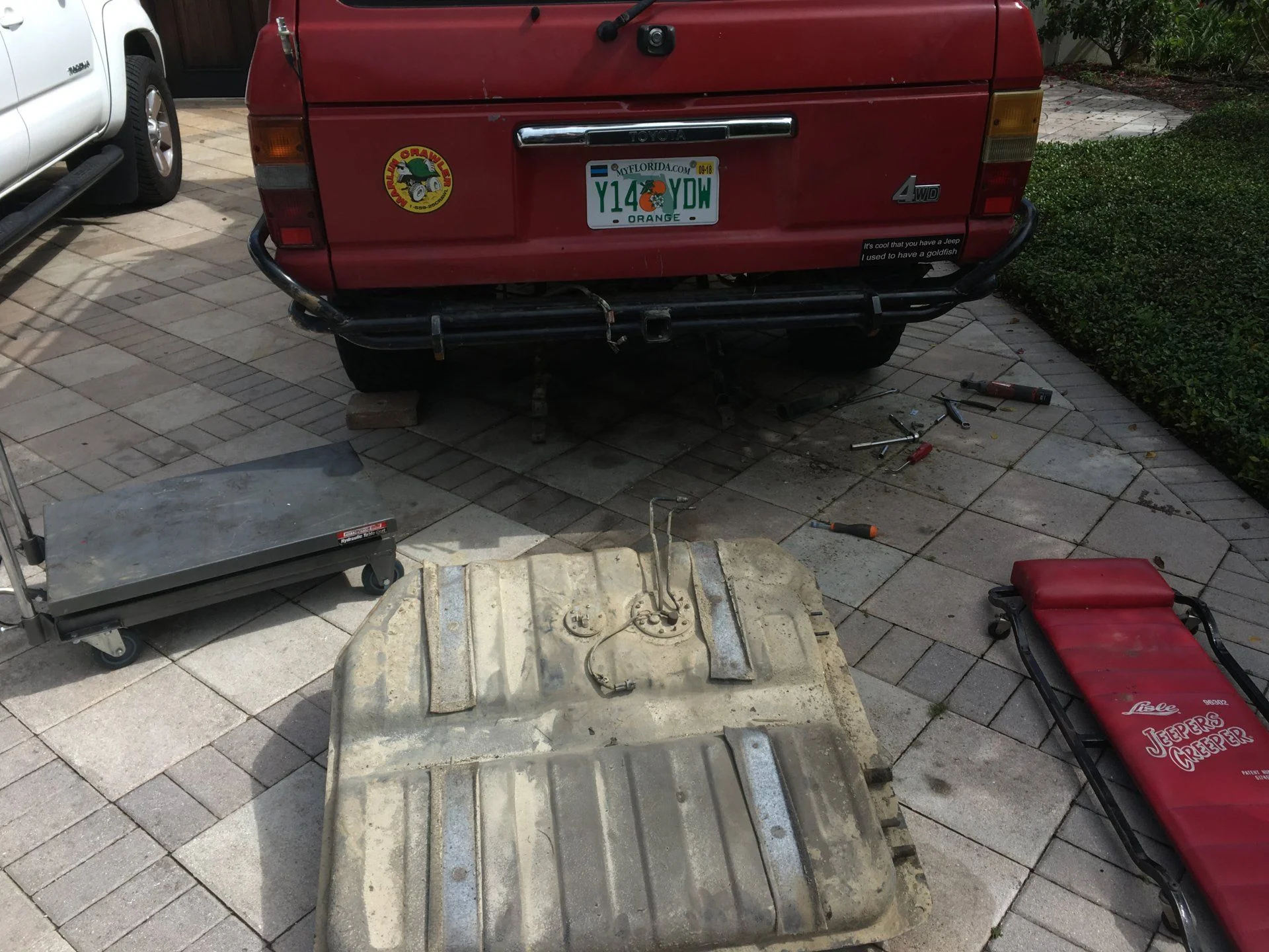

TCA324HP ordered and tank pulled... let’s see what happens.

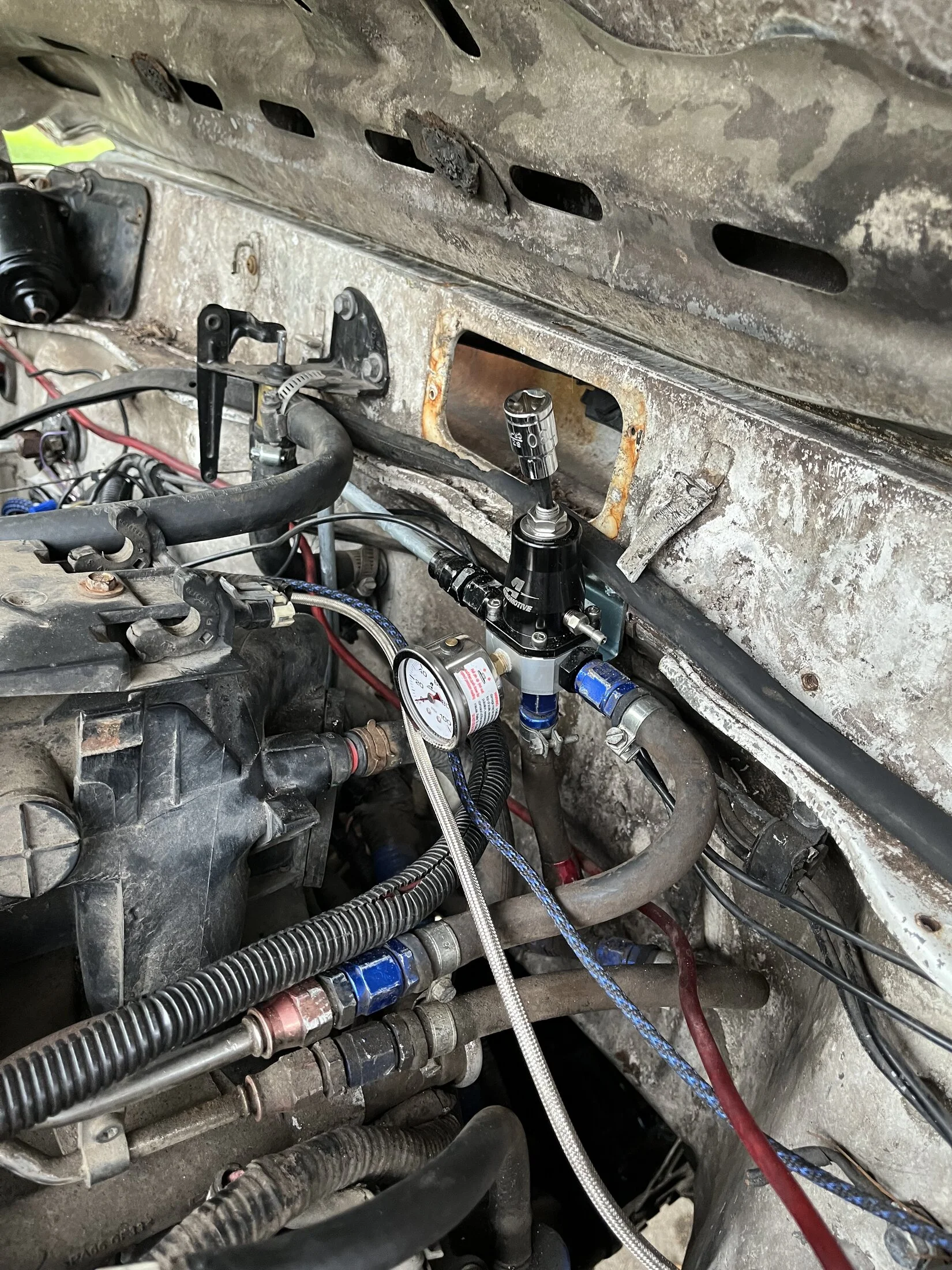

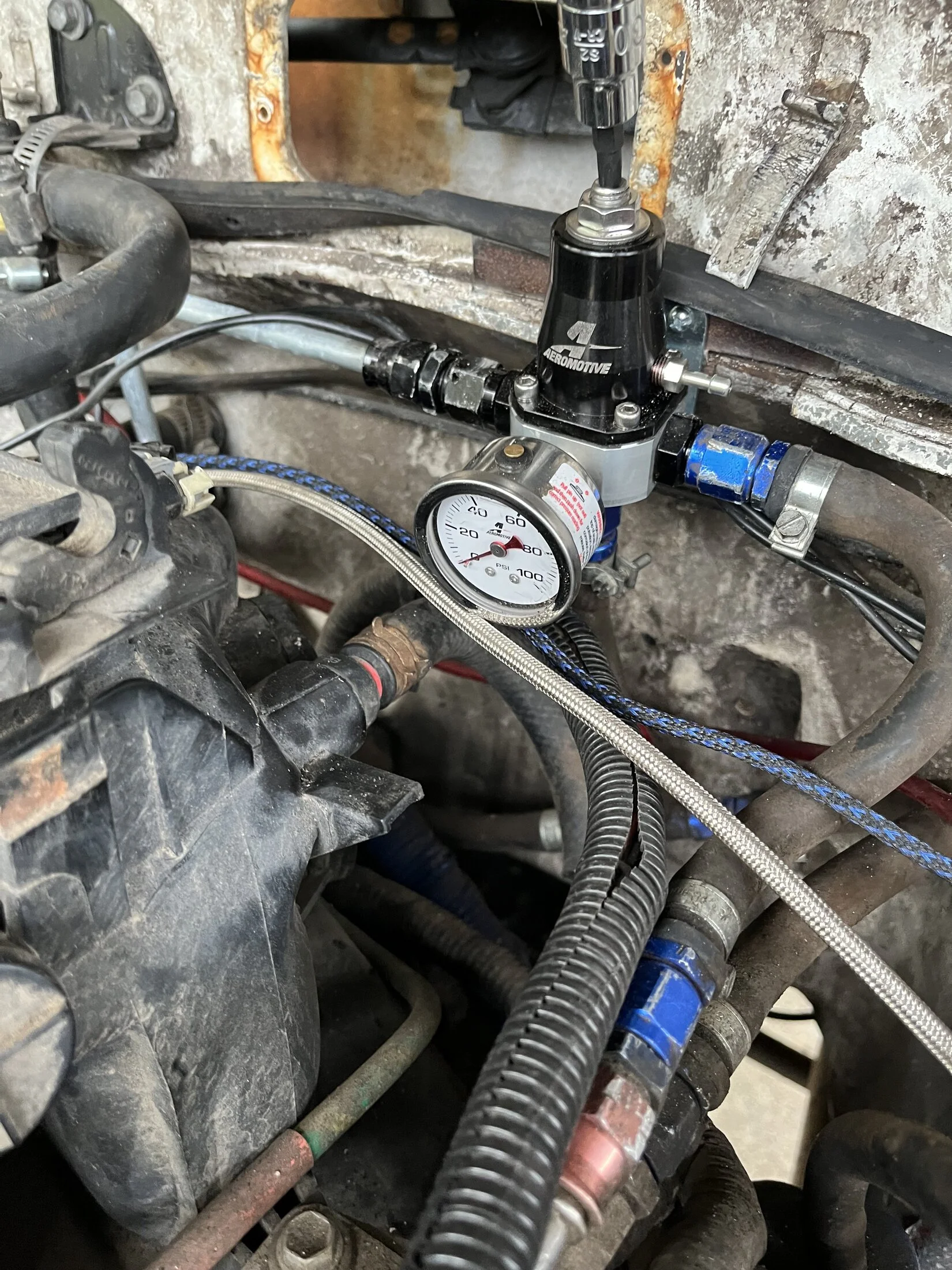

Are the FJ62 and FJ60 fuel pump brackets the same? I am still having fuel delivery issues (new Oreillys inline pump & fuel filters, new aeromotive fpr) with my 60. While looking into the issue I found the my 60 has 2 fuel pressure regulators, I still can’t get more than 42psi for about 30 seconds and then, pressure drops. Thinking of eliminating the Aeromotive and just running the manual one with in tank pump instead of inline.
Return style doesn't need anything but the gm fuel pressure regulator so you can remove the aftermarket one and no the 60 and 62 fuel pump module are not the same.
