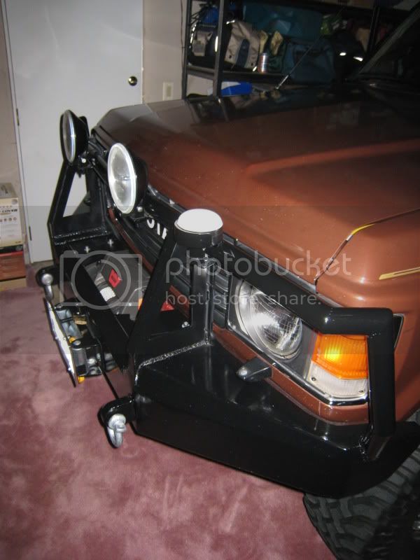

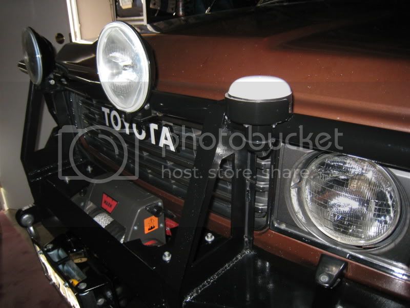

New Garmin antenna bumper mount.

Slick job on the mounting. I had mine on the roof, in one of the OEM rack bolt holes. Yours looks better. What did you make it out of?
Bought a large 4 inch washer and a foot of 1/16 x1 steel. Wraped and welded the front half top of the washer with the 16th for a rock sheild. Then did the same for the lower half front of the washer around the existing center opening to protect the wire/connection. Drilled 3 additional holes for the mount, welded the washer to the top tube of the bumper, then Krylon.
