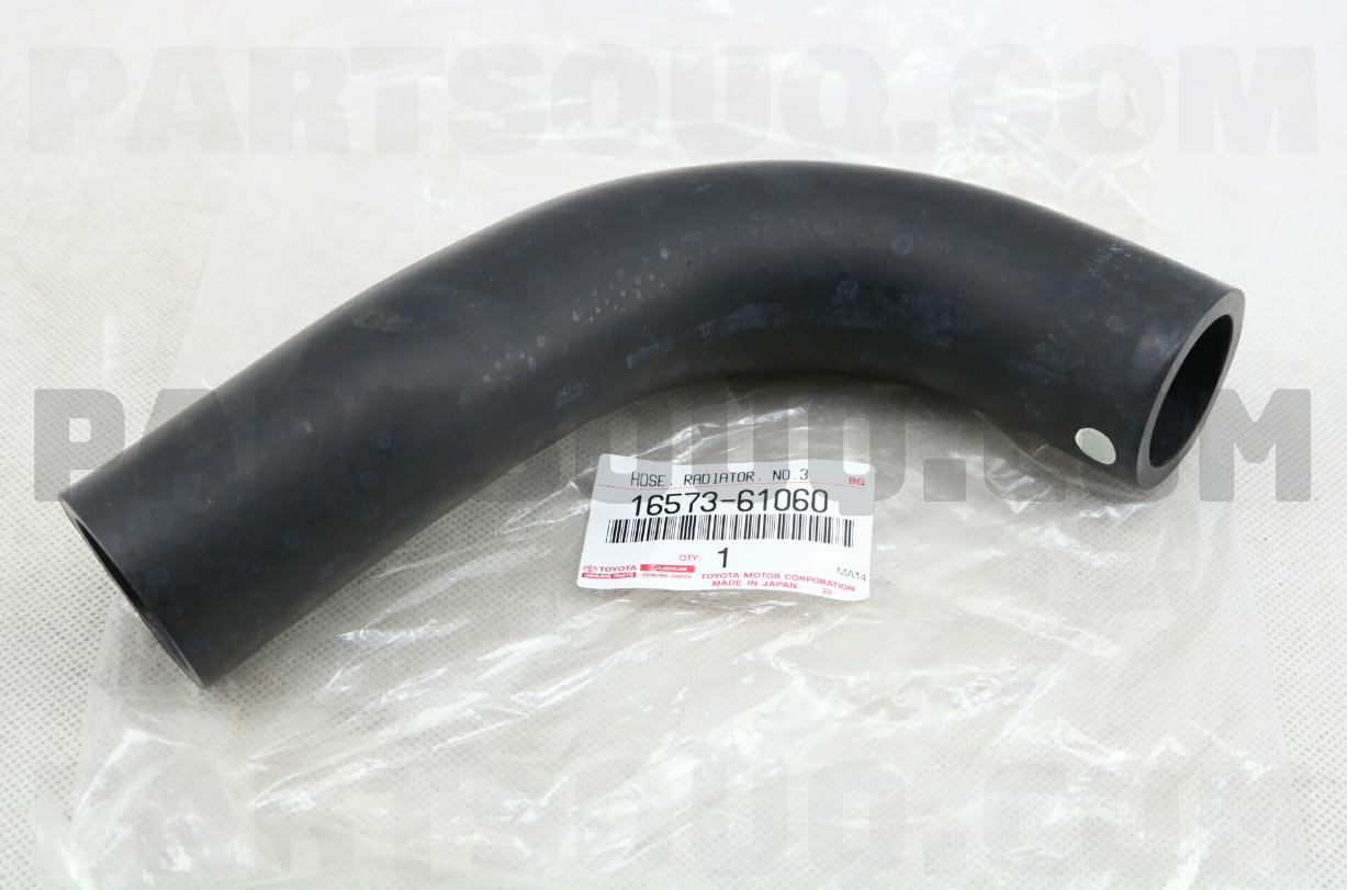

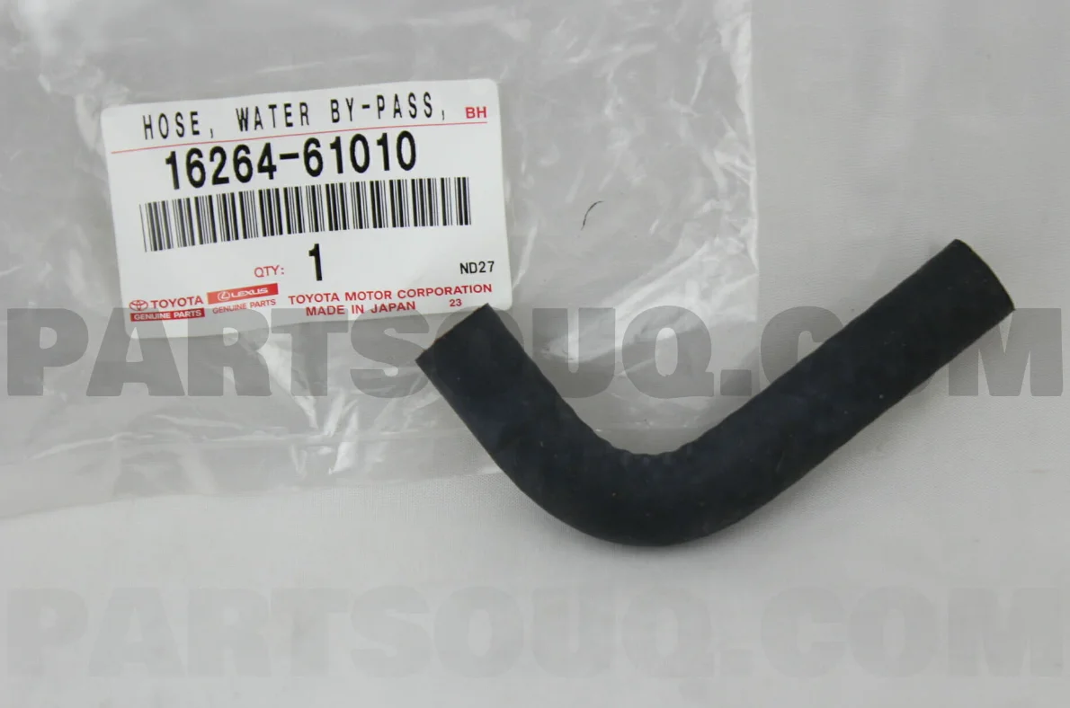

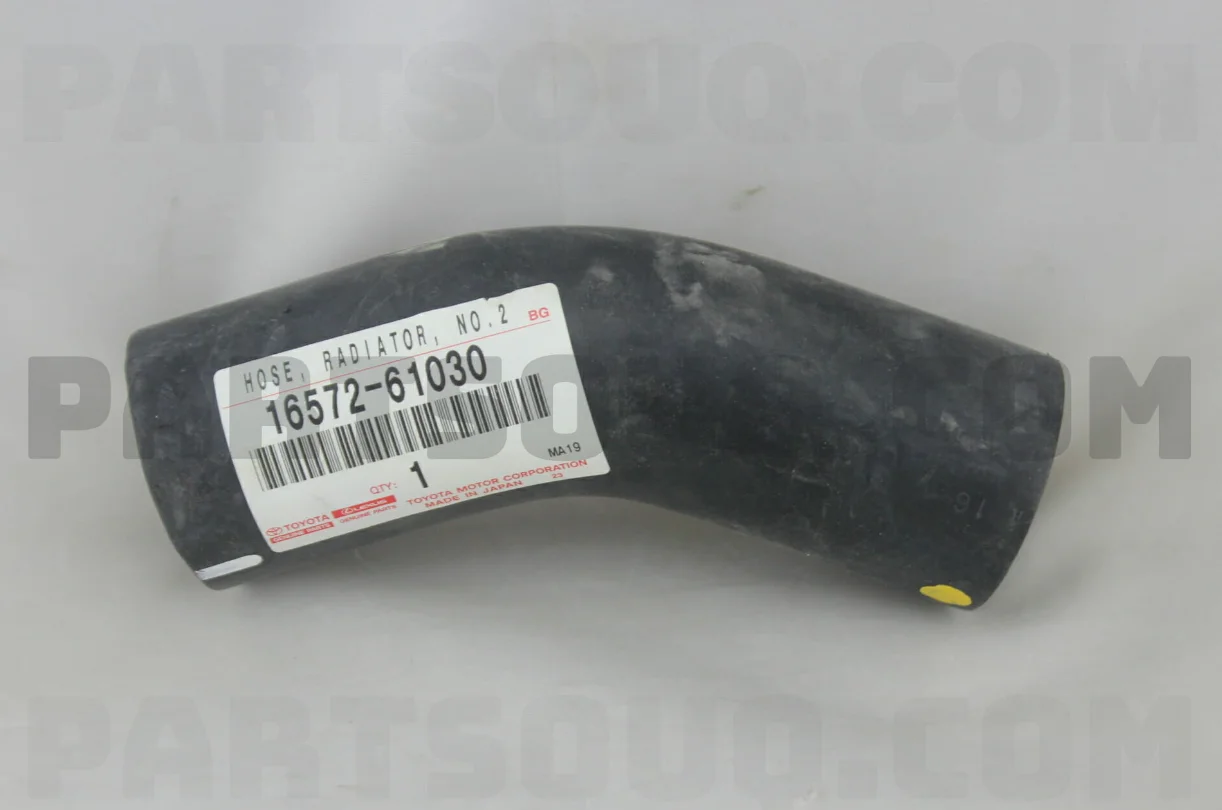

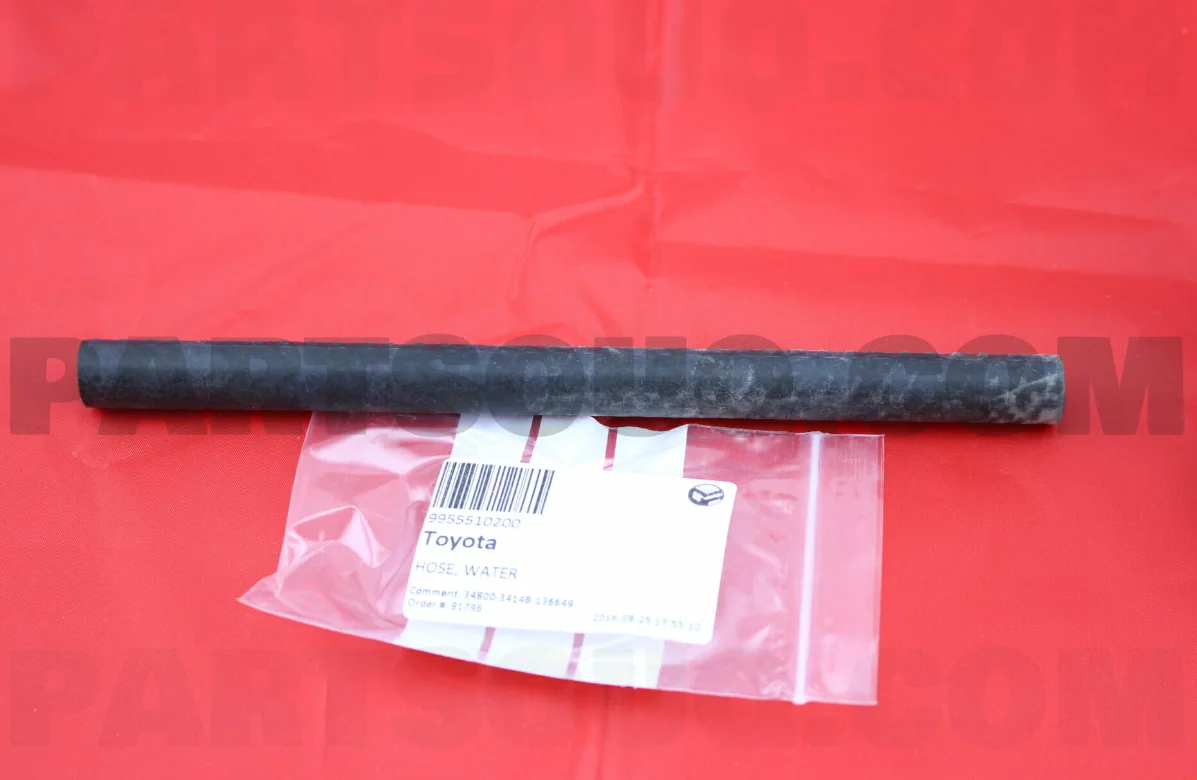

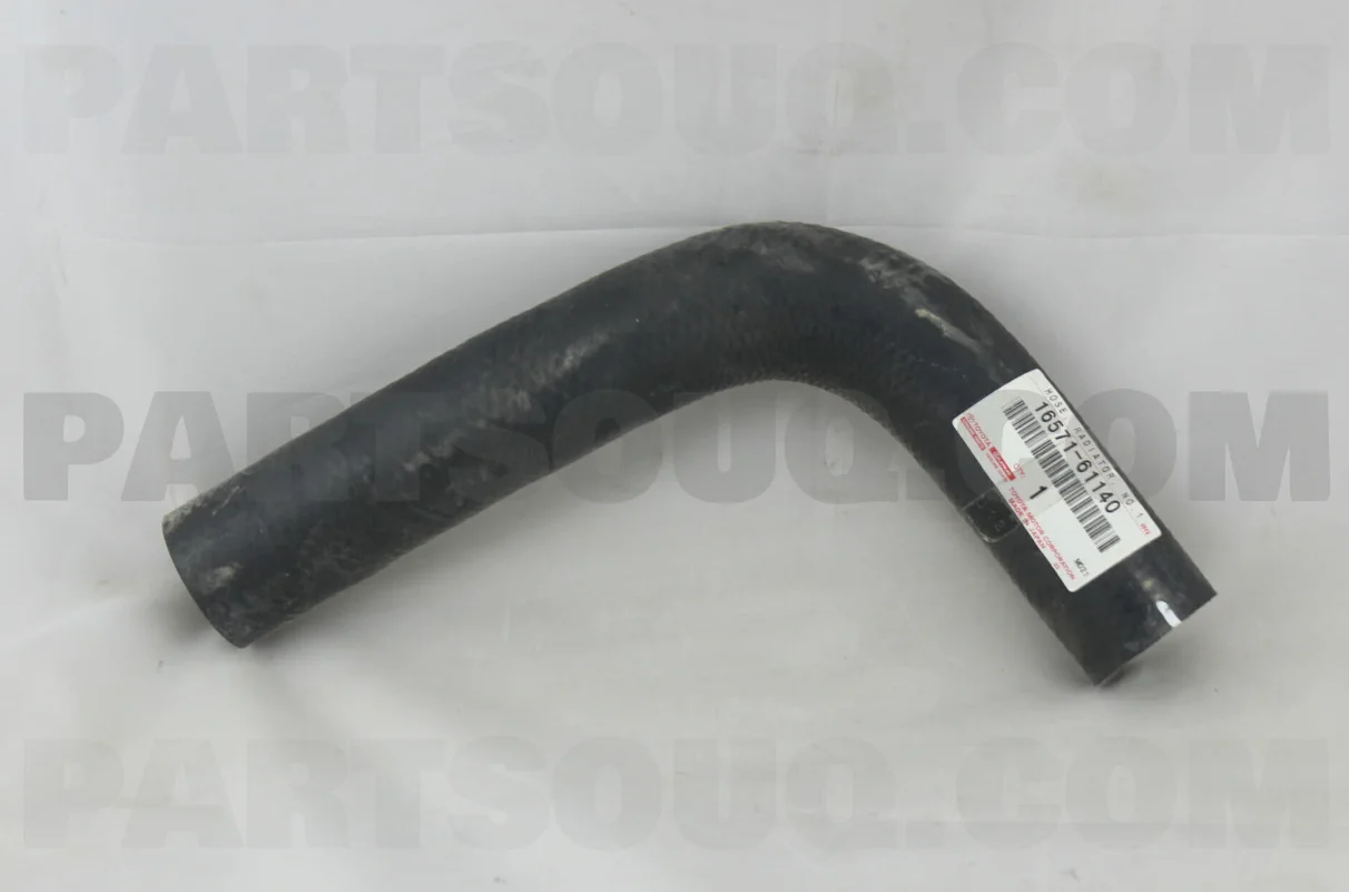

All 3 radiator hoses for the 3FE. Hose number 2 and 3 are the lower 2 joined by the hard pipe that is bolted to the bottom of the block. Hose #1 is the upper radiator hose. Don't forget the 2 bypass hoses on the top of the thermostat housing and the straight piece of bypass hose that lives downstream of the hard pipes above the starter. If one of those hoses need to be replaced, they ALL need to be replaced. Try to use OEM parts where possible, and don't rely on NAPA for the correct parts.
