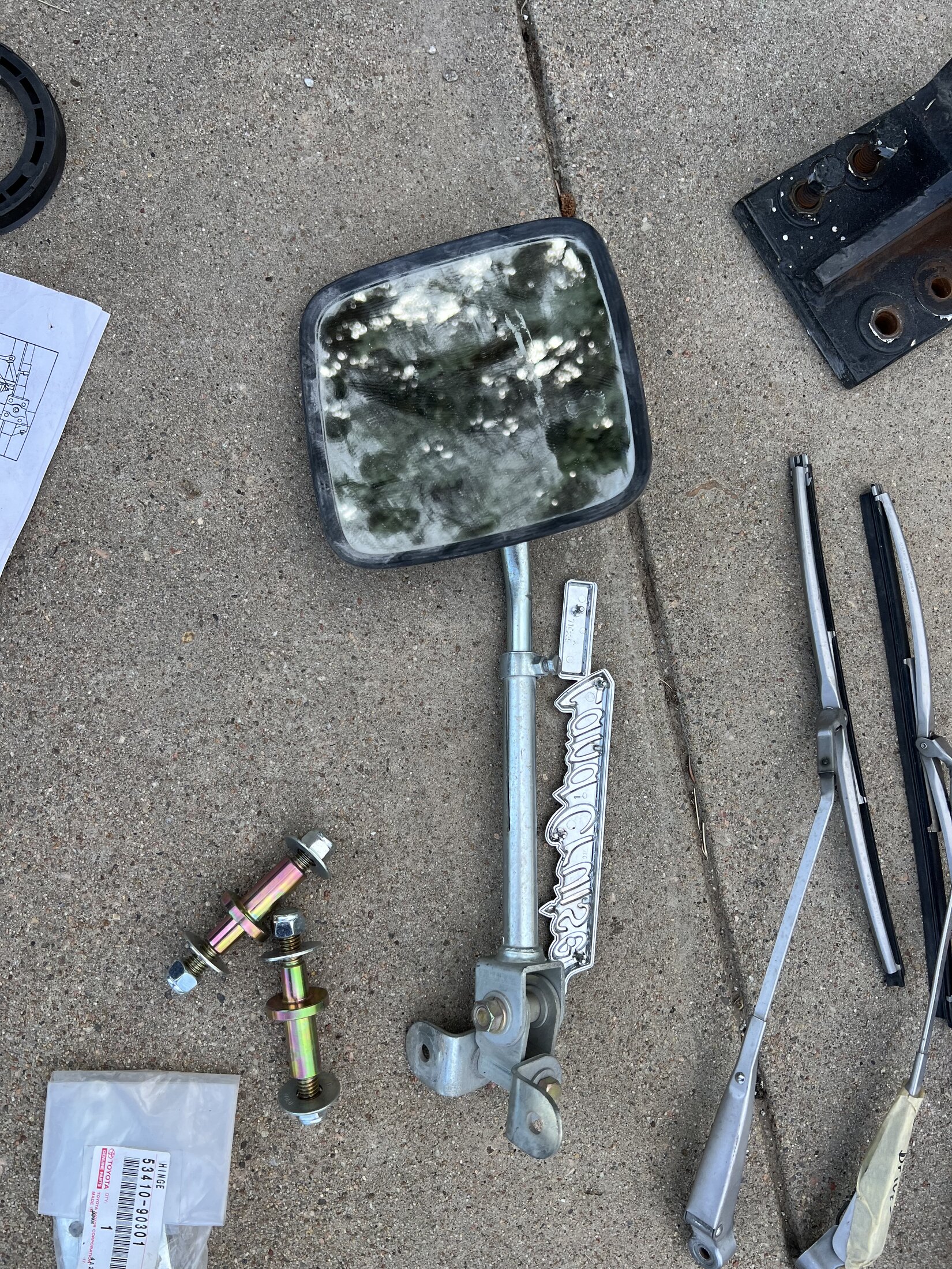

PM me if you want pins - I have some parts I got when I bought out a guys parts in MN I need to get rid of.
I know this isn’t classified the classified section.
