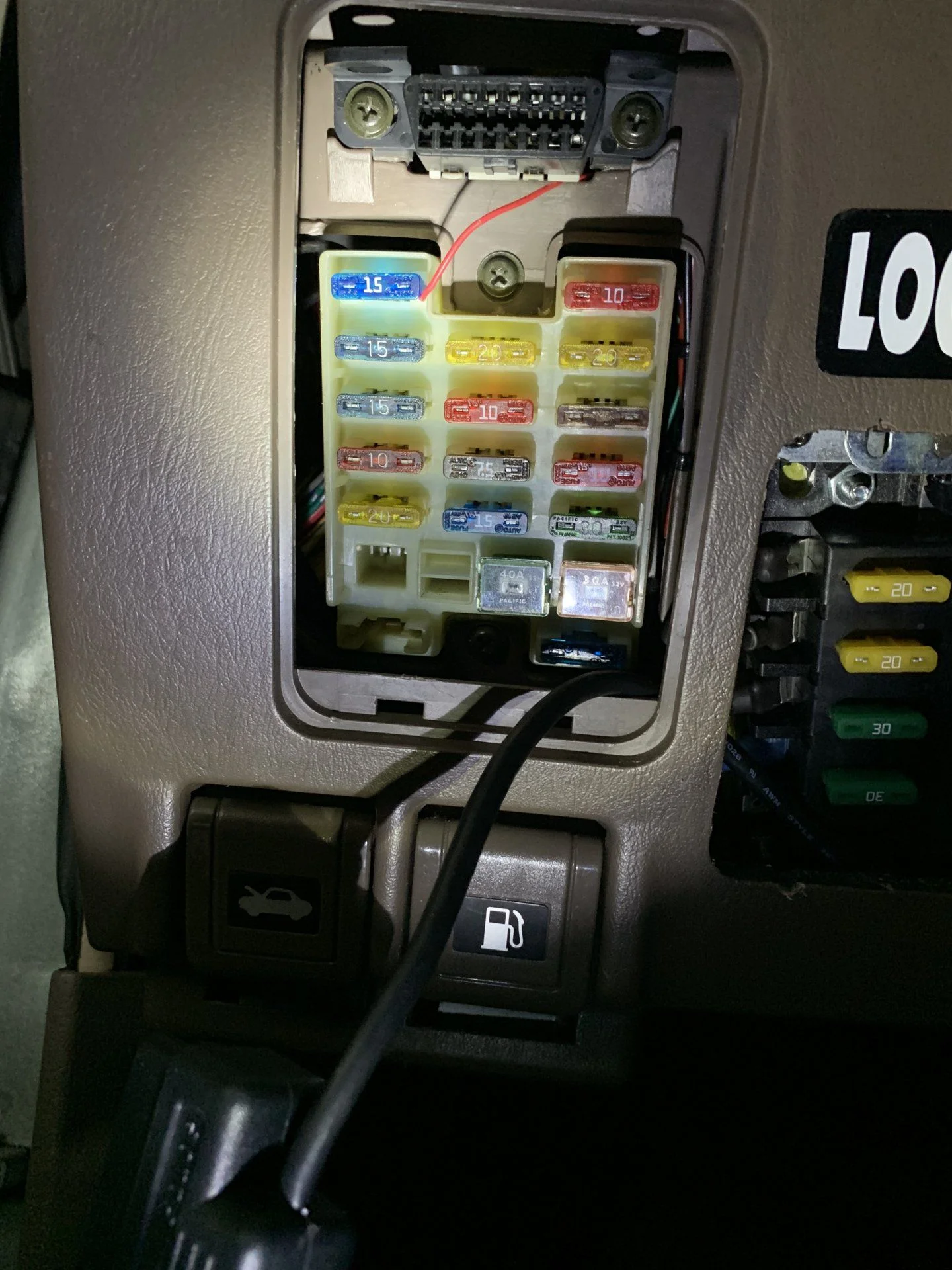

1997 LX450. Recently hard wired a dash cam to the fuse box.
At idle, I am reading steady 11.7V and my hard wired dash cam shuts off.
When I give it some gas, the voltage rises up to 14V and the dash cam turns back on but then immediately goes back down to 11.7 when I let off the gas and then the cam shuts off again. Does anyone know what could be causing this?

Where exactly did you wire the dash cam power?
15A cig lighter fuse. Don’t think the dash cam is causing it. It seems to be fine when receiving 12V. Only going out when volts drop under 11.6 or so.
