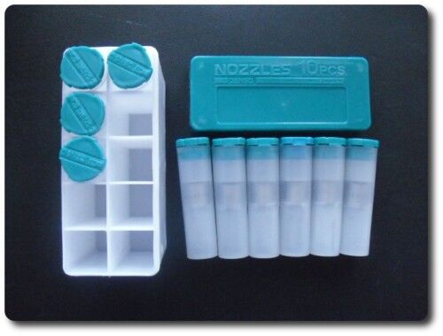

Anyone bought from this seller? ->
I contacted them and they assured me they're Genuine Denso injectors but I trust no one on ebay tbh.
Is there a way to confirm they are Genuine Denso when they arrive?
What do you think guys is this price to good to be true?
--Thanks in advance

I’ve bought two or even three sets from that eBay seller. They came packaged in denso packaging and had a cursive D on the nozzles. The ones I removed had ND. Its likely the logo changed. I have about 20k miles on since installed and one of the other sets are in @bottombracket ’s hj61. I’m not sure how many miles he’s put on his so far.
I’m closing in on 5,000 miles; zero issues. Runs like a stinky sewing machine thanks to @roma042987.
