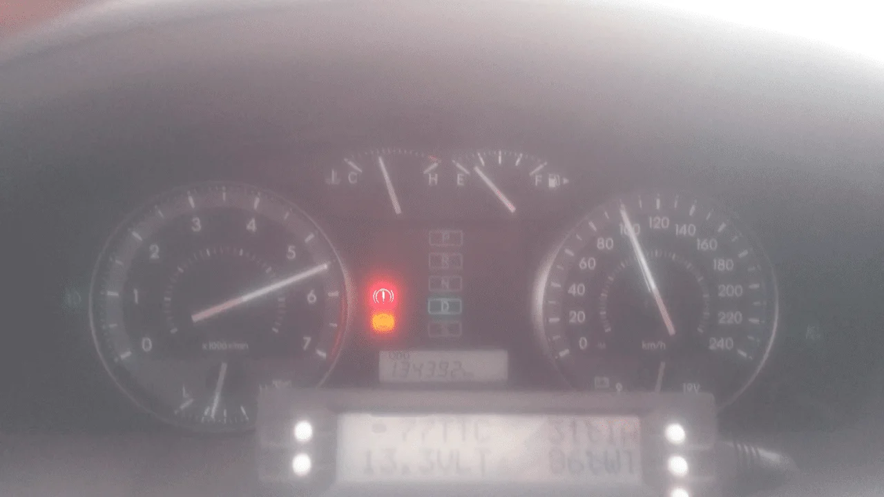

Found a video i took after I installed a transmission shift kit, the oil pressure gauge never moved through hard acceleration until I let off the gas and even then it jumped a hair over 1/2. I'll have a look today as well how it reacts on wot.
