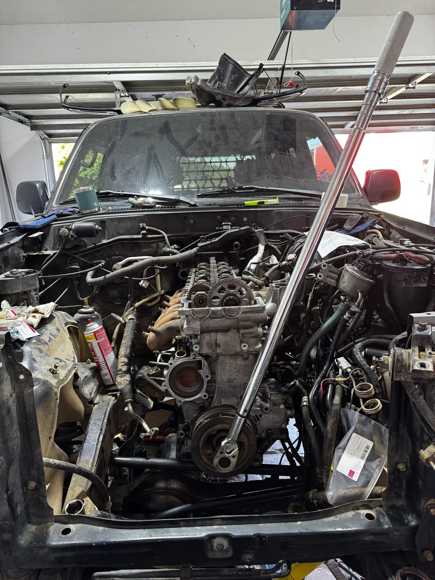

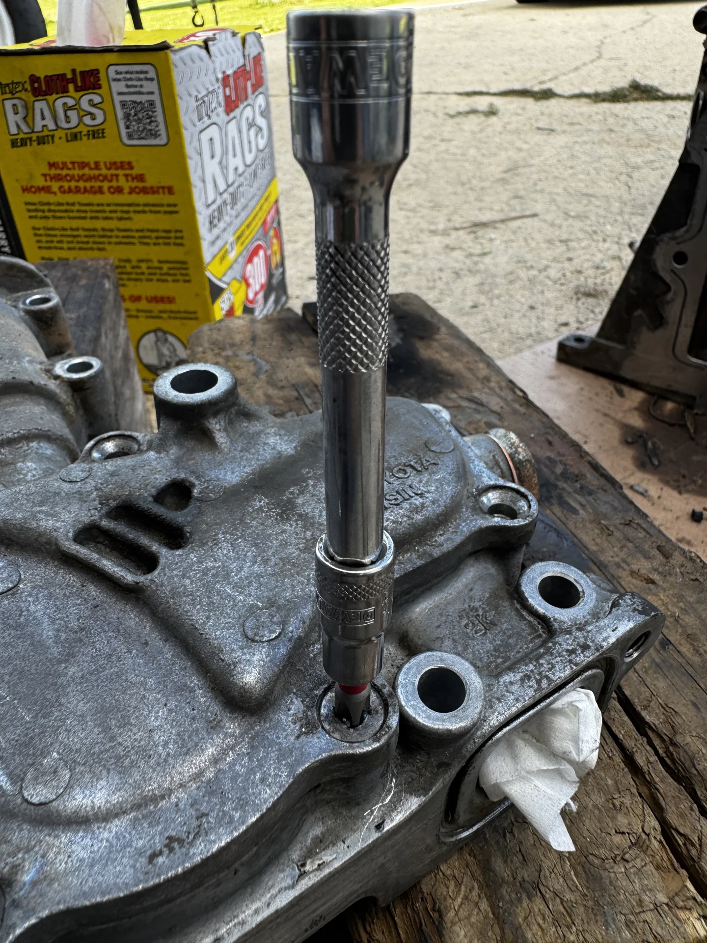

Okay, I have pretty much finished this project and It's about time I finish this thread up. I left y'all at reassembly last so I'll try to start off there. I started cleaning the head with a scotch brite pad and then decided that i didn't like the way those start to deteriorate and leave debris. I switched to a carbide scraper in a careful fashion, and then i was put onto these things by an engine builder that i work with (he actually suggested the 3M version but I don't have that $$). Anyway all of these methods got the head to an acceptable level of cleanliness by my standards. I repaired the wiring harness and tapped it up. Extracting the screws in the oil pump cover was a nightmare, i had to heat them up and tap on the ratchet driver while torquing them on every one. I ended up only stripping one of them. I found where a previous mechanic had twisted the head off one screw (no clue how they managed that without stripping the screw head), so i had to extract that with a punch and hammer.
I bought a OSK timing chain kit and got that done while the motor was torn this far down. After that I bolted up the cover and had a buddy help me get the oil pans mated back to the motor. This is difficult in frame, and could not have done it without an extra set of hands.
Next i cut some block off plates from a piece of 3/16" x 2" aluminum flat bar for an egr delete, and I also added a resistor for the egr sensor. There was a gross amount of build up inside the manifold. The truck was burning a quart a week of 15w-40 and the egr gave it the privilege of burning it twice. No more of that though.
I took a cutting disk to the old head bolts and chased the bolt threads, then had a buddy help me set the head. These are the ARP studs I went with. I used all toyota gaskets on this project. Only non-toyota parts used were the studs, timing chain kit, and heater/coolant hoses.
