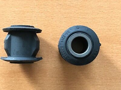

Those are not the correct ones, these are. I got these from re-builders. One set from here in Denver the other a seller on ebay out of CA.

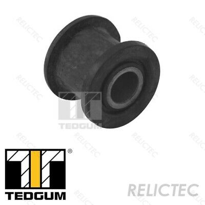

@2001LC do you have a link where you purchased these bushings? I just called CVJ and they are no longer selling just the bushings. They recommended Ployurethane, but I'd like to stick to the rubber if I can source them. Checked ebay but didn't see them either. Appreciate any help.
Edit: I should have specified year. '99 LX470. I also should have searched eBay a little harder...found rubber ones in the link below from Lithuania. Looks like the proper shape, but quality is likely questionable.
Let me know how those look?
I'd like stiffer rubber, than those from re-builders!
Here's the ebay add Guy's a re-builder out of CA
