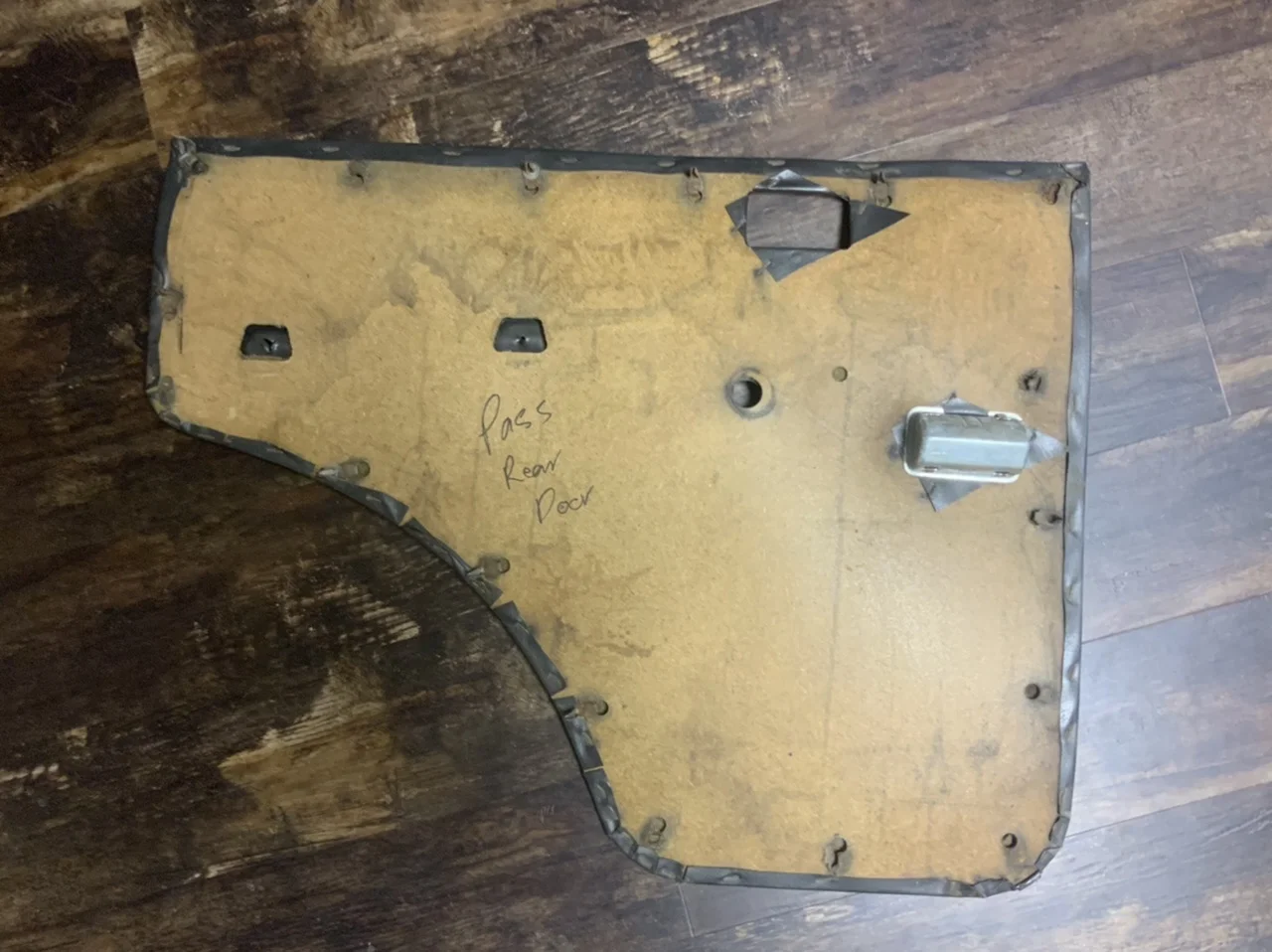

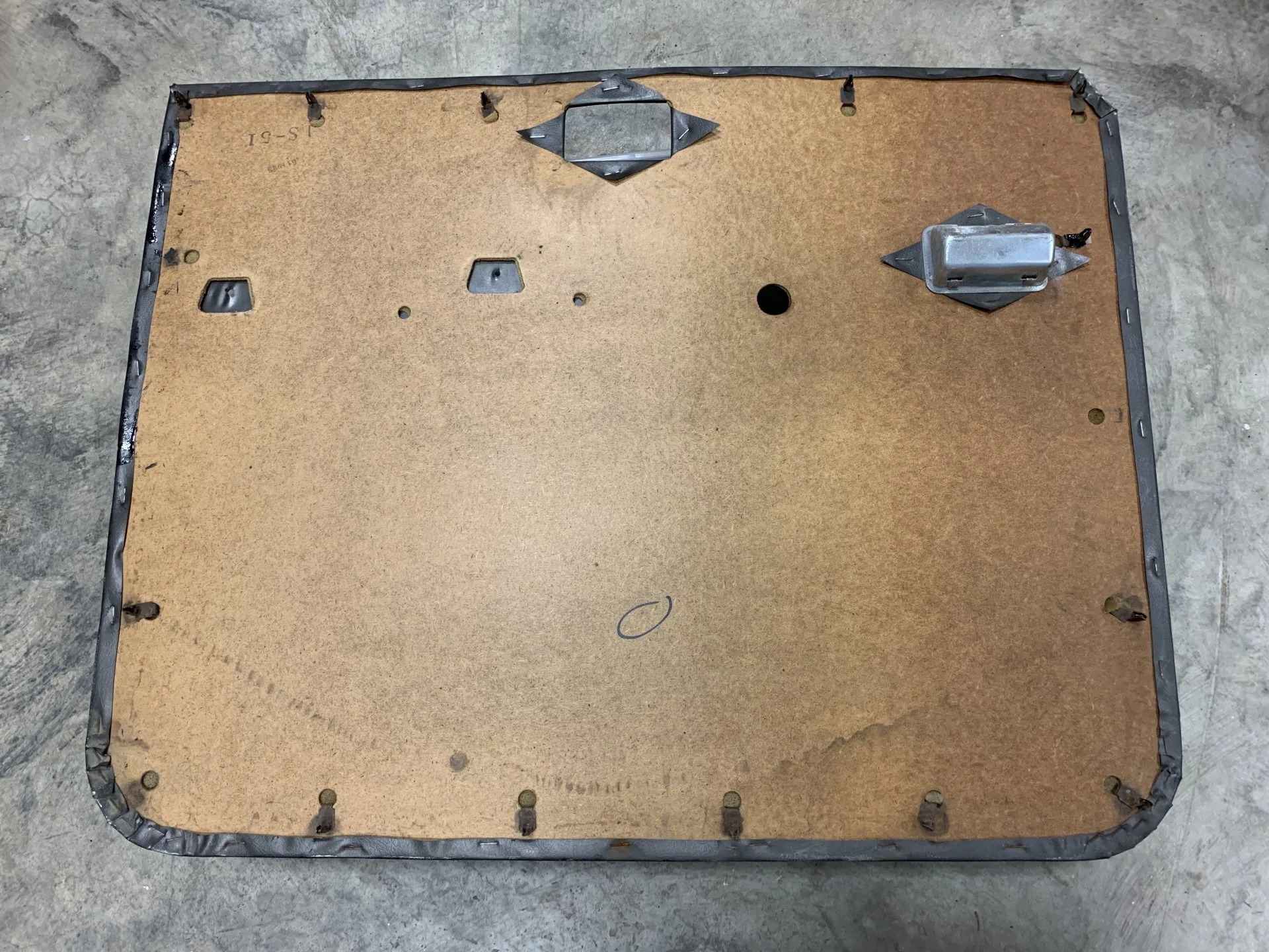

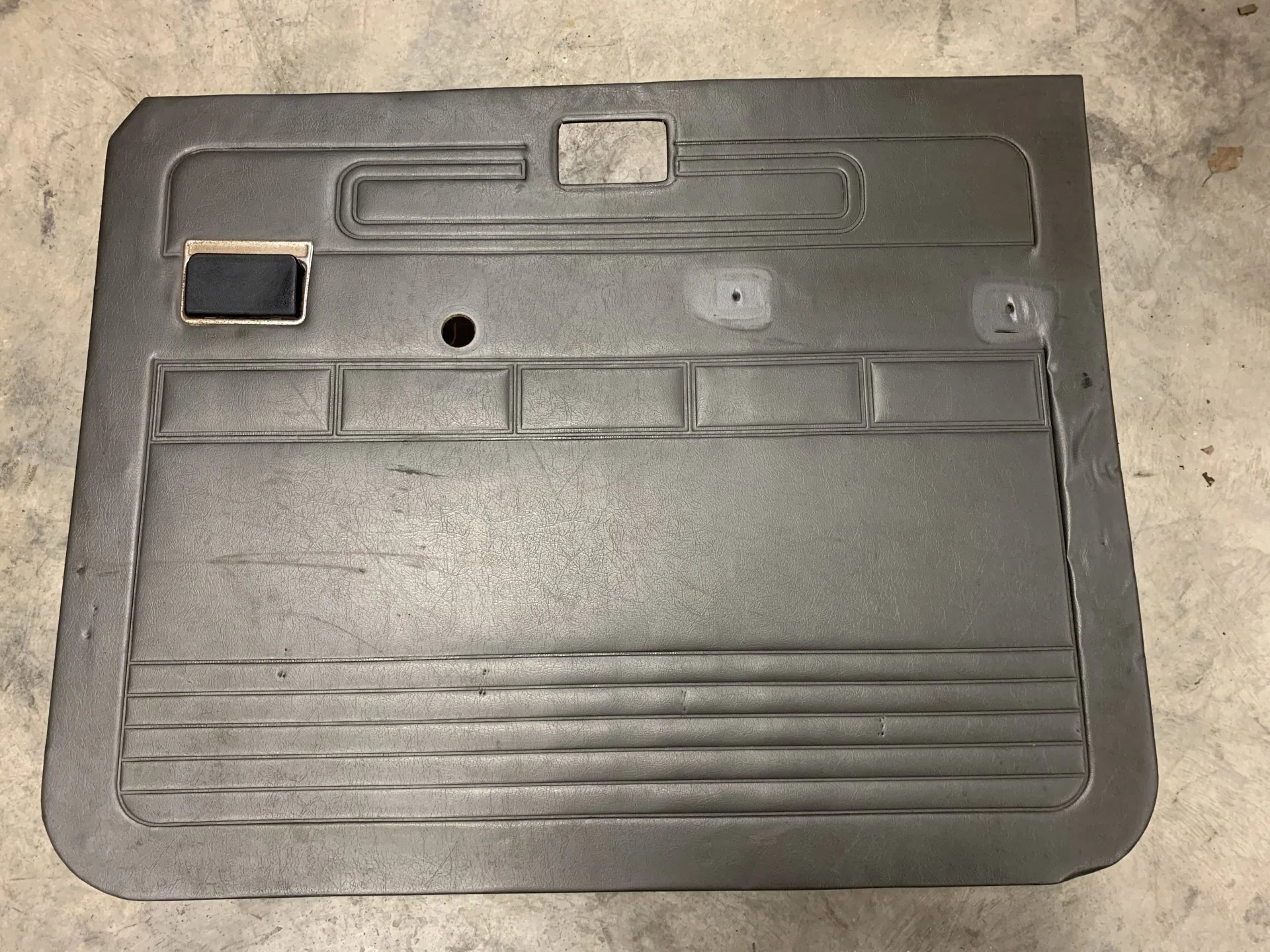

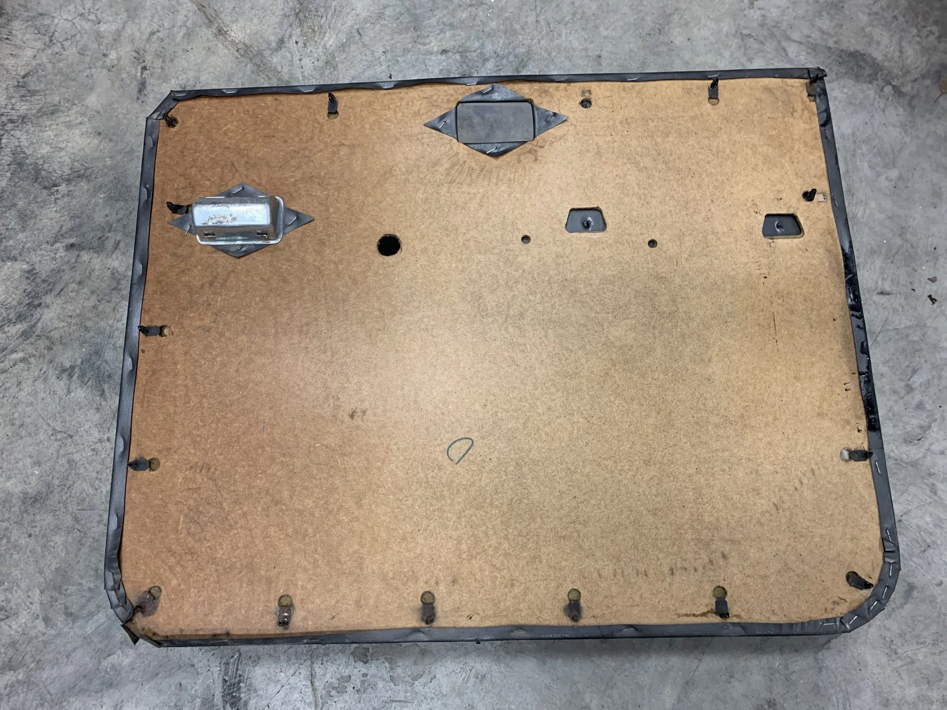

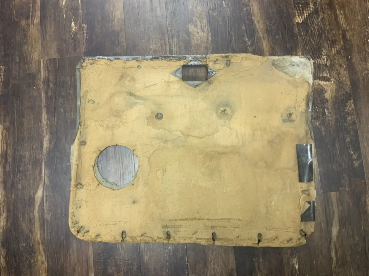

After further review of a photo of the backside of the OE front door panels, I previously stated I was missing a retainer hole.
This would have been on the top edge
My template shows 5 retainer holes on the top edge.
The OE photo shows 5 retainer holes along the top edge.
What made me convinced that I was missing a retainer hole, the rear door panels have 6 holes along the top edge.
With this new found info I feel better about my templates. However, I still would like to borrow/buy an OE front and rear door panel (1 each) so I can tweak the retainer holes for an easier install.

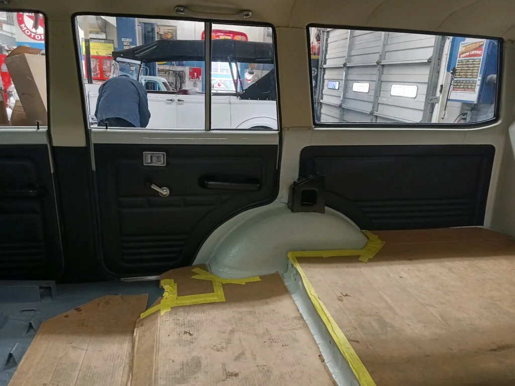

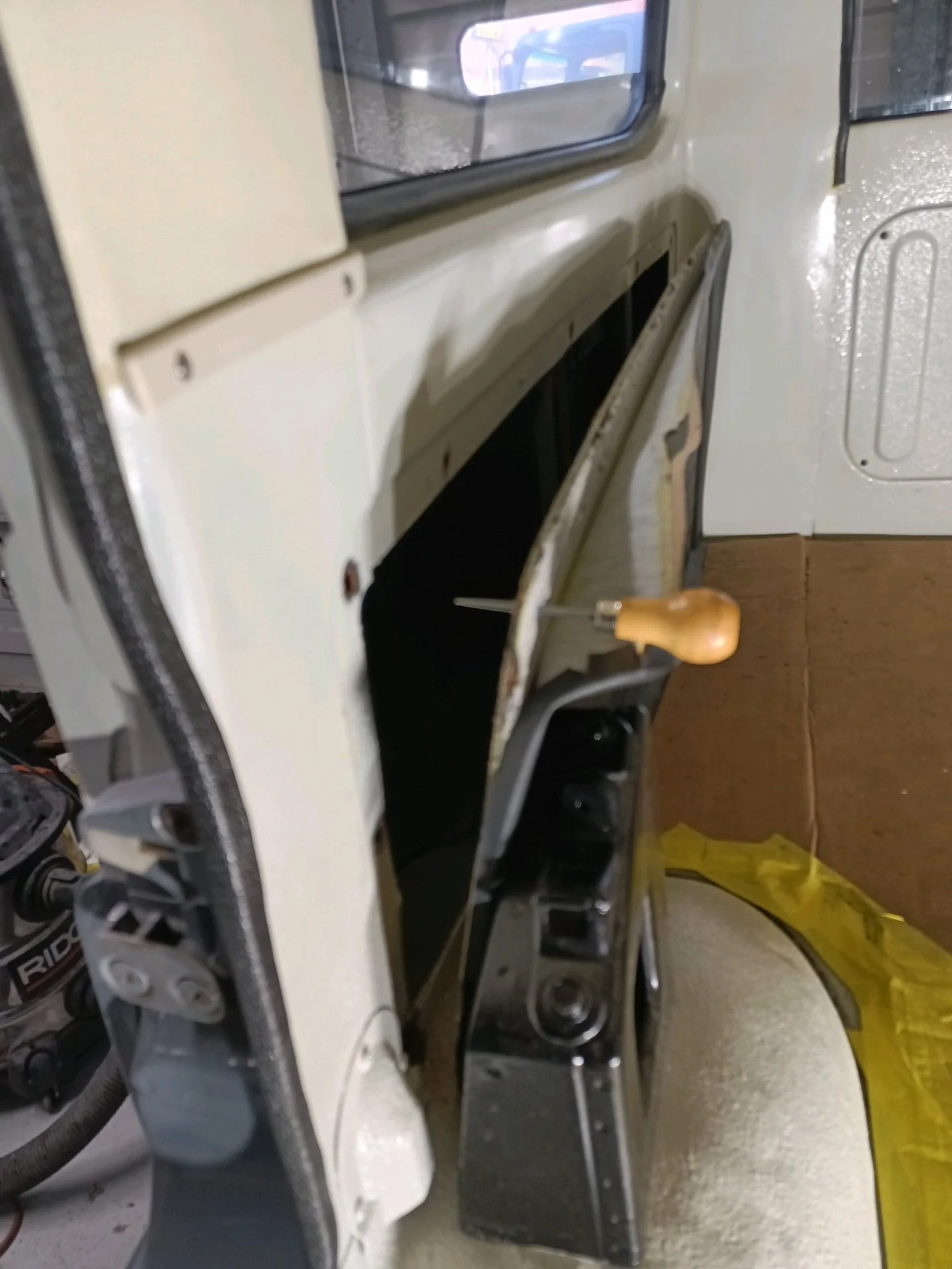

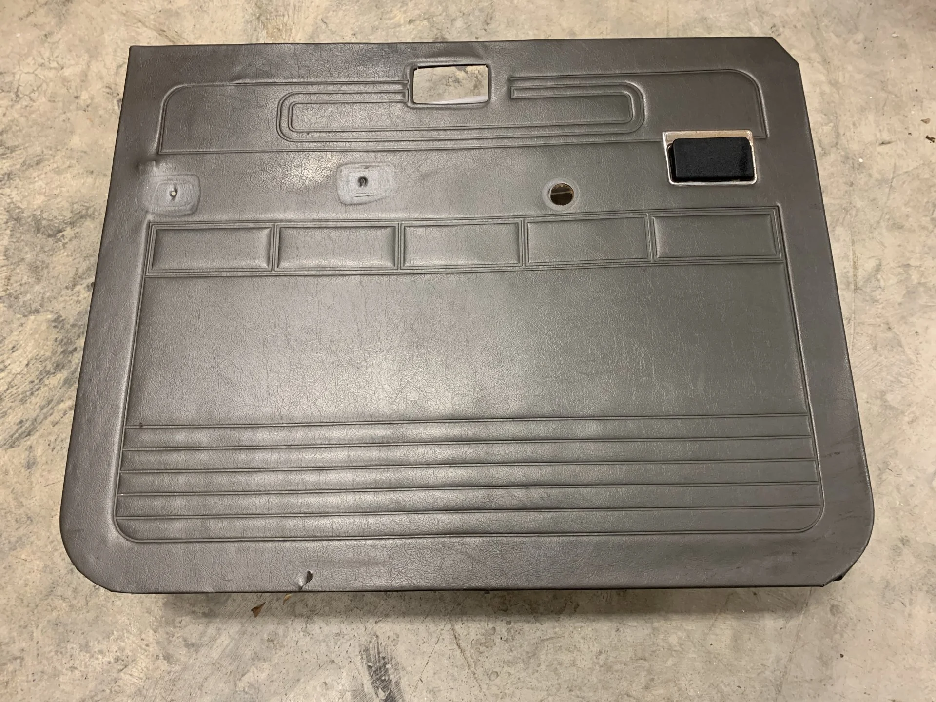

Steve - that was me and my 1969 pig. It was only a few holes that were not aligned. Not a big deal, pulled the vinyl down a bit, drilled a correct hole, then re-glued the vinyl. The panels look great!! I have the panels that came off my truck if you want them. For what it is worth, I had to drill two holes in the tailgate rubber I got from SLOCruisers. The rubber that is held on by the two steel pieces. Very weird how those holes weren’t aligned.
See below for where I had to make some new holes for the rear cargo panel.
DTC72 thanks for the info.
When I first started making these panels the cargo panels were a nightmare. Prior to 75 the retainer holes were the same on the cargo panels. From 75 to newer models they changed to a different pattern.
67-69 could have had a slightly different pattern for the door panels. I have made several sets for 69 models along with yours and did not receive notifications of fitment issues.
It should not be a challenge to mount the panels.

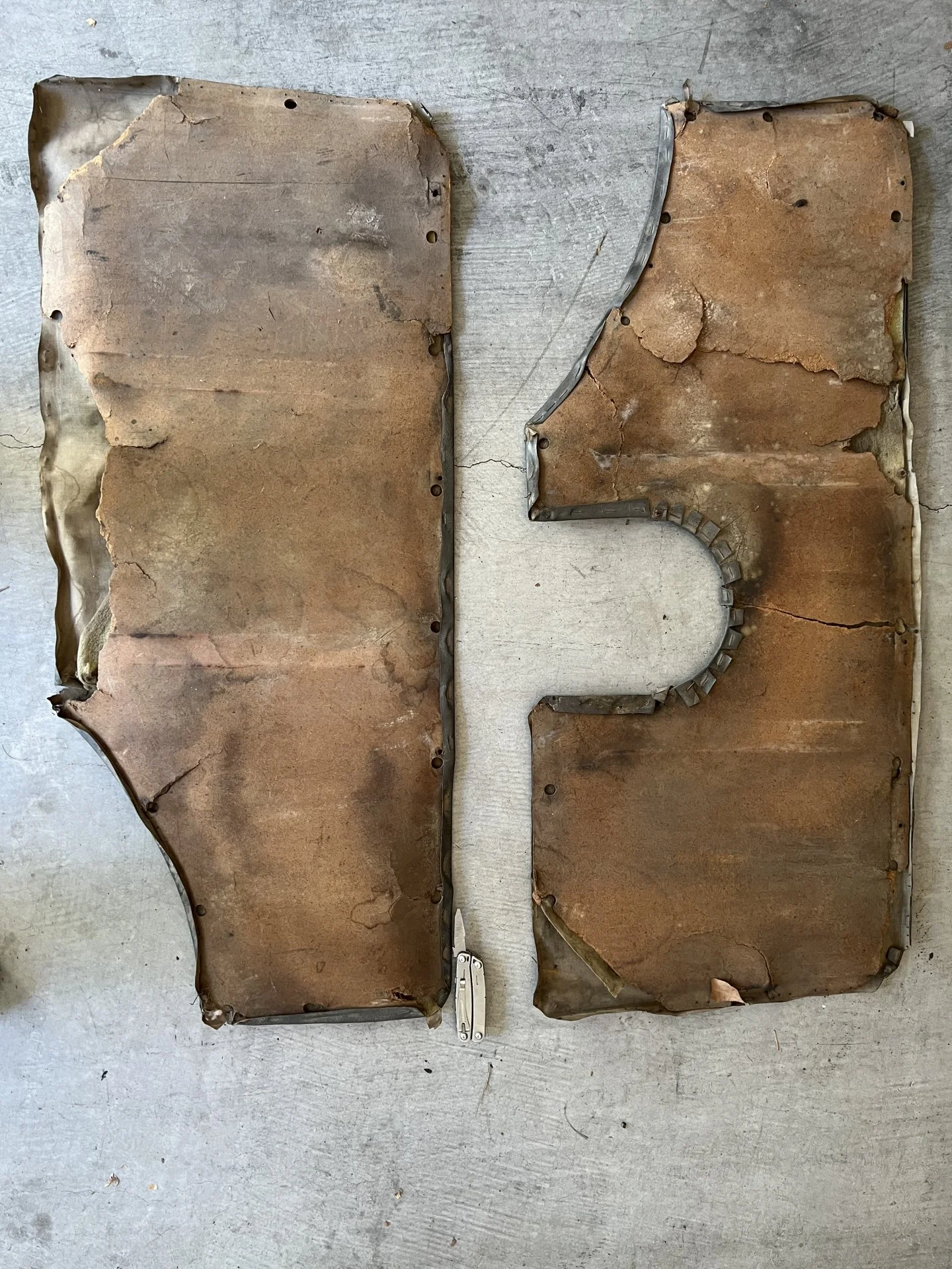

Here are my rear cargo panels from my 1969 pig. As you can see they are in bad shape. It looks like in some previous decade(s) a PO tried to recover with plain flat vinyl? I would assume they are original backing board but who knows. I forgot my tape measure when I went over to my storage garage so I laid down the Leatherman ruler if that helps. Final note: when I bought my pig they were not installed and were thrown in the back with a bunch of other parts.
Back side
