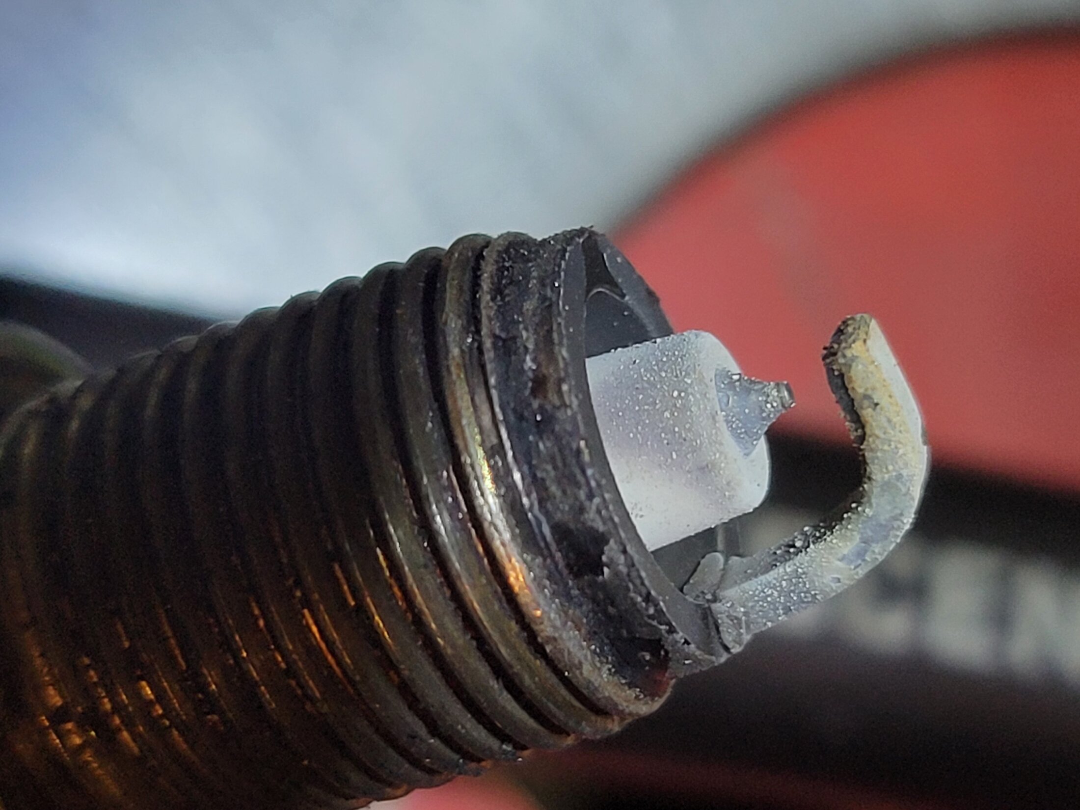

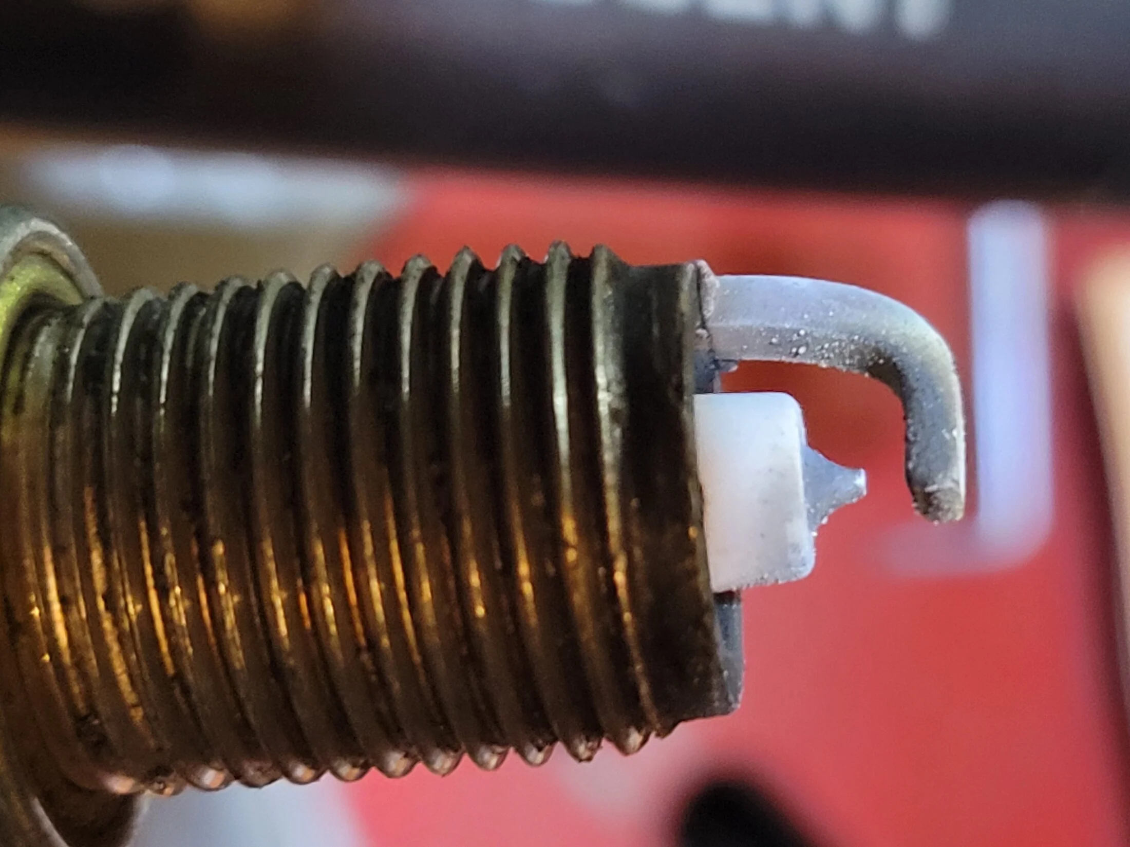

Hi folks, wanted to follow-up this post to see if anybody had any good ideas. Just so happens the alternator went out a couple of days after my original post. On the tester at O'Reilly's it was charging the battery at 12v, and it's my daily so I went ahead and purchased the Optima 100 amp (it was in stock). Will probably keep this original ad get it rebuilt at some point. Figured I'd go ahead and do the sparkplugs while I was at it as well.
Pro tip: At all costs try to avoid pulling off the coil pack boot in the cylinder. I was on the last cylinder at like 11pm last night when it happened. Holy bejesus I would not wish that on anybody. Took me about 4 hours of pulling that thing out bit my bit with longnose pliers and a pick tool I had. Some seem to be very sticky, and it seemed to help if I just kept constant pressure and twisted slowly as it was coming out.
Drove it around today, and it runs really good, much better than before. Only thing is there is still some hesitation, but only under load while warming up. Like while accelerating, just after it shifts gears and the rpm's drop, this is when it happens. Kind of hesitates or chugs. It did it a few times while warming up, then went away. Not sure, but maybe it is one of the coil packs.
I'm not super familiar with the capabilities of testing devices. Is there some place I can take it see which one of the cylinders is misfiring? (I'm assuming this is a misfire since the spark plugs helped, but maybe that is not right). The testers at Napa or O'Reilly's don't do this. Do most shops have this capability? Any thoughts?

I can't say this is your problem for certain, but if you use aftermarket parts, your truck will not perform the way it did from the factory. It just won't and don't let anyone try to tell you differently. This isn't a C10 pickup truck. Having said that, I'd tend to believe even a crappy parts store coil pack would last a year, but maybe not. I know they don't perform as well as the OEM parts, even when they're new.
Many online parts suppliers will sell you OEM parts at discounted prices; PartSouq and Amayama are two. There are dealerships in the states, Olathe in KS and Ourisman in VA for example, that sell at discounted prices too, but they're more expensive than the non-Toyota affiliated parts resellers are. Lexus parts has links to Lexus dealerships that sell online and also sell at discounted prices.
Your absolute best bet is to find a human parts retailer and work with him to have your needs met. This requires more work on your part, but in the end, you'll save money and know your truck more intimately.
If you really want this truck to last, stop using aftermarket parts and find a reputable Land Cruiser shop to work on it. Or, start buying tools and do the work yourself. Most of it really isn't that hard.
Lastly, and this is trivial, but those plugs look like they have a huge gap.
