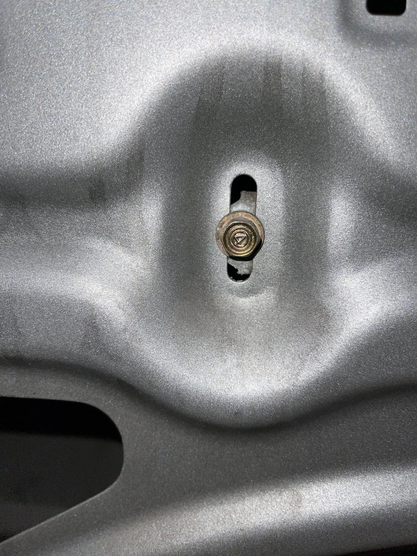

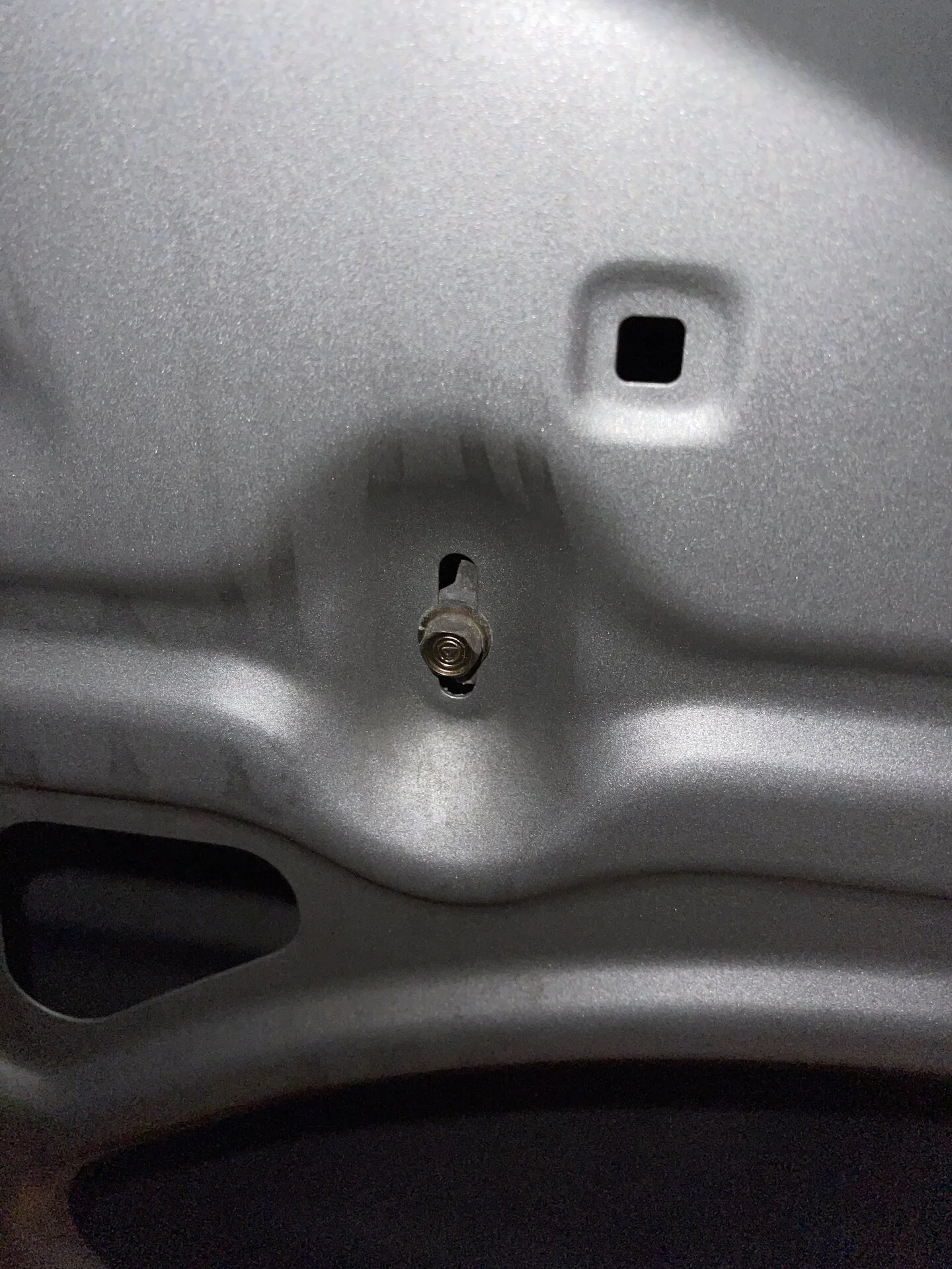

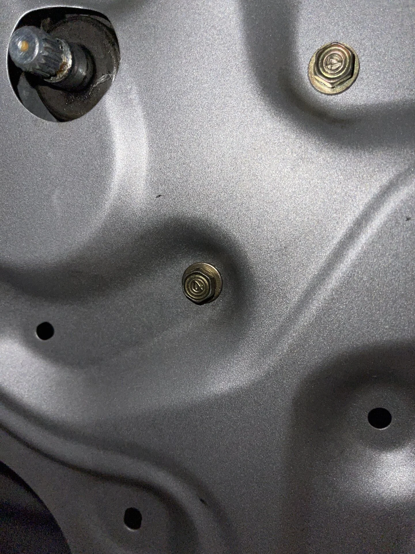

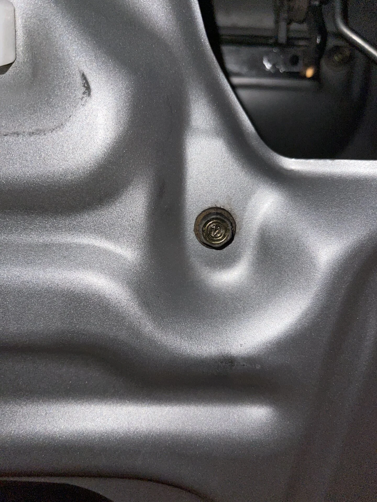

I had to tear my passenger door apart to get my key code and I figured I'd clean up the inside of the door while I'm there. The bolts there (pic attached) that secure the window regulator are corroded/rusted and I'm looking for a replacement. The more similar to OEM the better. Any ideas?
Thanks.
Metric M6 bolt, 12mm long, 1.25thread.. 10mm head on it.
The little bolts that hold the swivel hub seals on at the back would be a match (pn 91651-40612).. but any hardware store that has a good collection of metric bolts would have something close (probably not as short, and it'll probably have an 11mm head on it, but you'll never see it again after its installed).
