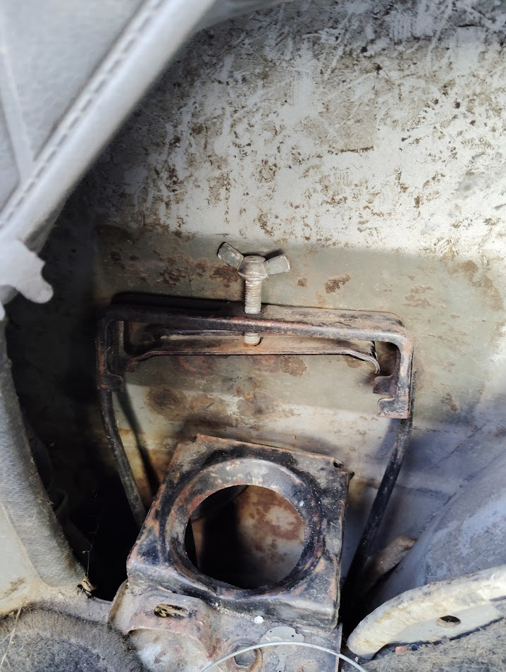

Hello,
Your jack holder may be either misplaced or missing.
The jack should go horizontally on its holder. Yours appears to be vertically stored.
Check your holder.
Juan

This is what it looks like, sans jack. Sure that it goes horizontally? Can't see any obvious way that it would. The bracket with the winged bolt is fixed in place.

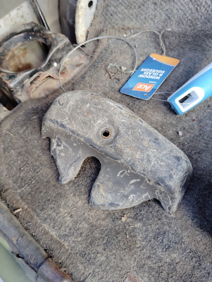

And this is the singular bit of plastic that was stored in there. Need to go through Partsouq and try work out where it lives, but open to suggestions!
Hello,
Your jack holder is not from a 70 Series truck.
Regarding the bit of plastic, it looks like it broke off from something some time ago.
And yes, the jack goes horizontally.
I think the holder's part number is 58709-60010.
Juan
Hello,
This fella with a BJ73 has the identical upside down jack holder. Maybe a Japanese thing?
Hello,
Quite likely it is.
Chances are it is inspired by late model 40 Series, which had a bracket to hold the jack vertically.
There is a picture on that thread that shows the way the jack is placed.
Juan
