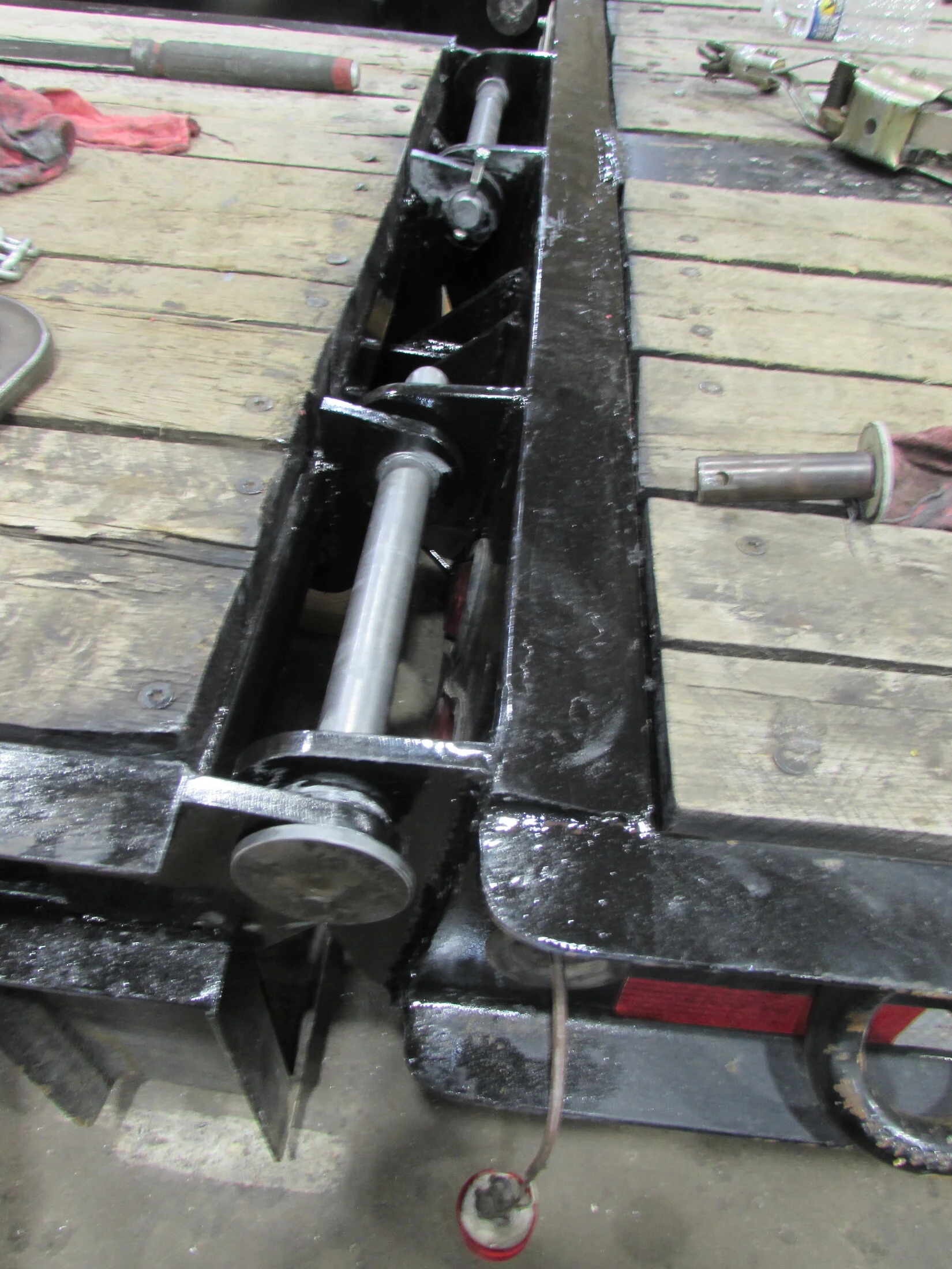

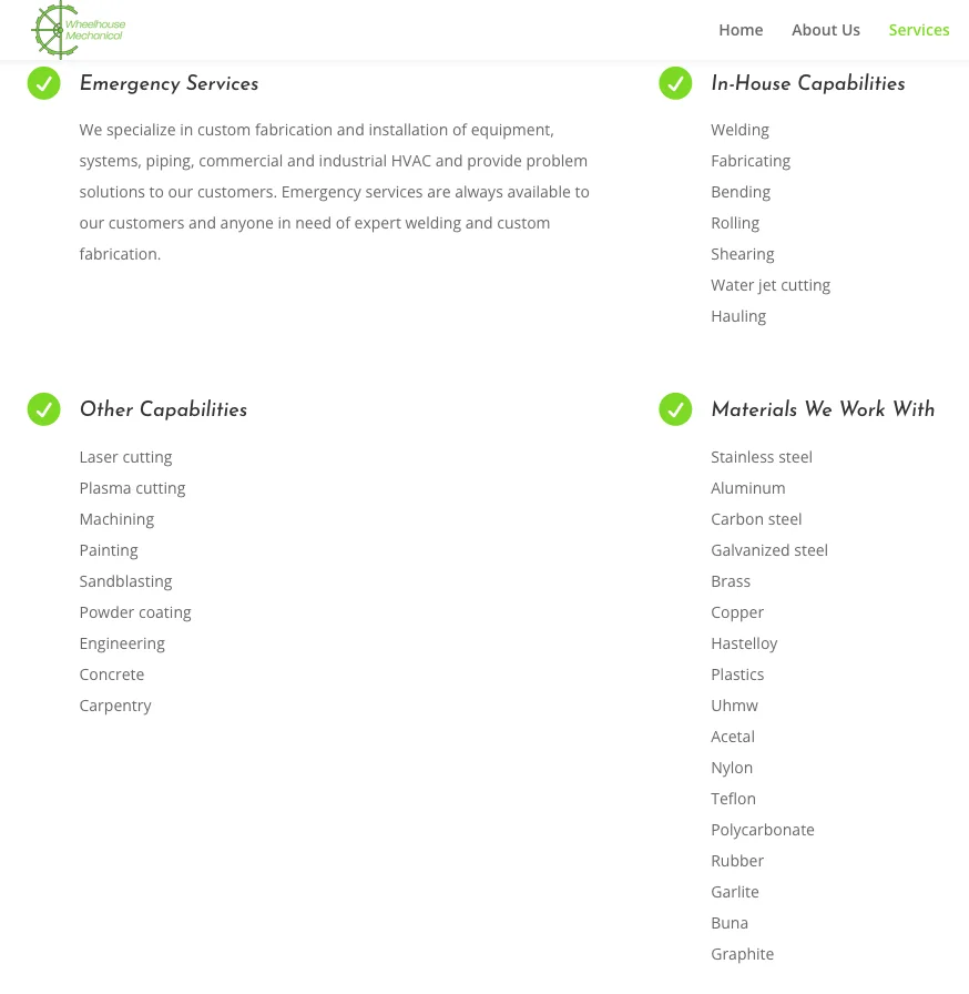

I'm going to follow up on this thread for local resources and give a shout-out. Brian is now at Wheelhouse Mechanical. We had some cutting needs that were beyond the precision we were capable of with our plasma table - some 1/2" thick brackets for fixing a heavy duty trailer. The original design was just a 1" rod through 1/2" brackets on either side of the two ramps. About twice a year the trailer came into the shop for repairs as the rod would get bent and bind up and the holes in the brackets were getting more and more wallowed out.

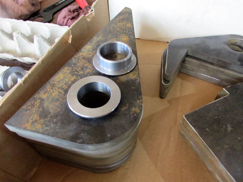

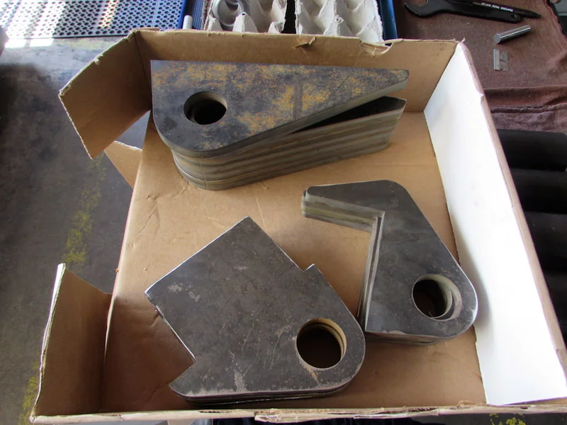

I drew up new brackets allowing for replaceable bushings and sent the files to Brian. We got the brackets back and our in-house CNC machinist got to work on the bushings. We're putting in four brackets on each ramp instead of just the outer two and the replaceable bushings are going to make for a much easier maintenance item than the repairs we've been making.

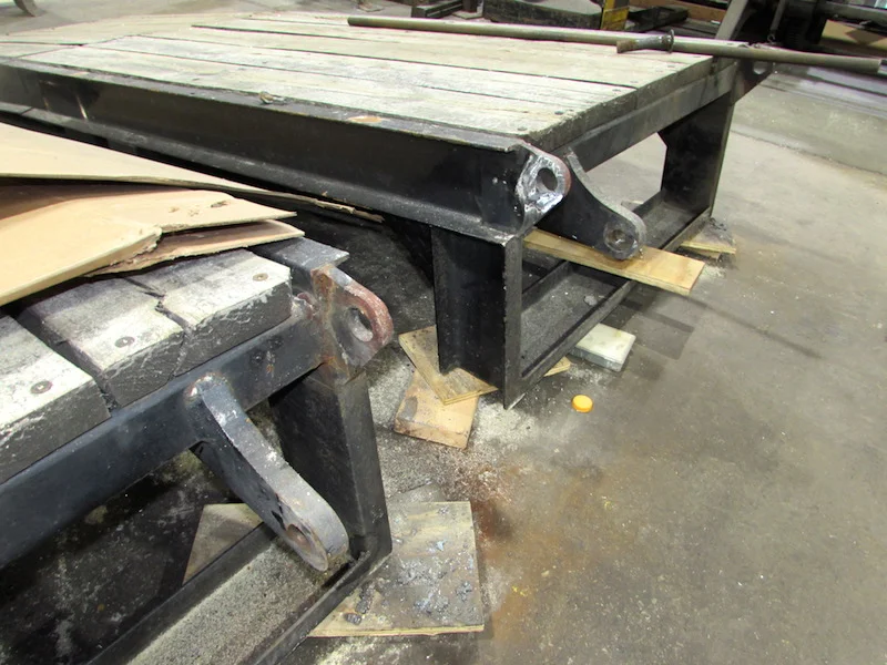

The trailer side (original brackets):
The ramp side (original brackets):
The new brackets - big ones for the trailer side, T-shaped ones for the ends, and L-shaped ones for the inner positions:
And the insertable bushings:
I'd definitely recommend giving Brian a shout if you have cutting or fab needs!

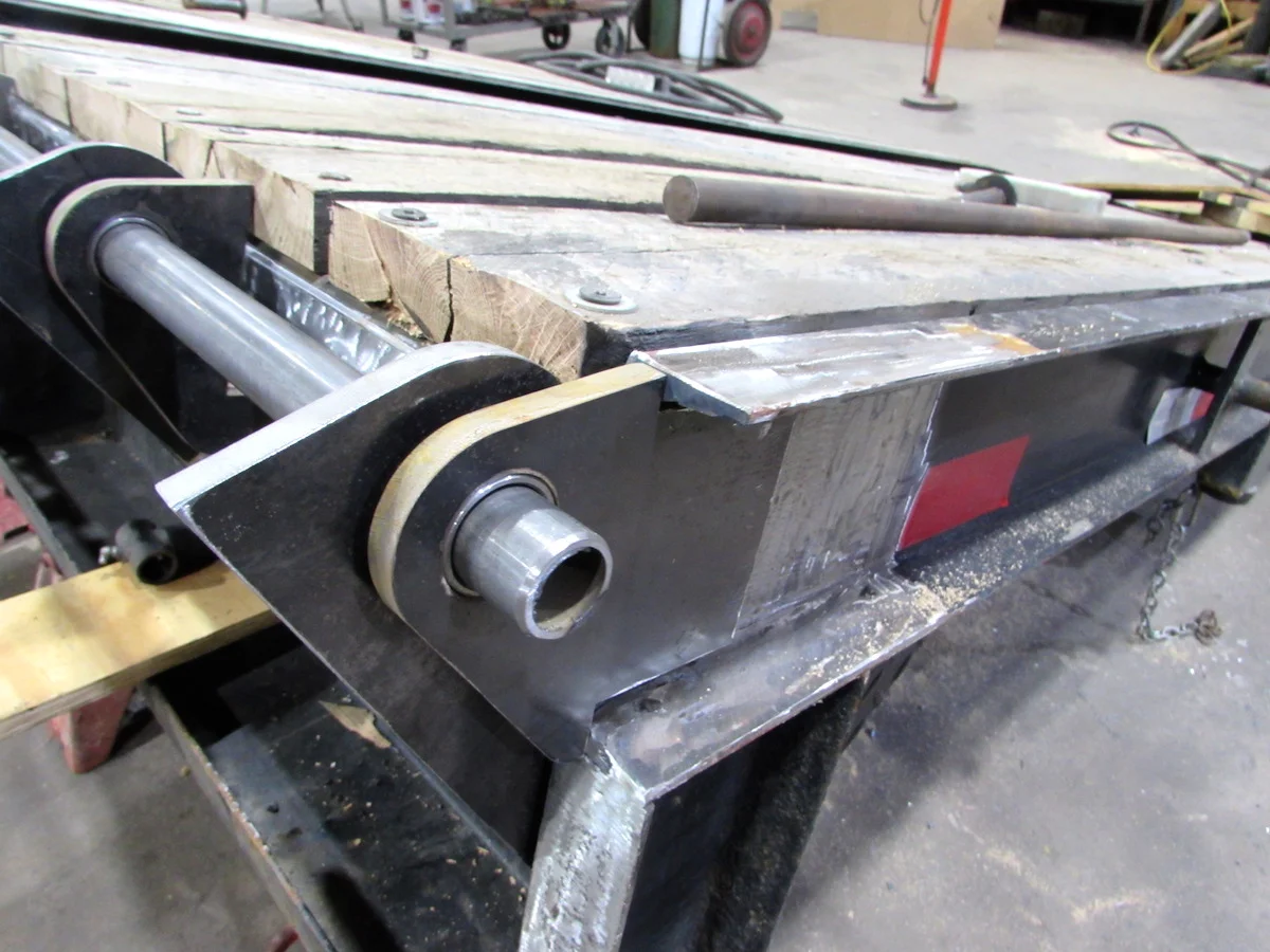

Coming together...
No idea how the OEM thought just the outer supports were enough on this thing.
The trailer is finished up!
That should support the ramps much better and make it much easier to repair when they wear out the bushings. A local paving company owns the trailer and their paver crawling up the ramps just put too much "twist" on the connections. Really for a 49,000# GVWR trailer, the ramp connections were pretty flimsy. I'm curious how much longer this will last before it is in for new bushings. Hopefully they'll get a full season out of it instead of having to bring it in midway through a season and anxiously await repairs so that they could get back to work.
