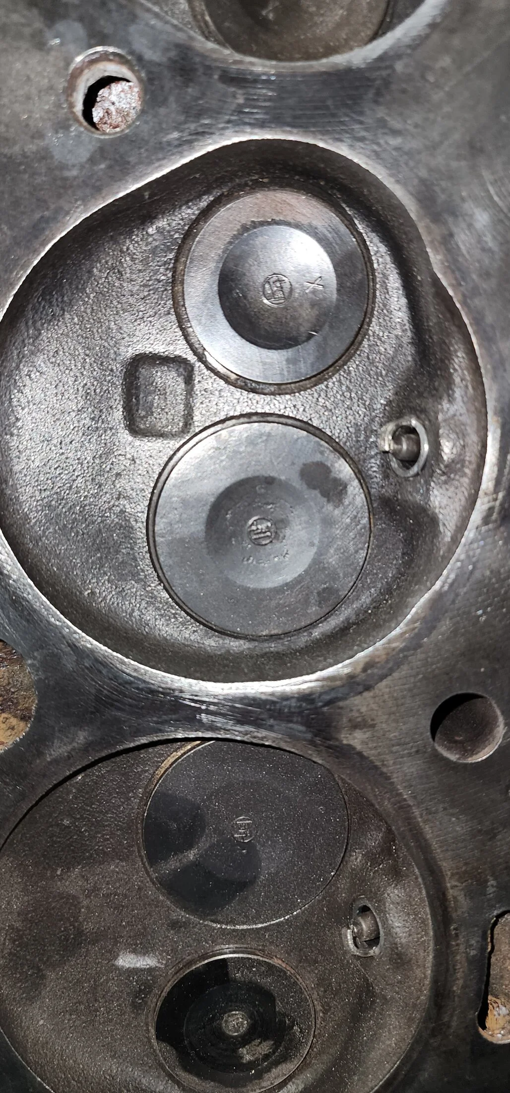

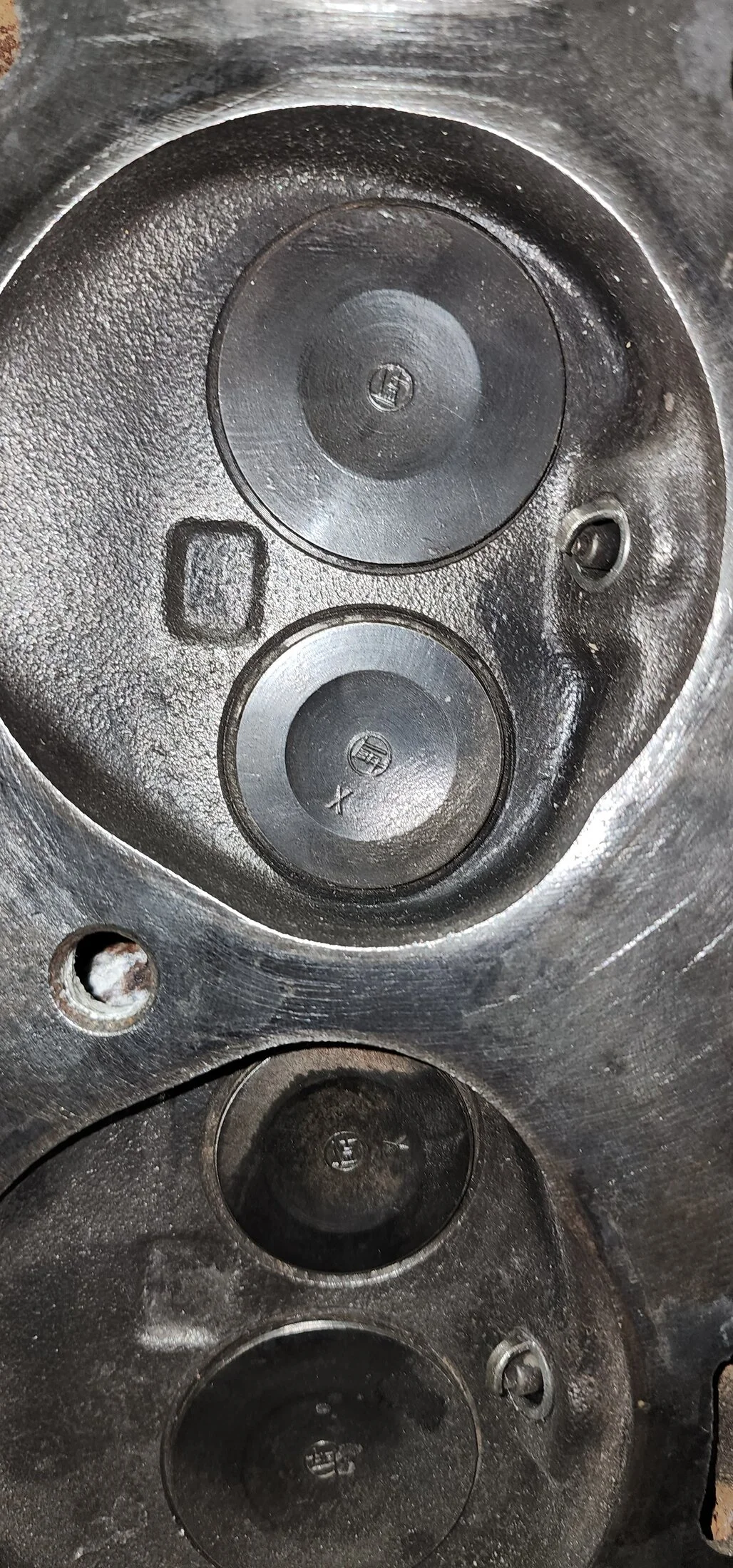

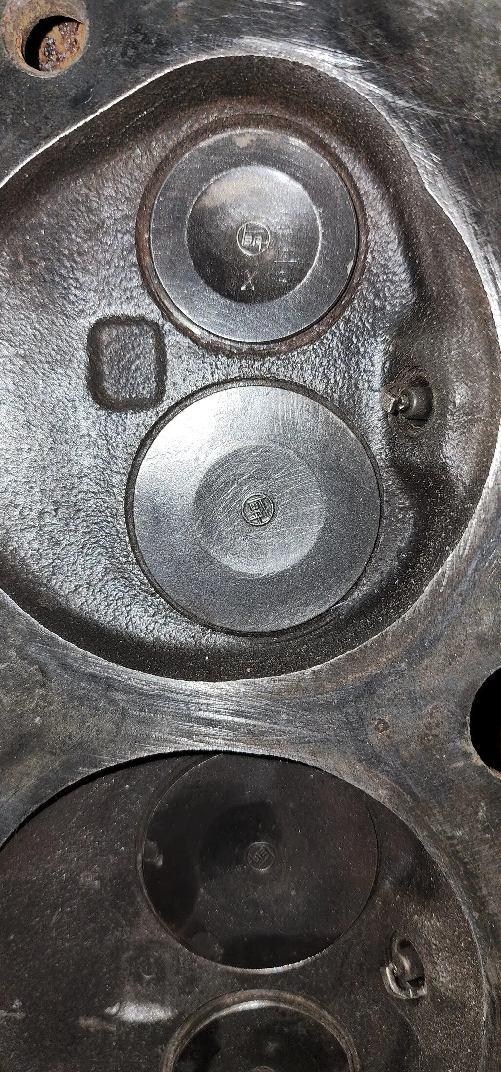

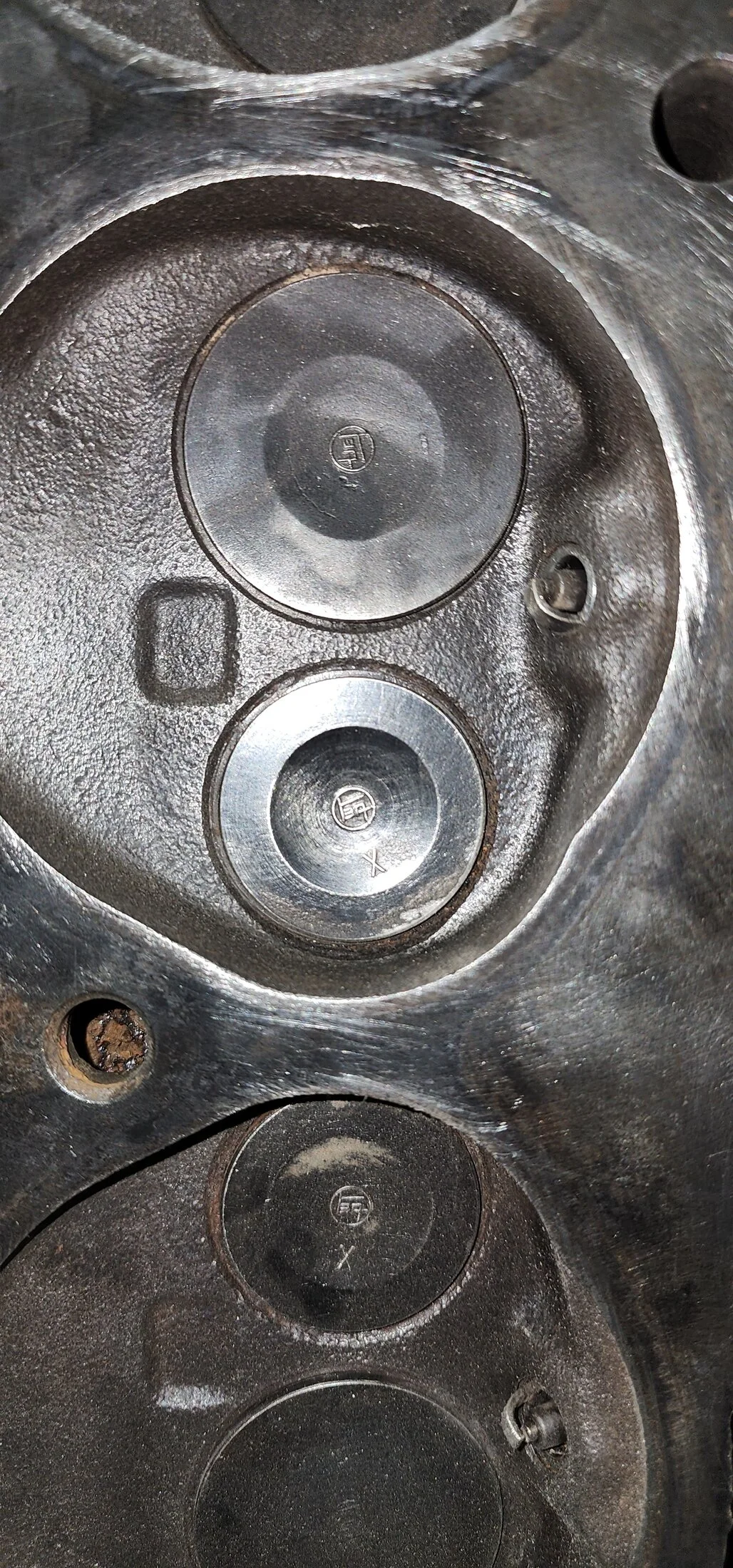

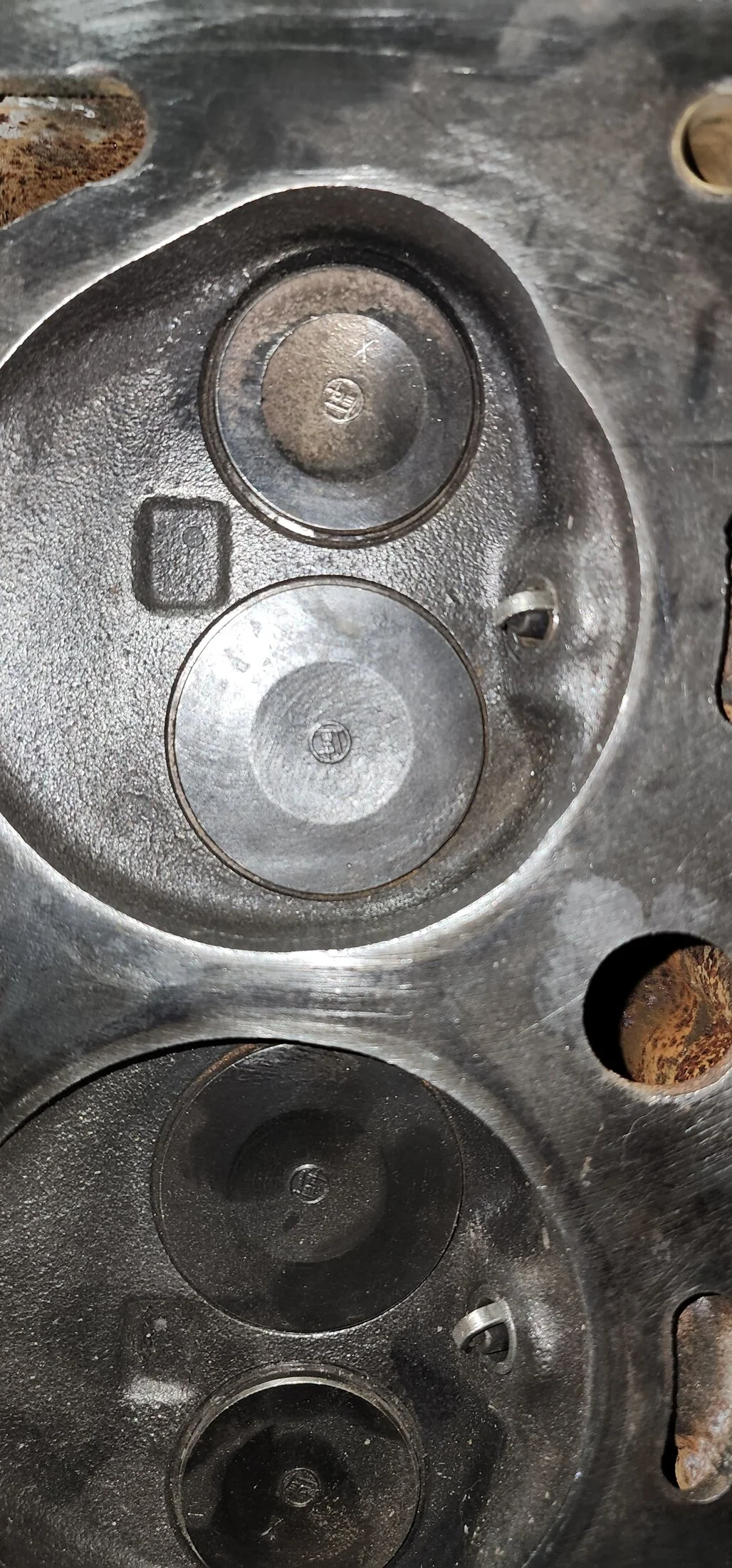

Here are pics of my valves. I'm not too familiar with what to look for. So, if you have experience with this stuff please chime in and tell me what you think of them. Good to go? Replace?
My goal is "just fine I'd run em"
Thanks, valve people!
Last one...

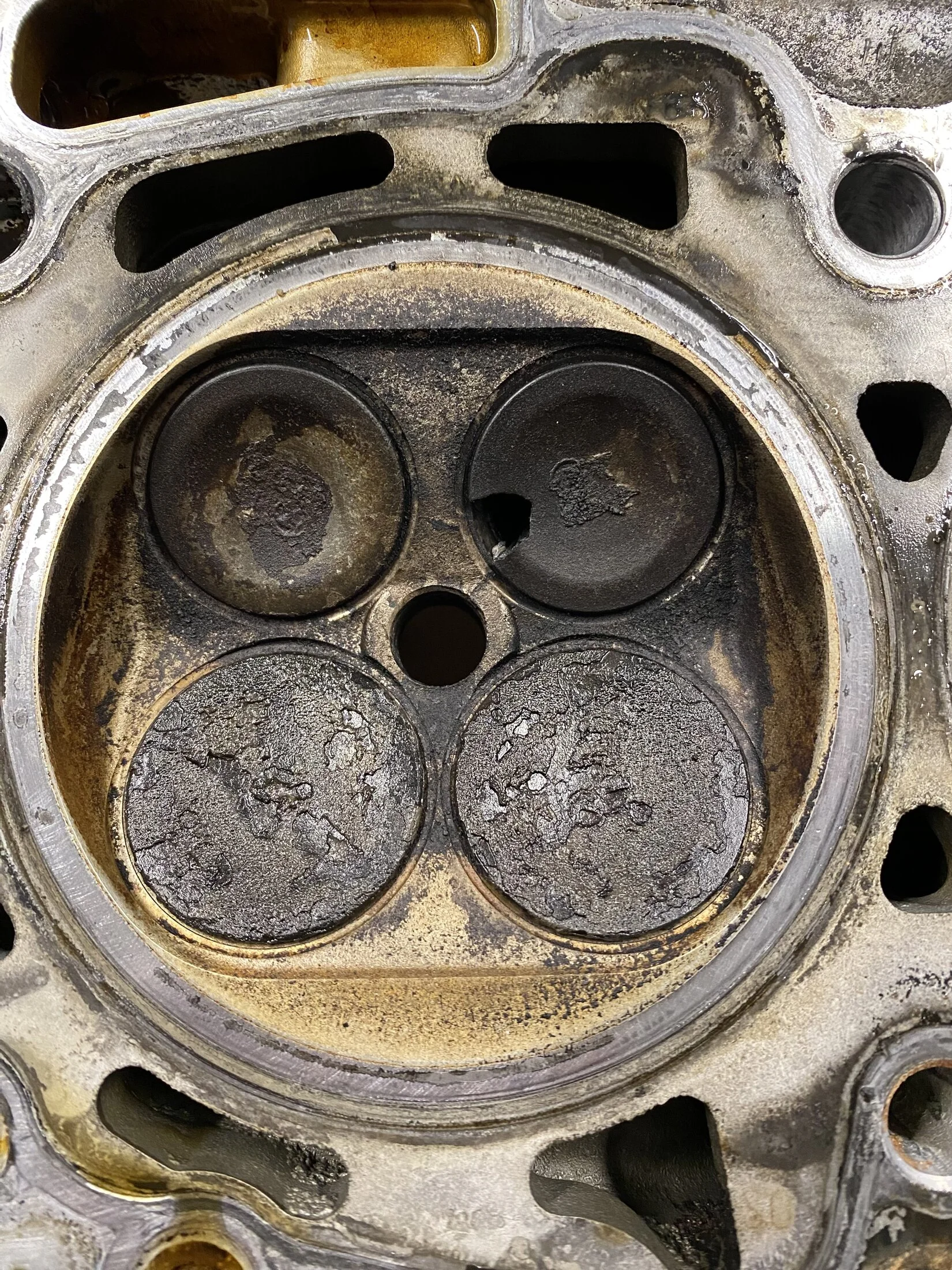

The valves look ok - there could be some spots of concern - hard to tell by pic's. Your plugs look fowled, could be oil burning due to worn rings, clogged air filter, to light a oil, bad carb/mixture, weak spark - coil, points, condenser or plug wires.
Want a good test of the valve seats - without the valve springs fill the combustion chamber with gasoline and see if leaks. Crappy test is water with the springs in. It would have been helpful to have done a dry then wet compression test before pulling the head. A leak down tester would have provided even more information.

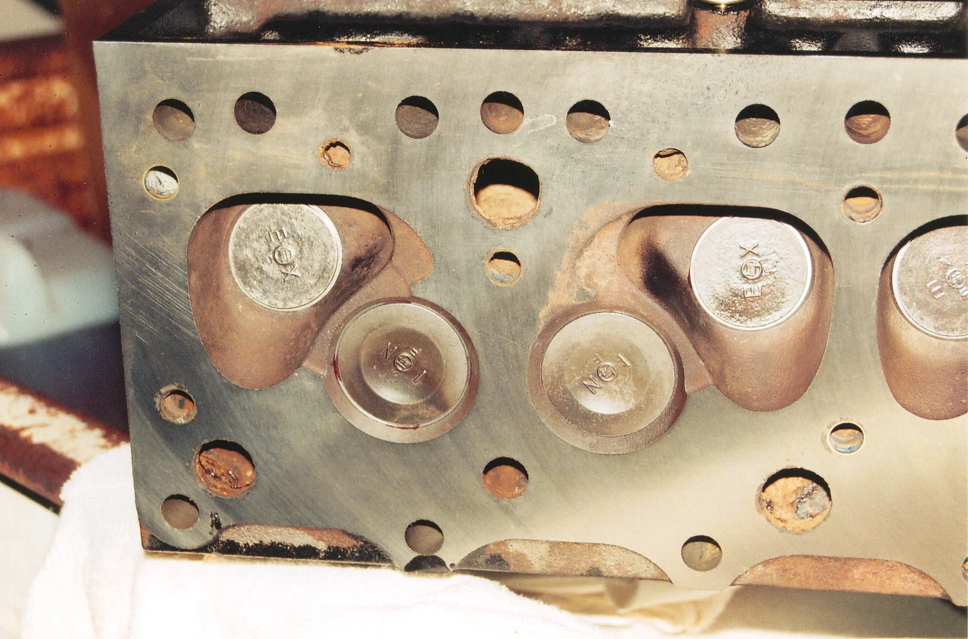

My valves would get erosion on the 45-degree-surface. And some valves had stem-erosion, just at the port-exposed side, short of the valve guide itself. Either way, the other side of the valve deserves cleaning and looking at.
Cylinder #2 looks kinda damaged from your photos.
There's no way to tell from the pics. At this point you can pour acetone in the chambers and see if they leak.
Agree with others, that we need to see the seats to be able to tell much.
Agreed with most of the responses. There’s more to it. Vacuum testing is the best method for finding out if they leak. Any machine shop can do that for you. There’s also the seats, how the valves move within the guides, how much carbon buildup is on the stem side, bend/wear, blah blah… the head is off so you may as well do the full job. Rebuilding a head isn’t difficult.
As I mentioned b4, you postion the head so the deck mating surface is up and pour acetone in each combustion chamber and see if it leaks thru the seats. Folks have used Acetone to find cracks in blocks and manifolds. You can also lap the valves or use Prussian blue to see how the valve seals against the seat.
No expert, but I think the external surface, what we are looking at is pretty insignificant. The critical part is the back side, where it seals with the seat and the stem
I was going to say that exact same thing words and all. every last word verbatim 😜
