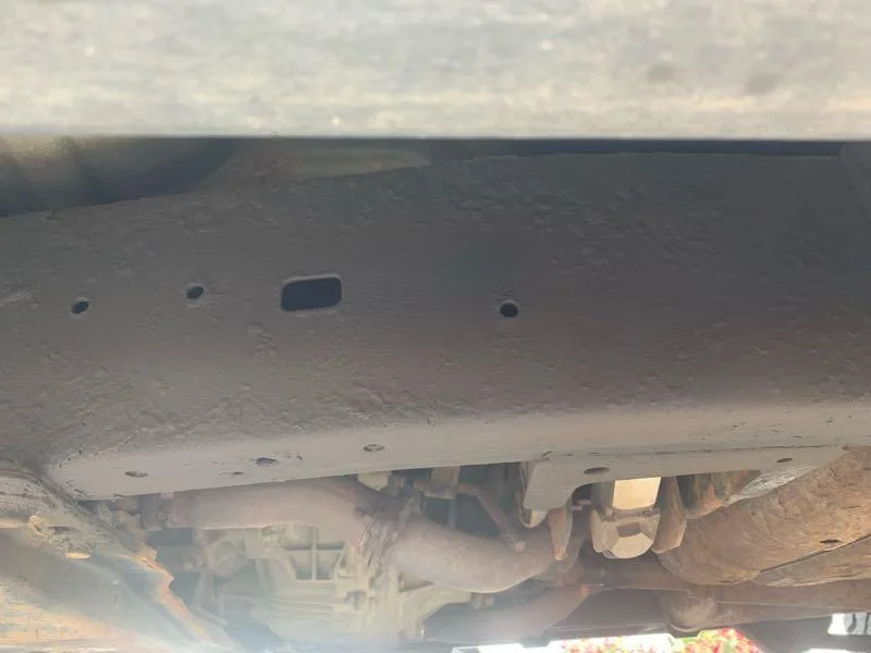

I may end up passing on it. I asked for a few photos, he only sent one with “Here is a photo of the 04 Toyota frame, the gas tank skid plate is rusted the worst
the rest has some surface rust.”
I zoomed in on what looks like severe rot. One could probably kick at a few rusty spots and knock some of that clean off the chassis.
Looks like the frame has been coated too. NO telling what is underneath.
Finally got him to send more photos. Looks rough. Skids will have to be replaced, not a big deal, but his claims of “surface rust” on frame seem to be more severe than stated.

The undercarriage made me sad after the condition of the rest of the vehicle. You are right in that the gas tank skid is the worst, and looks like its about to rot clean through. There is surface rust on the frame and drive shaft components. It's hard to judge the extent of it without taking a wire wheel to it. Places of the frame do appear to have been coated, but based on the lumpy textured surface it's hard to tell what, if any, prep was done prior to coating it.

Thank you for the info. I spoke with Stan at that dealership. He was for the most part upfront. He did not mention the rust near Slee bumper, but when asked, he did send over photos of undercarriage. The muffler looked rotted out, but any shop could replace or upgrade that problem.
