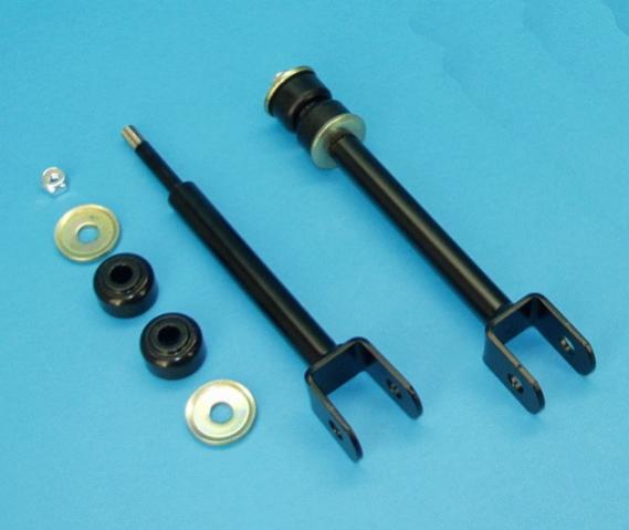

^ $150 is a deal! But I don't see what keeps the ASB in a fixed out of the way position when disconnected?
this is what jeep guys did for years. I never had a problem with my setup.
http://www.4x4xplor.com/homediscos.html
There's no motive force for it to move except gravity and inertia. The rubber grommets at the frame mounting points provide more than enough resistance to keep it in place after you spin the ASB upward out of the way.

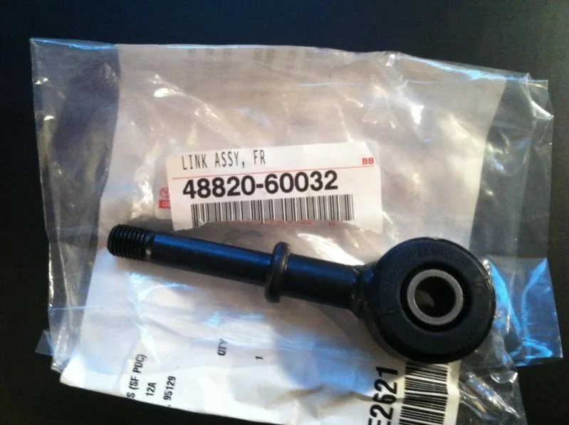

The front and rear links are different so you can't re-use the old rear links up front. Robred had a new pair of front links cut and added 2" to them. The writeup on his site is here:
http://forum.tlcfaq.com/viewtopic.php?f=3&t=287&sid=ab533c87d79dfbd1fb5d2a65b1721278
Maybe he will chime in but after installing he mentions he possibly should've gone with longer ones. My front end is basically maxed out with 2.75" of lift in the front. I have not added extended links up front but I would think 2.75" over stock would make sense to match the lift on mine.
I ordered my rear links from Man-A-Fre - tried Extreme Landcruiser but they didn't have any in stock and took to long to get back with me. Even though the Man-A-Fre site has said under construction for some time now I placed a online order and my parts shipped quickly and arrived in a few days.
Why would the rears not work up front? They fit fine (aside from skid plate interference and add an extra couple inches to the sway bar link Am I missing something ?

2 totally different links. One is U ended (rear) and one is O ended (front)
Front and Rear links.....
