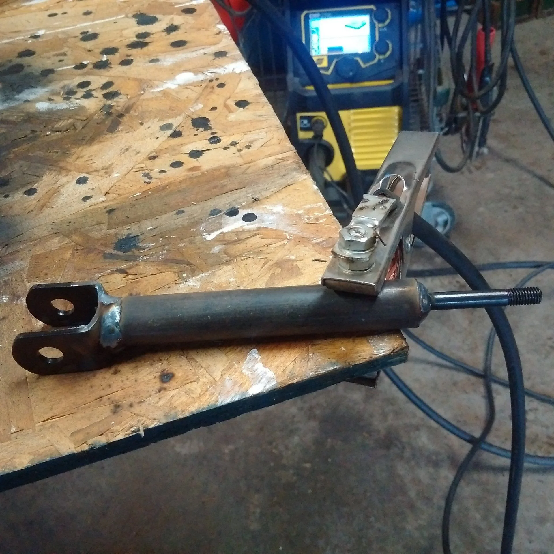

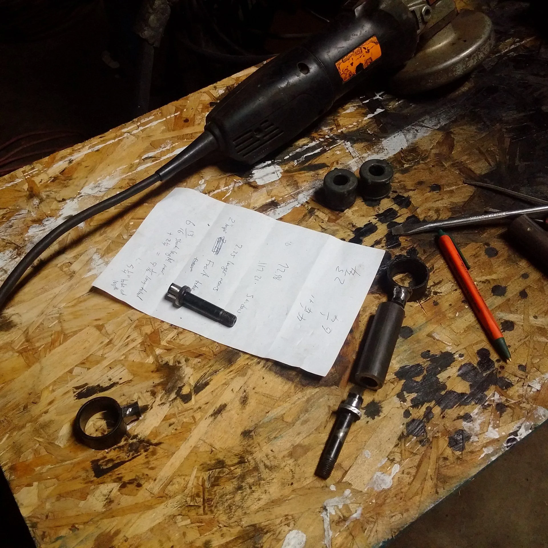

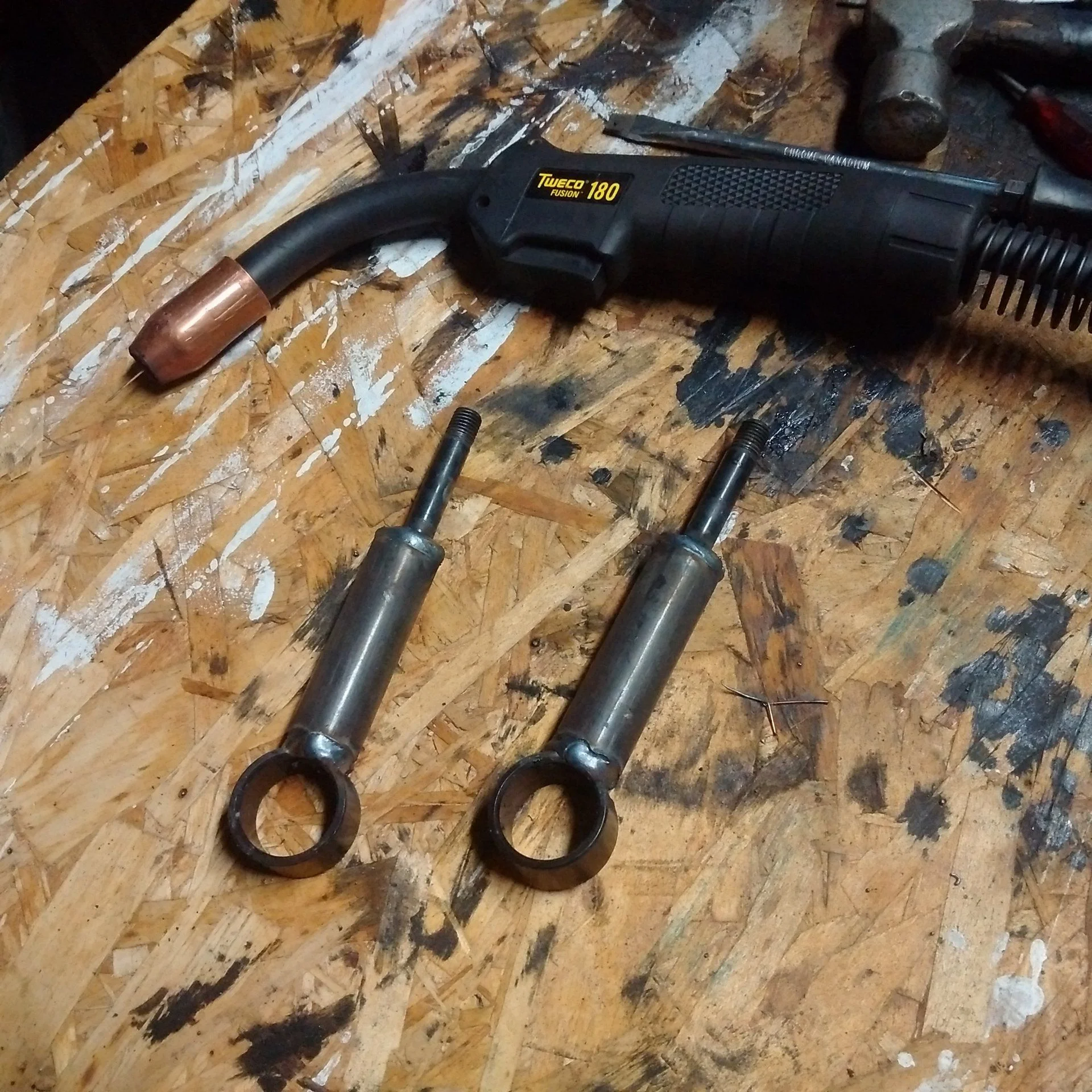

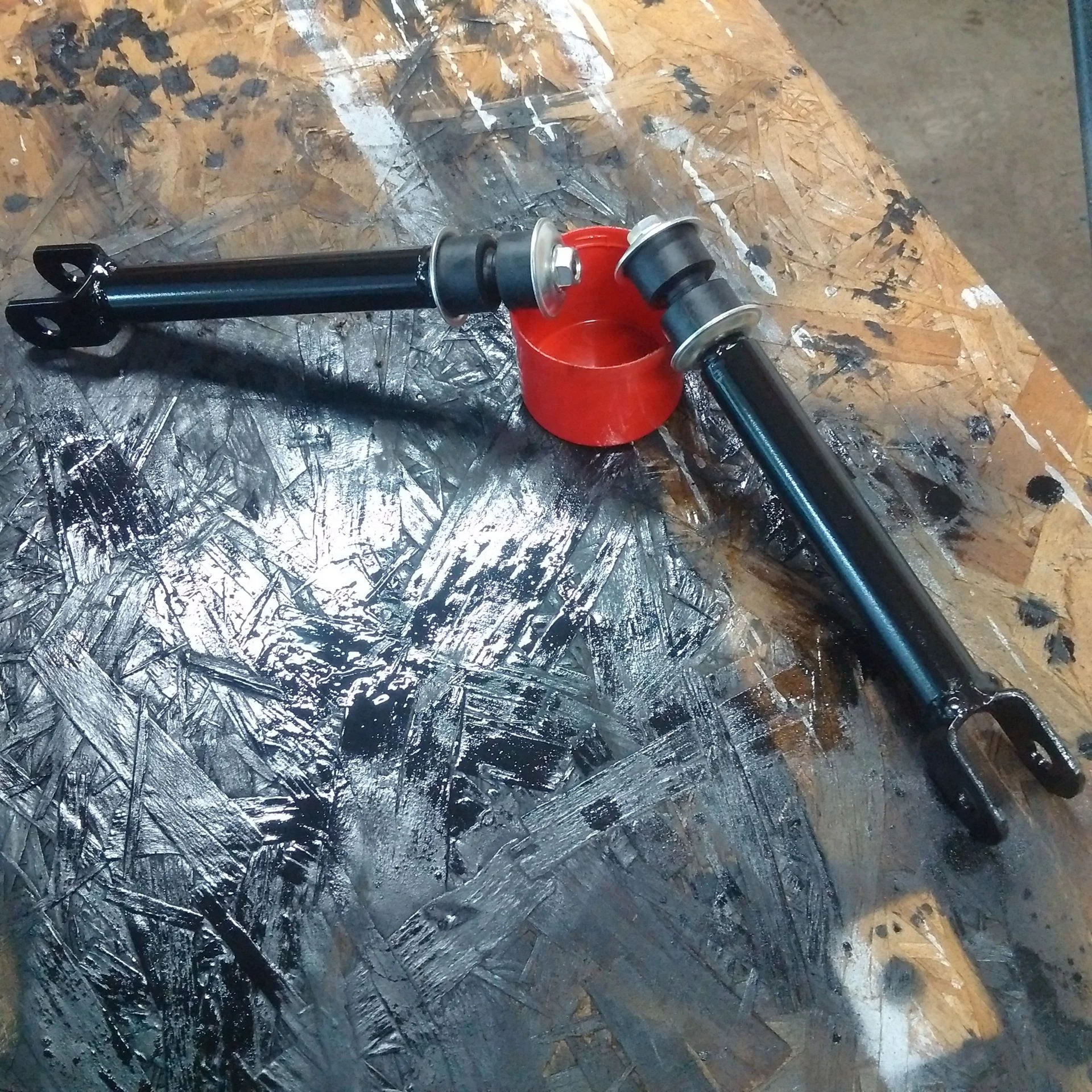

Fabbed my own extended front(thanks to @RobRed and tlcfaq).
My fab skills are a bit rusty(helps if you remember to turn on the gas little before you start welding.
So far test driving I think the longer links make the front end feel less "nervous"....like the suspension cycles more smoothly and less snappy over small bumps.
Fab was very straightforward,...not sure why nobody offers these for sale, except, perhaps low demand.

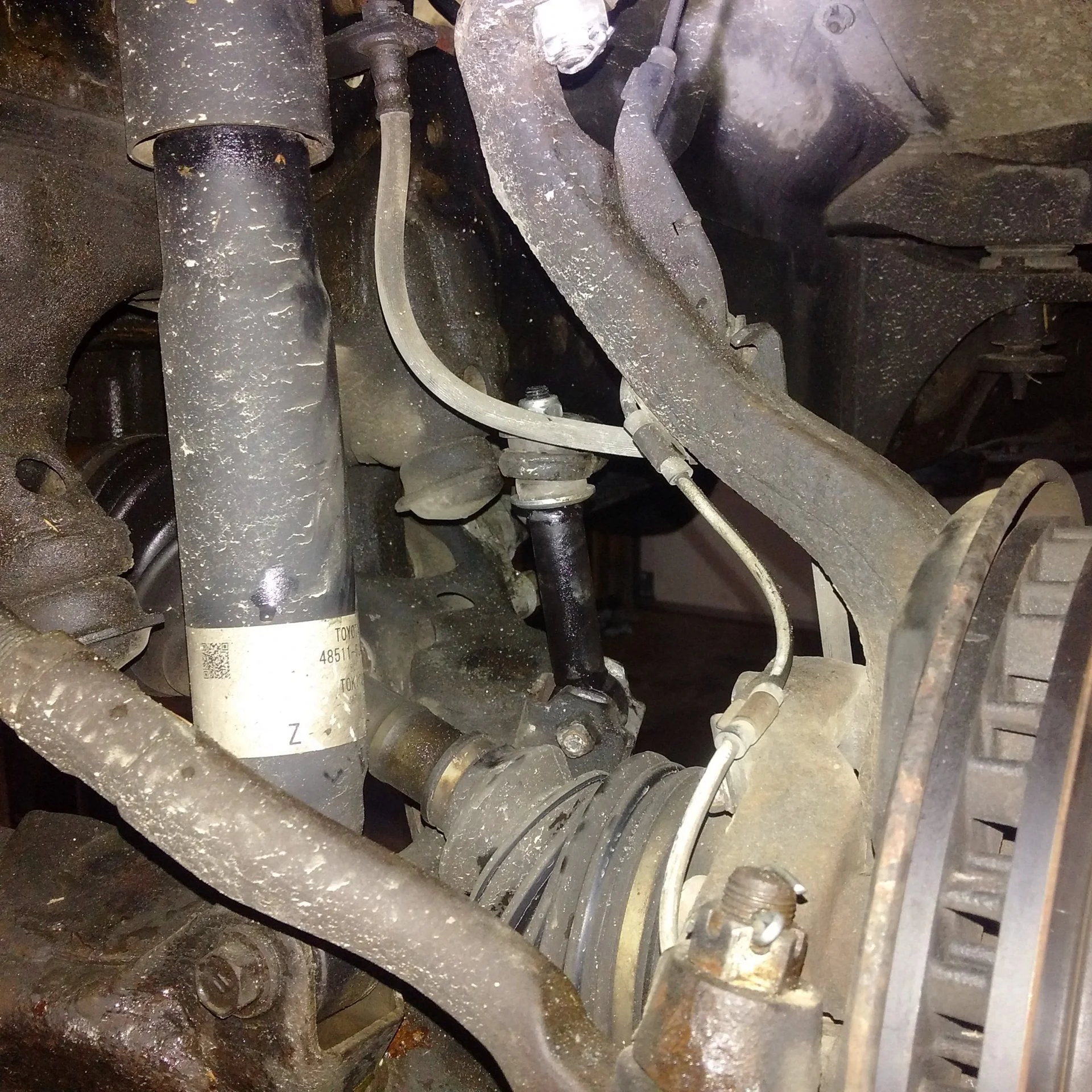

EDIT: It's possible that the new bushings are partially responsible, although the old ones didn't look terrible. Also, you can see the angle that the bar had been at.
Why does a longer link change anything, you would have the same force applied when the wheel tries to lift, just the bar starts at a different position. The force comes from the twist in the bar, if you could lengthen the arm of the sway bar or use a thinner bar then maybe.
Are you just cutting and sleeving a set of OEM ones, or fabbing from scratch? I'm interested in trying them out.
Cut and sleeve.

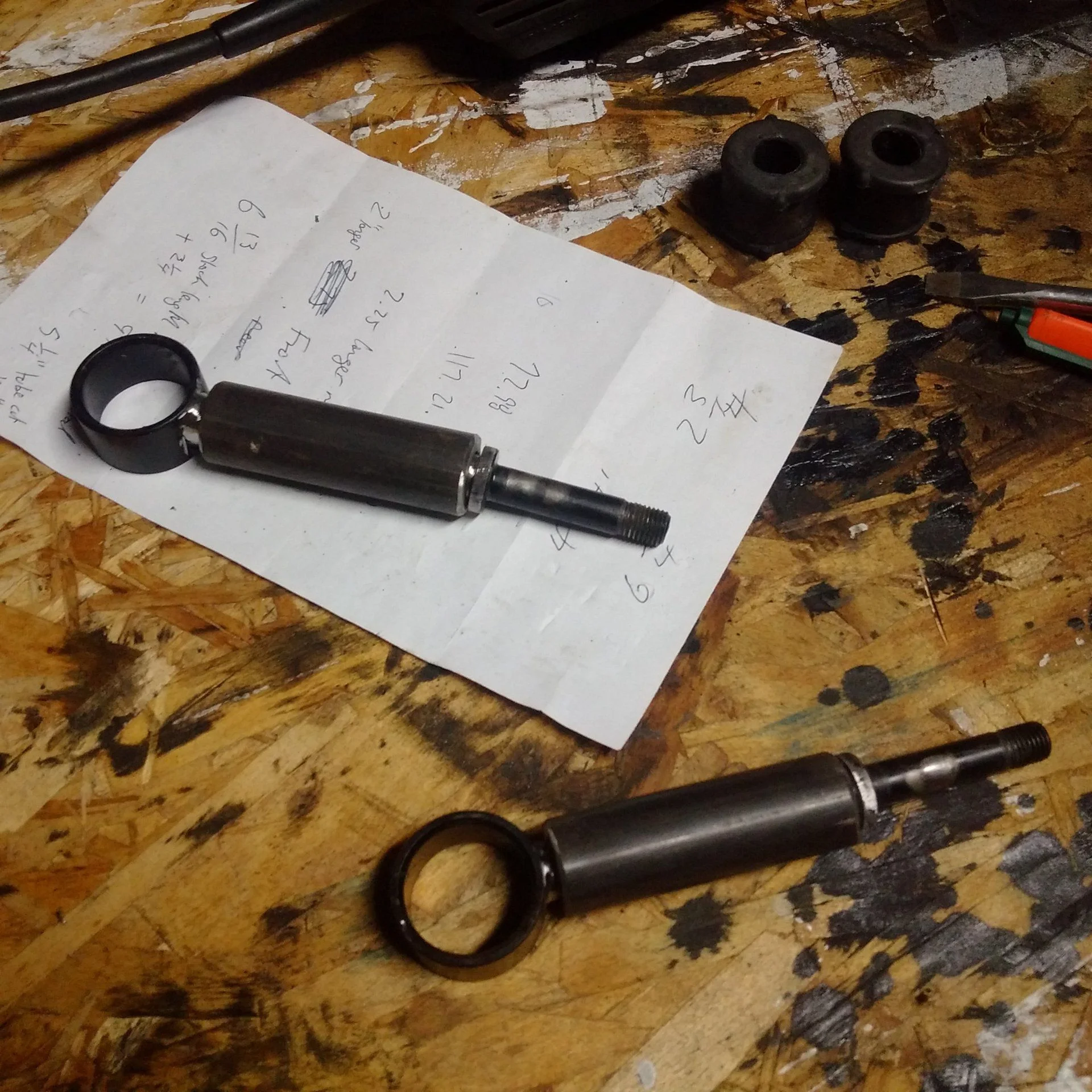

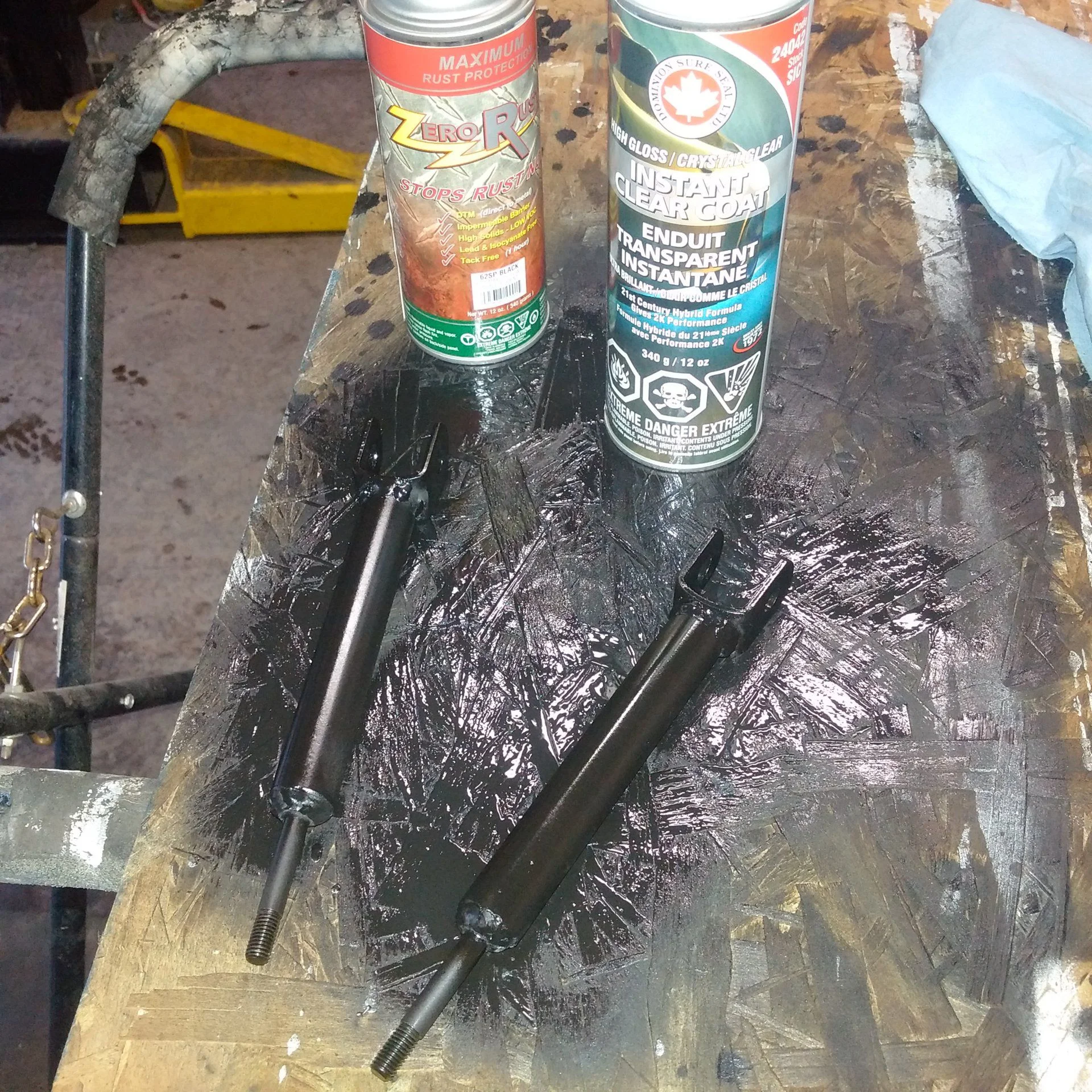

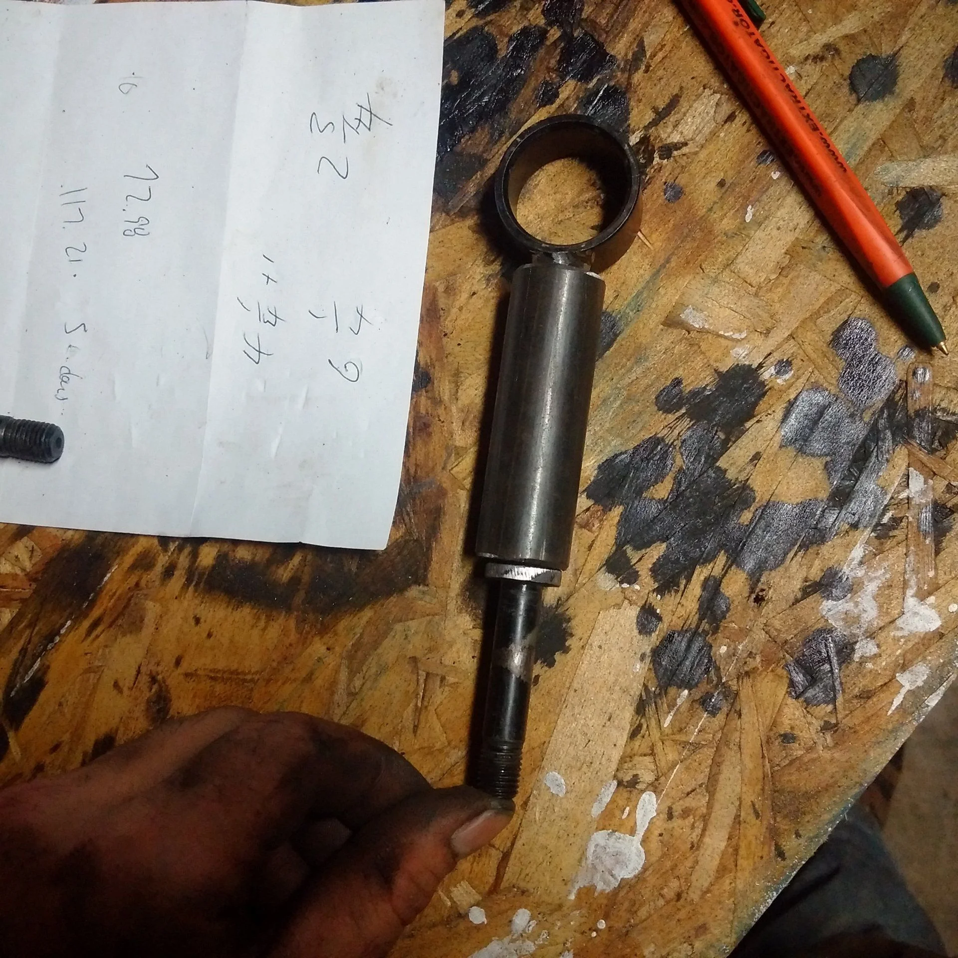

I ended up just ordering pre-cut pieces of pipe that were exactly perfect from Onlinemetals.com .....(I'm sure you understand, my other job as stay at home dad to a 5 month old hasn't been leaving much garage time for me).
I ordered 3 different sized tubes all cut to 2.75" (after measuring the factory links with calipers). The middle size was just right.
0.75" OD x 0.12" Wall Mild Steel A513 Type 5 DOM Tube
If I had to do it again I would have: gone to my old fire station to cut the OEM parts as I discovered my new station of 2 years doesn't have a vise, I'd remember to turn the gas on when welding the first link.....only other thing is to be mindful when welding the eyelet end as the bushing is right there.

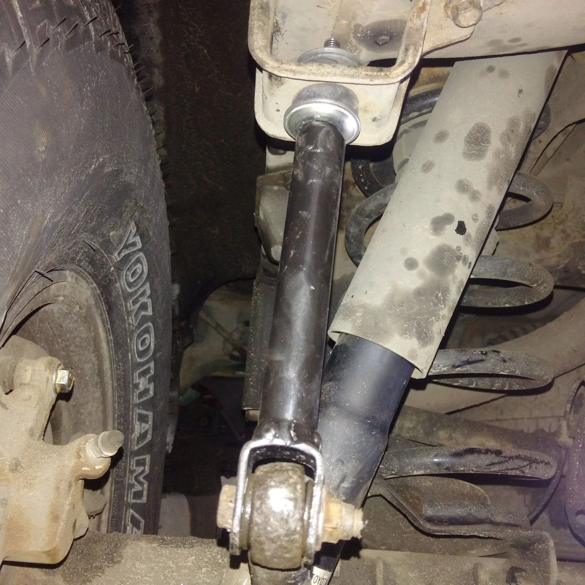

EDIT: One other thing that pushed me to do it was the 80 series extended rears, which fit the 100 series. After installing them I felt the rear suspension was able to perform fully as intended.

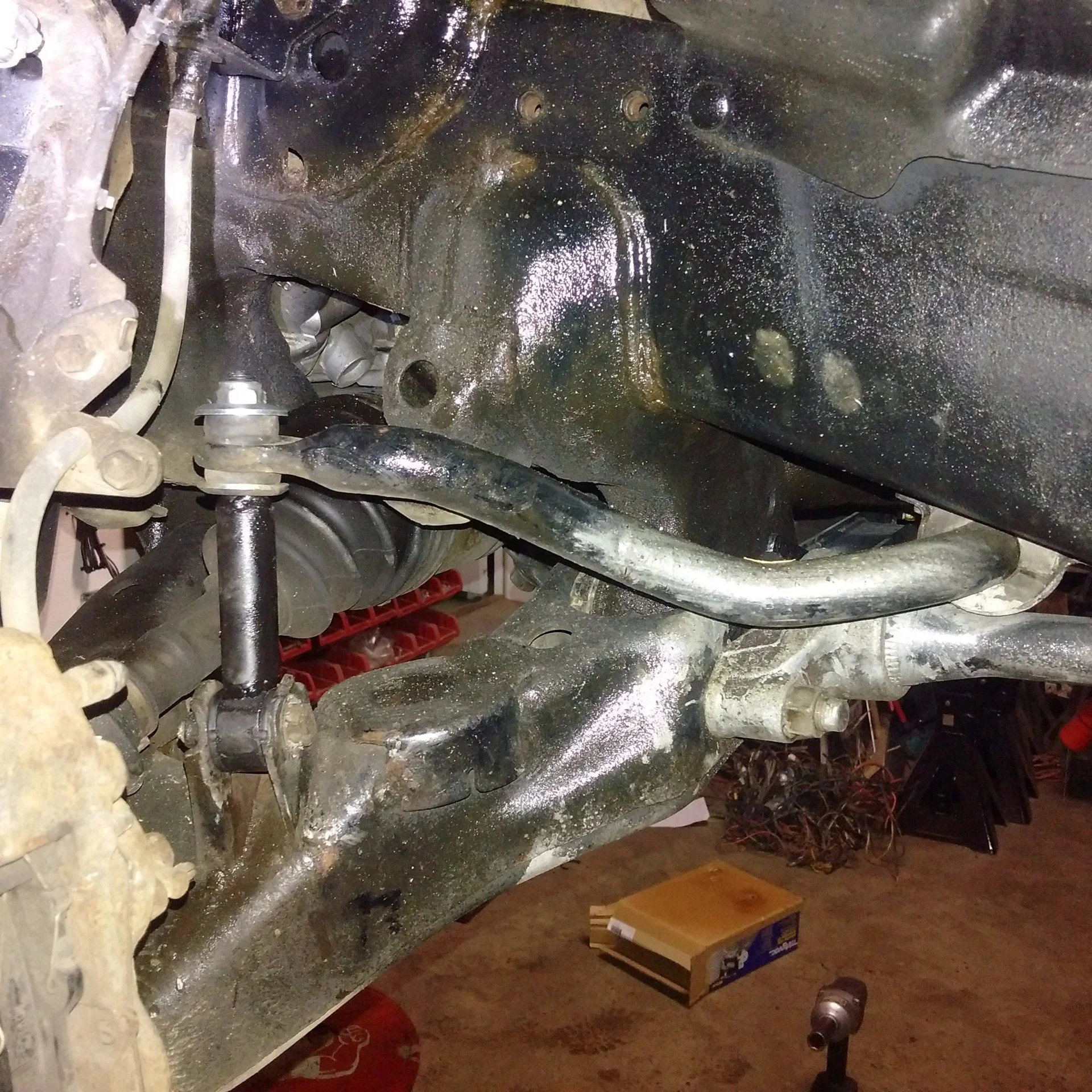

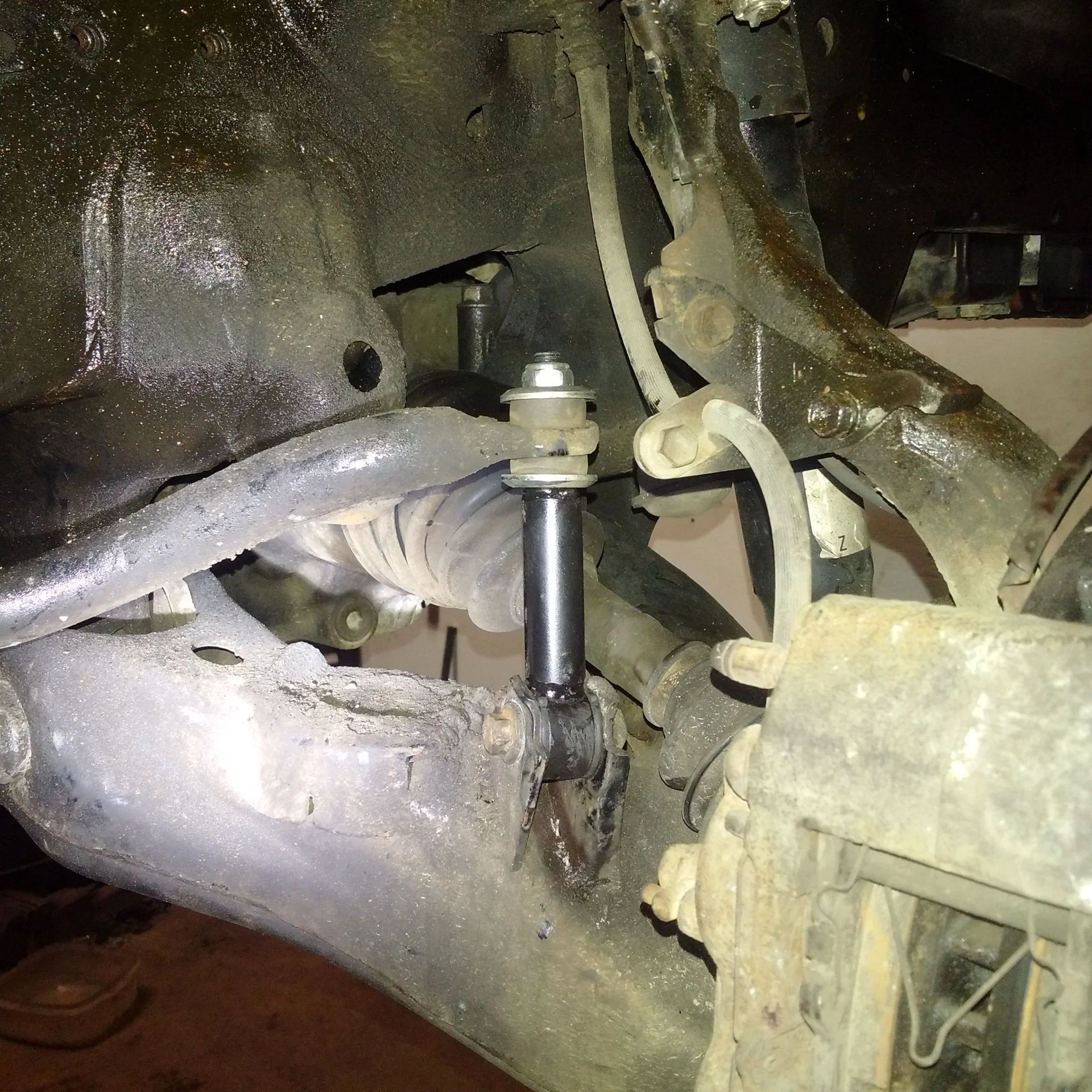

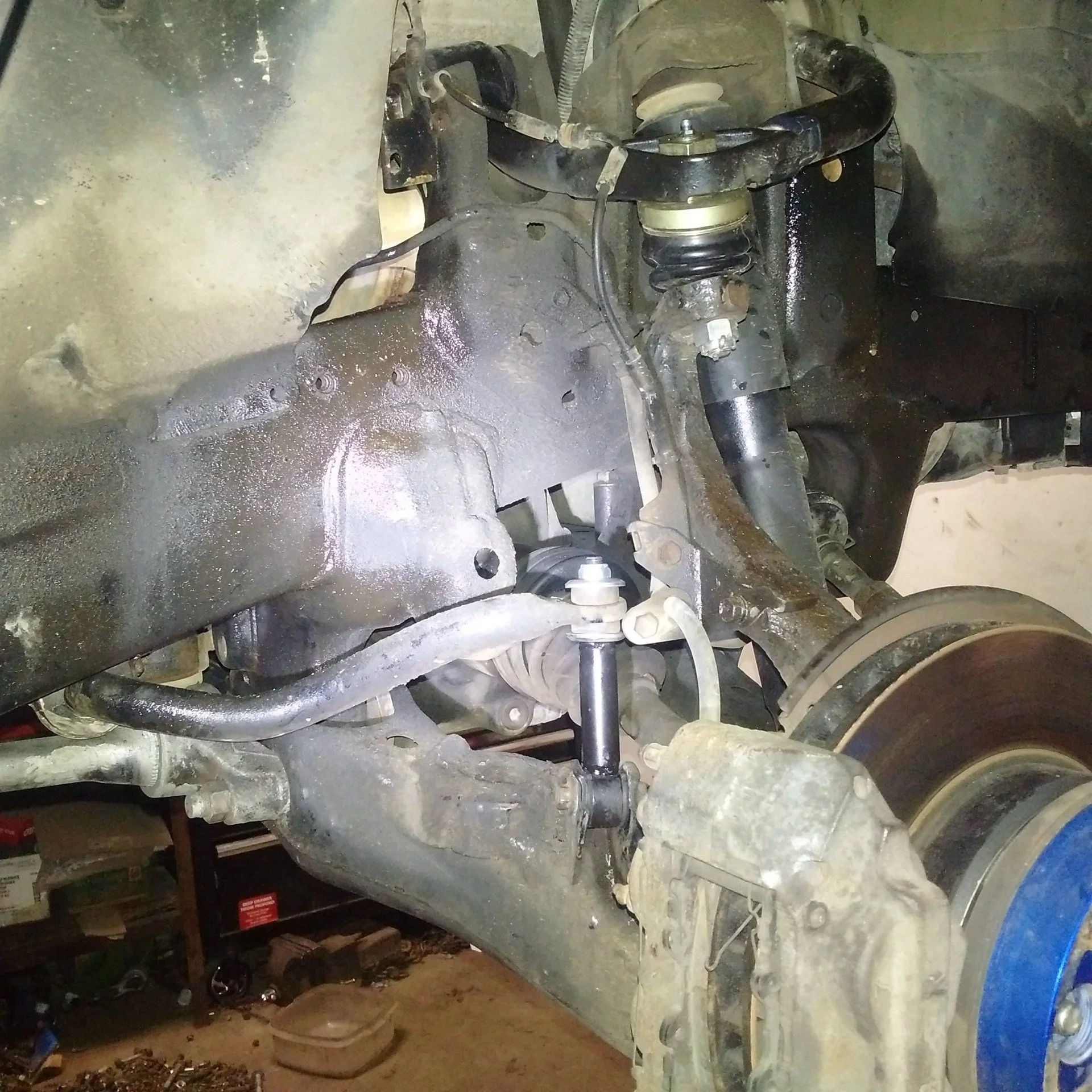

Thank you @RobRed finally got around to doing this and WOW, totally different truck to drive. My guess is the bars are so bound up they are reacting like springs. Before entering uneven road surfaces the Cruiser would porpoise and feel really skittish. Another member mentioned a "nervous" feeling which is a great explanation.
I went 2" front and 2 1/4" rear.
Here's some pictures, fairly self explanatory I think...
More pictures
More
Fronts installed, don't mind the Fluid Film, I like to hose some of that on before the winter.
@YardPig
Cudos to your fab work.

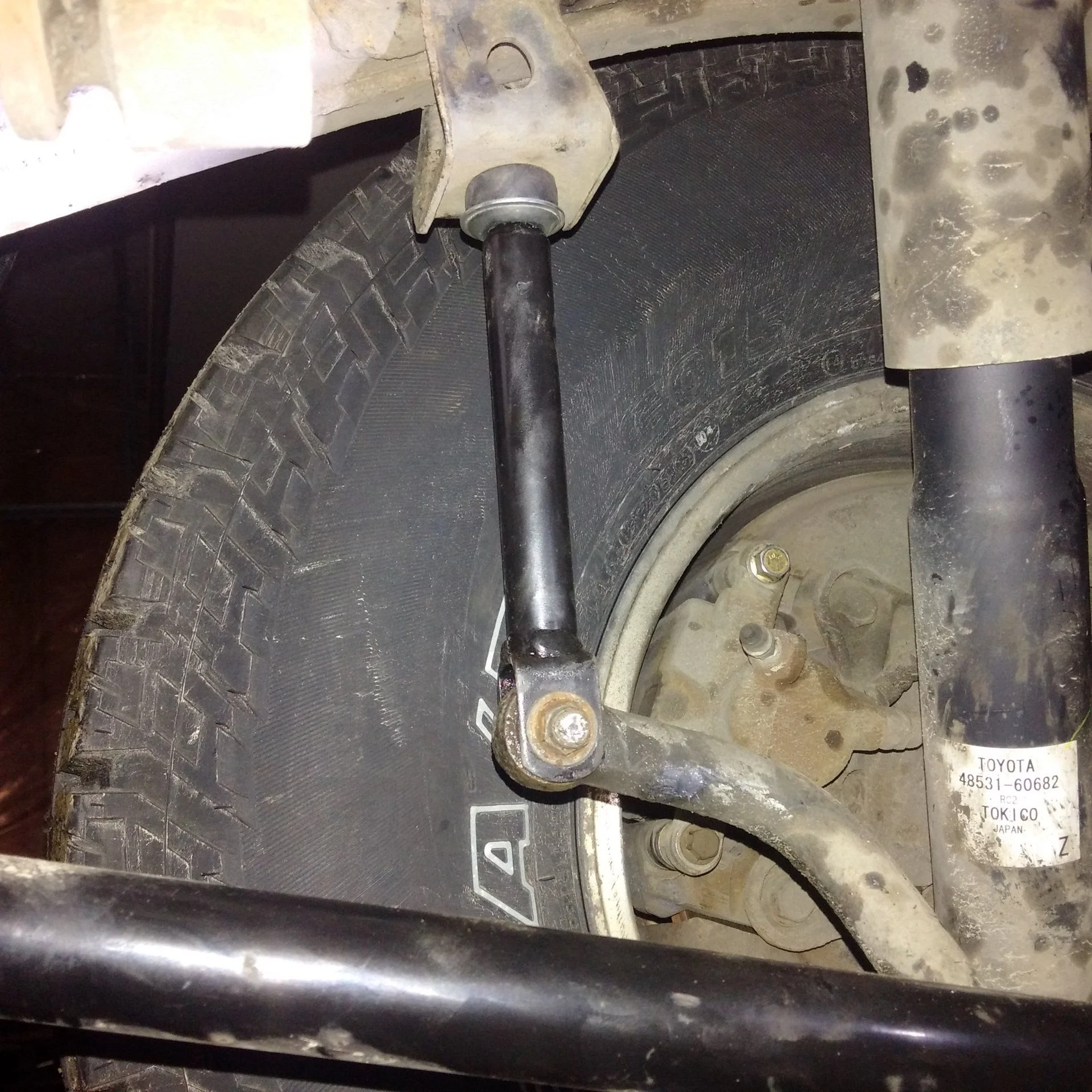

Noticed on your rear sway link that the spacer cap is missing that fits in between the top of the bottom bushing and the bottom of the bracket mount. Its a small detail that has noticeable results.
Fwiw that middle OEM spacer has a small raised lip on it that is designed to fit snugly into the bottom of the bracket to help hold the link in place to keep it from moving/shifting. I also noticed the aftermarket stem washers dont work too well to hold the bushes in place. The OEM spacer caps have more cup shape and seat the bushing better to keeping them stationary.
Anyway if your noticing some suspension noise, or noticing the bushings not sitting straight you may want to use the oem spacers especially the middle spacer cap to keep the bushes aligned and links from moving.
After my lift, I purchased a set of the Manafree extended rear sway links and used the included generic bushes & hardware which did not incorporate the middle spacer cap Im referring to. Although torqued to spec, I later found the link had been shifting with accel/braking force and articulation. I also found the the threaded stem portion bent as a result of play at the bracket.
Not happy with quality of the previous set, I reached out to Jason at Trail Tailor (@reevesci) and he fabbed up a set of extended rear links with a much beefier threaded stem. I skipped the included hardware and went back with new oem rubber bushes, and OEM stem washer caps.
Long and short if it is, the three OEM cap washers provide the best fit and long term result.
Hi, thanks I will keep an eye on that. The included bushings are stepped to fit into the bracket. Although I'm sure the step will eventually wear out and allow the bushing to move, I plan to replace the bushings far more often as they don't last long regardless of OEM or aftermarket and the results of new ones is night and day.
