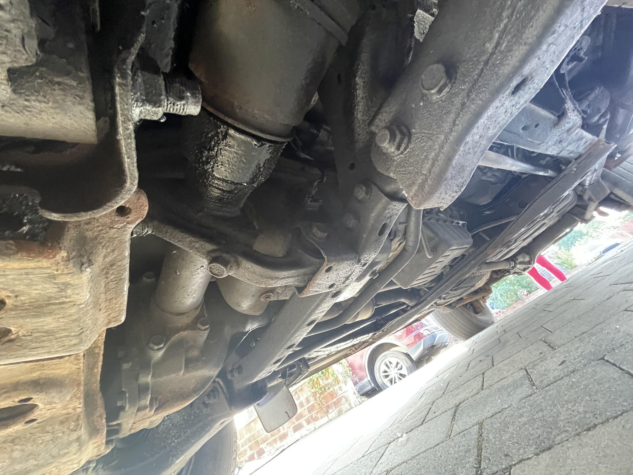

Tired of waiting, seeing rotten Land Cruisers or ultimately missing out to another buyer. I took the plunge this week and bought a 1999 Land Cruiser Amazon 100 4.2. 141,000 miles, good service history (though done and noted privately rather than at a dealer)
Assured of the previous owners care in looking after it (with underseal + oil) every year, ultimately I checked underneath and assumed some surface rust, not the worst.
However I need your guys second opinon, frame to me seems solid, and cared for. But the steering and suspension components seem suspect and slightly worrying. But I am not a mechanical expert.
Would like to know, the standard question in the LC community, is this too much rust?

It’s a holiday weekend here in the states. Probably not a ton of people on the board. The rust looks fine outside of the suspension bits. Start replacing consumables and enjoy the car. Hopefully you will be doing the work and not at a shop.
Surface oxidation... very common. No visible corrosion in the images you hve posted. A few hours of clean up (sand blast, wire wheel, grind, needle gun etc) ill give you a nice surface to hit with a rust kill primer, a coat of paint and then some form of external coating to reduce the likelyhood of further degradation. Cleaning out the internal frame would be a good idea as well, followed up with some type of internal coating that is available in your area.
Some of those rust areas don't look to great, esp. around the suspension. I'd be concerned about the bushings, ball joints, etc. I'd also be concerned about the random fluids/stains around the underside, where's all that coming from. But, bet it's running better than a Rover.
smack the rusted parts with a ball peen hammer. If hunks fall off - not good. If it pings like a submarine sonar - good sailing!

Cheers for the response, agree with that. To my eye, frame and underside mostly looks okay, some surface rust. Suspension definitely needs addressing, going to be taking out the AHC and replacing with an aftermarket suspension kit, likely Old Man EMU. Will be doing as much of this myself as possible!
Thanks for the detailed response, this is definitely the course of action. Been researching sand blasting in the local area, seems to be a few options. Also had a look at ice blasting. Will definitely look at cleaning out the internal frame as well. Appreciate it Delz!
Yeah this was my diagnosis honestly, the suspension doesn't look great. As long as the frame and main body is okay, I can then deal with spending a couple of thousand on replacing the suspension for an aftermarket kit. Currently the AHC is stuck in normal height (no surprise) so it will have needed doing anyway.
The previous owner sprayed oil and rust protection each year so I think that's the reason for the fluids undernearth. It's been well serviced over it's time and I would be surprised if they were any leaks.
Thankfully no hunks and chunks coming off, just old rust protection flaking off a bit!
I’ll pass on this one, the rust in the front IFS area is just too much. And if it a lot in that area you can only imagine in the areas that you don’t have direct line of sight to verify.

Yes, this is high on the list to be honest. Going to remove AHC and replace with Old Man Emu suspension, as well as replace all other suspension components. sway bars, bushings, tie rod ends, steering linkage, ball joints etc.
I completely agree, IFS area is a concern, however it shouldn't be too costly or difficult to replace all these parts. I planned to replace AHC with Old Man Emu suspension anyway, so whilst there will replace all tie rod ends, sway bar linkages, bushings, ball joints etc. Most important to me was that the chassis and underside was solid, which it on the most part appears to be.

Honestly, even being in the NE I wouldn’t have picked this one. Some parts look fine, others look like they tried to cover the rust with paint and now it’s peeling off. If that’s what they did it will accelerate the problem because moisture is trapped.
Do not forget to replace torsions bars as well. AHCs torsions are smaller then regular suspension.

I am not sure about NE, but in the UK, it's really difficult to find a Land Cruiser without rust, infact I am yet to see one without any. I viewed a few before this, and they were absolutely rotten underneath. I probably rushed into this one a little bit, but the frame looked good and the price was tempting enough (though not as low as I would have perhaps hoped knowing what I know now).
