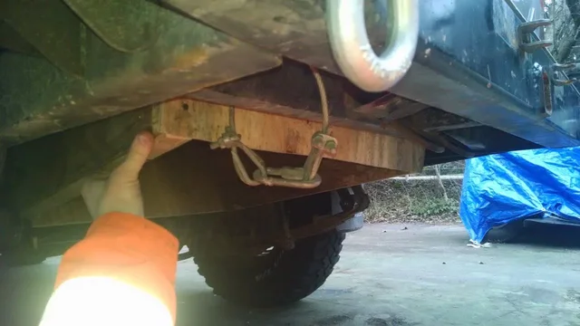

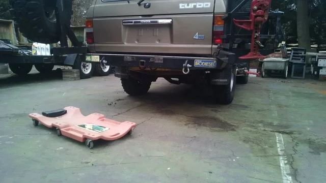

The mock is about an inch deeper than the design above. It's sitting in there crooked because it's only being held in there by one bolt in the front and two weak brackets in the rear. The second picture is just a profile shot. I'm squatted down to take it.
How should I listing these photos by the way? I see some guys do links, other inserts. design 1 mockup underneath.webp design 1 rear view.webp
