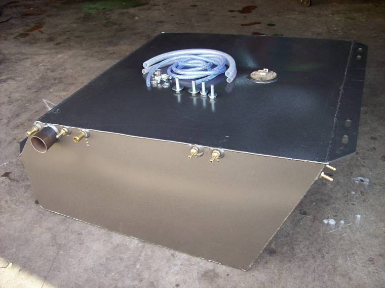

Ebay australia site, theres a factory aux tank that sits inside frame rail on my aussie passenger side so drivers for all u yanks. Thatll extend ur range. Personally i have the 4wd systems lrt 190 litre gets me 1500 to 1600 odd ks.

You mind sharing photos of the top of that extra tank? Where the line go, hole is, ...? Are you going to open up the tank to figure out the baffle arrangement and any other interesting features? Thanks.

Yes, I can do that. I'll put up a cardboard sign with measurements etc. on it.
I am not sure I will cut this tank up, I hope to see what I need through the two openings on top. What amazes me is how the tank physically doesn't need to be really large to double capacity. I'm concerned with venting and structural integrity primarily. I have to admit to being slightly
baffled by baffle design ;)

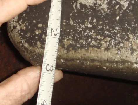

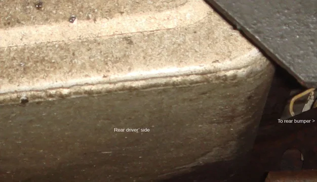

Fred, next time you're under the vehicle, could you share what width those welds and if they're overlapping? It looks almost as if they bead rolled the edges as well (guessing?), overlapped and welded them (possibly from both the inside and) outside. Probably baffled for added strength and then sealed (guessing?) with one heavier gauged piece.

could you share what width those welds are and if they're overlapping?
Here are some enlargements.
Yes, now that I look at it, the sides don't look like they were just flat pieces of AL welded to a corner joint to the bottom.
It looks like the edges on this tank were formed at a right angle so the bottom-sides piece then had a lip to rest on. I do not recall if it was welded inside. Undoubtedly everything was laser cut prior to bending.

Few OEM gas tanks use conventional butt welded plates positioned edge to edge. They are almost always mechanically electro seam welded. I'm sure you-tube has a video or two. Because of the initial investment this is cost prohibitive for most small custom tank shops. The down side of typical manual butt welded tanks is once they almost always a have a pinhole here and there that needs to be chased down and fixed so the build is more time consuming.
Light gauge parts, such as sheet metal gas tanks, are overlapped with seam welding and the assemblies are almost always first run perfect.
Mechanized seam welders are also used for butt welds where long continuous weld are required such as the closing welds of HREW (hot rolled electro weld ) tubing, which is the most common tubing on the market . DOM HREW, CREW and ERW tubing is all seam welded. CDS is less common and starts life as a seamless tube before being drawn over mandrel.
