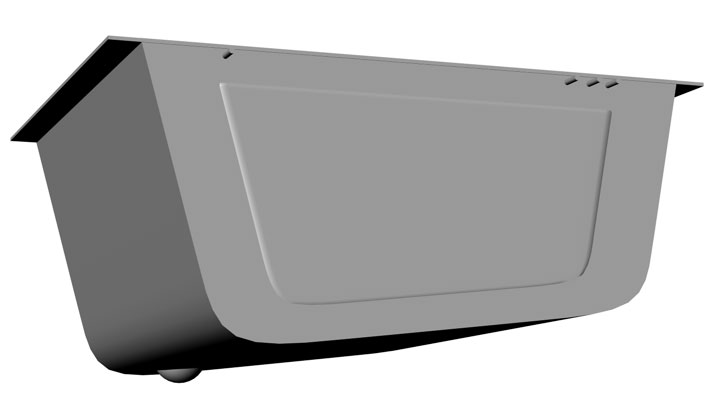

Here is a quick (crappy) rendering I made of the discontinued 185L ARB tank. It is not exact, but you can get the idea.
Top flange has bolt holes in it (I did not make holes in flange in model) to match up with existing tank bolt holes
Tank has all the vapor nozzles that the original tank had (just a few doo dads were placed in model for reference. Location is wrong)
Side view. Not exact.
The bottom does angle up a little, but not quite as much as shown in the model. Maybe 1/2 the angle.
There is a small drain bowl on the bottom right that protrudes down with a drain bolt in a reinforced bushing.
The front of the tank does angle back, similar to the rendering.
The 185L ARB LRT designed for 60 has a full width flange (lip) on each upper end of the tank. The tank is supported forward and back from those top flanges only. There are no supports on the sides. There is no strap running under the tank. There is no skid plate. Just those two flanges on each end support the entire weight of the tank and it has proven to be plenty strong after 26 years... But then again it was built by ARB.
The top rear end of the tank has a separate steel metal L bracket plate that runs the width of the tank to reinforce and support the aluminum welded flange. It was pre-drilled and bolted directly to the existing bolt holes that the old tank used.. I think the top front flange on the tank uses a similar steel reinforcing L bar as well. If you are interested, I could take some pictures.
The front top of the tank bolted to the original tank bolt holes (with a reinforcing steel L bracket) and angles downward and back to the front bottom in order to clear the differential. The tank is not square. The bottom front edge is rounded, not a sharp weld. In fact, the tank front, bottom and rear is one continuous piece of aluminum that is bent (not welded) at the bottom corners. The sides and top are welded to it.
The clearance between the tank and the differential has to take into consideration the parking brake brackets that stick out, and the fact that the axle housing ram rods in and out a few inches when the suspension is working hard. Take into consideration where the tank and differential will be when the car bottoms out hard.

Thanks for the drawings and information. How far inside the frame rails does your tank mount? The wider it is, the shallower it is.
I've got a capacity I'm aiming for, so the volume will be easy to calculate from that. Any idea metal thickness? Did you get a weight
when you installed it?

How far inside the frame rails does your tank mount? ...
Aluminum.
Not too heavy as I recall.
No idea about it's thickness, but my impression was that it seemed sturdy... But it is essentially a welded box, so it is hard to say. There is no way for me to measure it's thickness right now.
It has baffling inside the tank, but it's not a catacomb of a zillion baffles.
Used the original sender and just increased the float arm's length.
It has an inspection port on the top like the original.
The ARB gas tank for the 60 is:
31"W X 28"D at the bottom.
Rear is 10" tall (straight up and down) but it has a little bump in it half way up.
Front is 12-1/2" (straight up and down)
Both ends use original tank mounting bolt holes with a steel supporting bracket underneath. No other method is used to secure tank.
