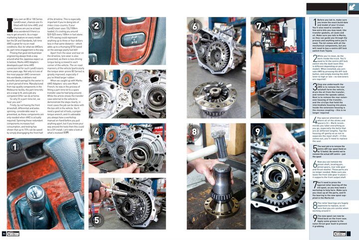

Back to this mod - The ONLY hubs available for an IFS LX470/100 series are AVM
Full report on this PIA mod later
After 6 hours:eek: Im happy with the out come of the hub part

I must have missed it, but did you just install hubs or did you get a PT kit in the transfer case also?
Just got excited and threw hubs on thinking it would quick and easy, not! Having done it before it will take less time to install the spool in the tcase. The spool will need to wait because Im in the middle of prepping for a trip and some small mods on my 80 series.
ABS is fully functional in 2wd
No need to remove the tcase when installing the spool
Pressing a new bearing on the spool is much easier unless you have a large bearing removing tool. The tool cost is much more than the bearing

Spent some time on the highway confirming this is the way I want to go. Without the spool installed in the tcase I can easily switch back and forth between 2wd and all wheel drive hub equipped. Both the wife and I like 2wd much better on the highway and dirt forest road. Steering is lighter easier to drive with less steering input and no torque steer. We have one trip to Mexico coming up in a week and will do the transfer case spool install when we return.
Note: If my plan was to wheel my LX470 hard I would be scared of AVM hubs even the HD version I purchased. They are in no way an Aisin Hub equivalent.
