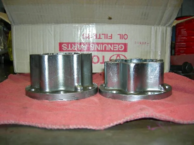

Here's the best picture I've seen comparing different hubs, especially showing the difference between the long and short body aisin hubs.
I actually found a set of the long-body hubs and I'm working on getting them.
