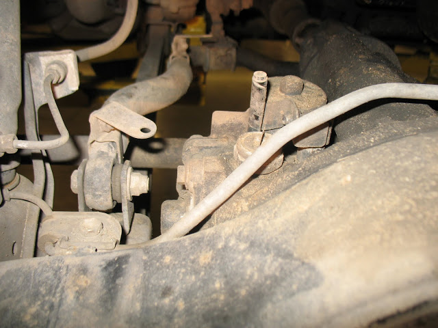

Well, this week was slow at work, so with permission, I pulled the rig into the shop and started fixing oil leaks (valve cover, oil pump, P/S pump). While in the air, I took a closer look at the front diff lock actuator and found nothing connected to it! :eek:
The brackets mounted to the sway bar are supposed to have something attached to them, namely, the locker harness. I don't know how I didn't notice this before. :o:o:o
I think I saw the pigtail harness coming off the actuator and assumed that was all there was. NOT!

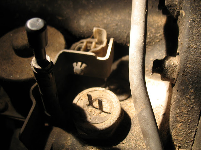

You can see in this next pic where the indicator switch connector is broken off, and the actuator connector is even broken.
Not sure why it's missing, unless someone cannibalized this truck to fix or modify another. The broken pieces point to some kind of violence, either an accident or theft. :confused:

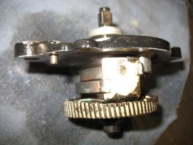

Got the new harness and installed it, but the front locker still wouldn't engage.

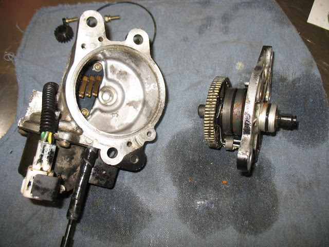

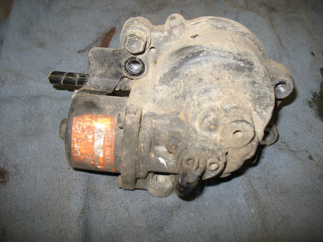

Finally decided to take it out and pull it apart, along with a bit of cleaning.

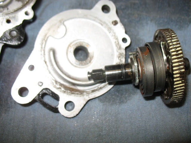

This piece on the right turned out to be the culprit. The open vent tube allowed moisture to get in there and cause some rust and corrosion.
When I first tried to turn the gear, it was just making the spring move, and not the shaft. Once I messed with it a bit, the shaft started turning and I was able to pull it out of the housing.
A little more cleaning and sandpaper work, and it was ready to go back together.

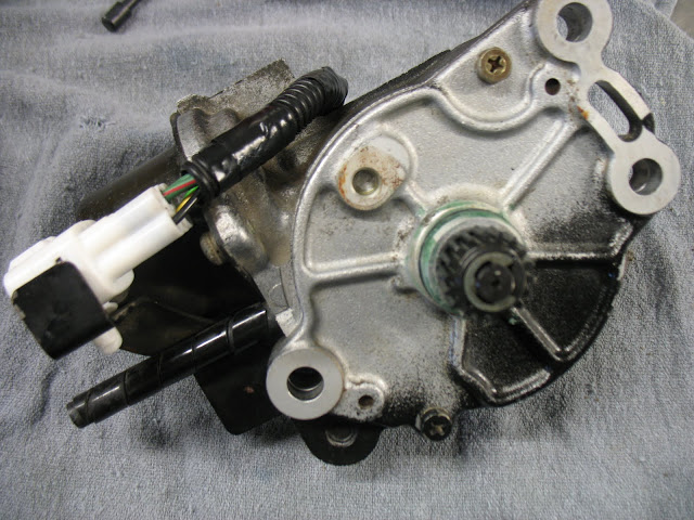

After carefully following the FSM instructions to line up the gear, I reinstalled and connected the actuator. The Cruiser was already up on the lift, so I started spinning the wheels and working the lockers. Yes, I said the lockers were all working!! :bounce::bounce:

Pulling apart and cleaning was surprisingly simple with this one. The hardest part was interpreting the diagram that showed how to position the gear when you reinstall it. The FSM actually has you lock the diff, then make sure the actuator is in the locked position as well before installing.
I don't know if I'm smarter, it took me since May, when I bought it, to figure this out.:doh:

I should have taken some pictures of that, but the FSM explains it pretty well. You can slide the "rack" gear of the locker with a screwdriver or possibly with a finger. When the actuator is working properly, an AA battery is all it takes to operate it. The FSM calls it a 1.5V battery, which is any single cell; AA, D, C, etc.

I used dielectric grease on the contacts, multi-purpose white grease on the gears, and transmission assembly lube on the o-rings.
