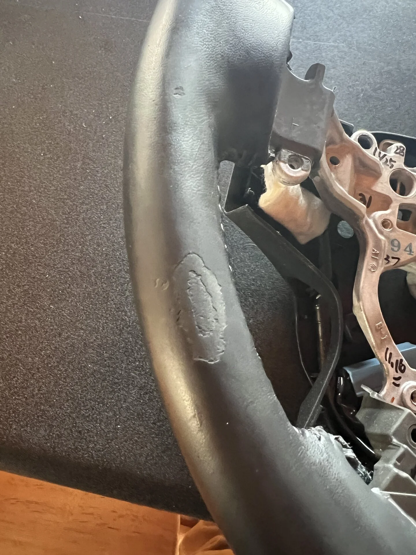

We have a loaner steering wheel from a 2017 200 Series that we can use while getting ours redone.
Data point: Craft Customs in TX was recommended to me for steering wheel refinishing. They have a 3+ week turnaround time.
Here's the idea: if someone needs a loaner, they post up here in this thread. They then only need to cover the cost of shipping to have this shipped to them. When they are done with it, they ship it to the next person in line, and so forth. If nobody is in line yet, they hold onto it until it is needed again.
That way, nobody is out more than the cost of shipping for the loaner.
The one thing that would be nice is if we kept it moving with as little lag time as possible - as in, if you get the loaner, get your wheel out to the refinisher asap, and when you get your wheel out, send the loaner to the next person.

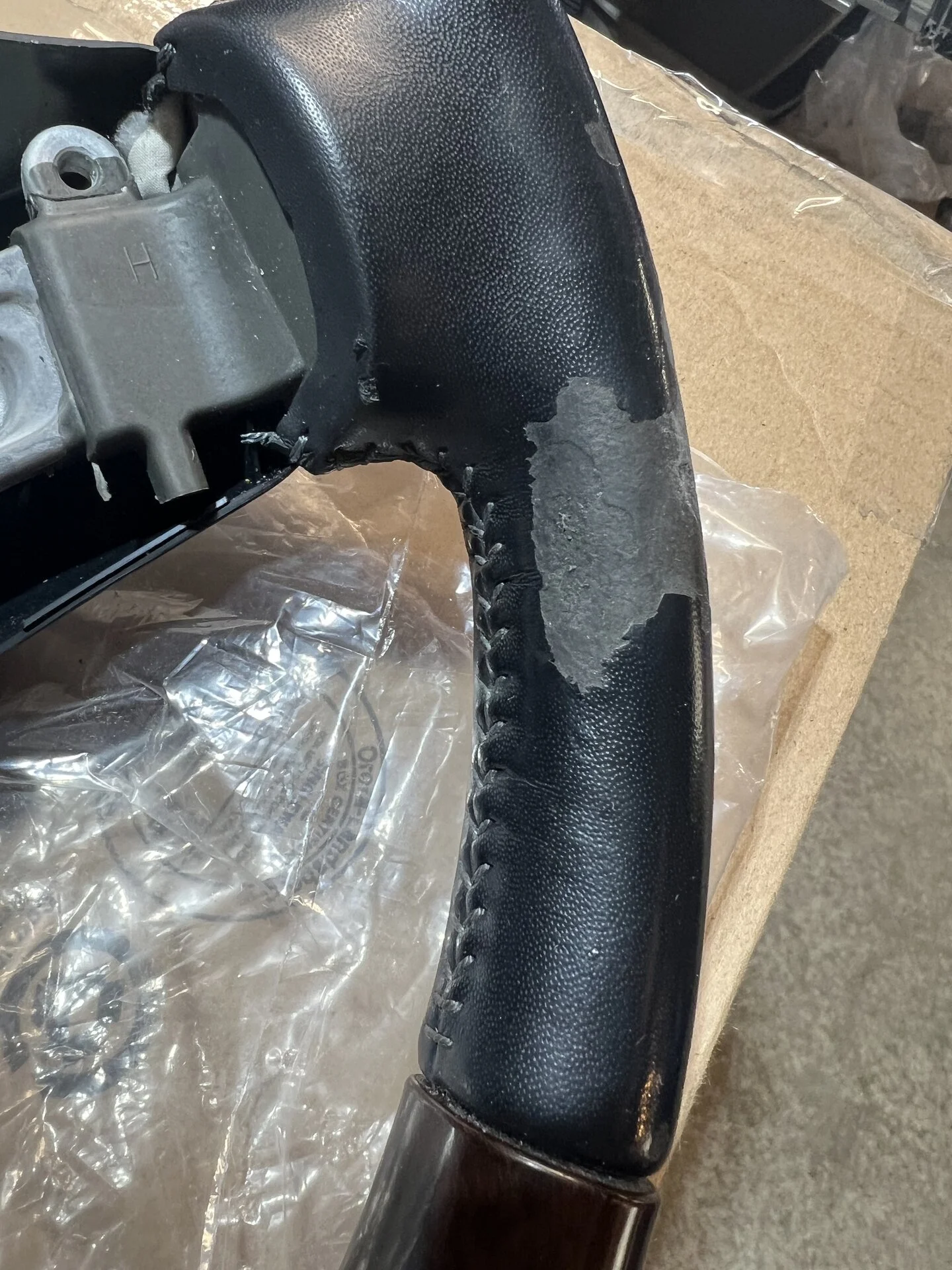

Back story: I've wanted to get my steering wheel reupholstered for a long time, but since I drive my 200 regularly, and don't have local places that reupholster steering wheels, I've put the idea on hold. I get the impression that there are several of us in the same boat. I watched eBay and other places for a spare steering wheel at a good price. It eluded me until recently when member @Norcal470 posted up offering his steering wheel for free. All I had to do was pay for the ride. (side note, I am constantly impressed by the generosity of 'mud members). Thanks to this, I'm able to get my steering wheel redone while using this as a temporary stand in.

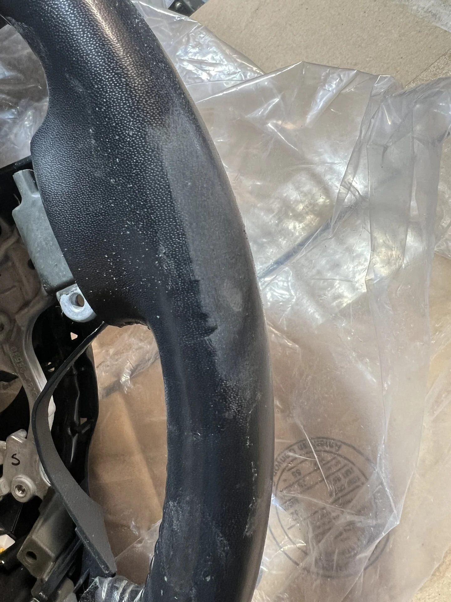

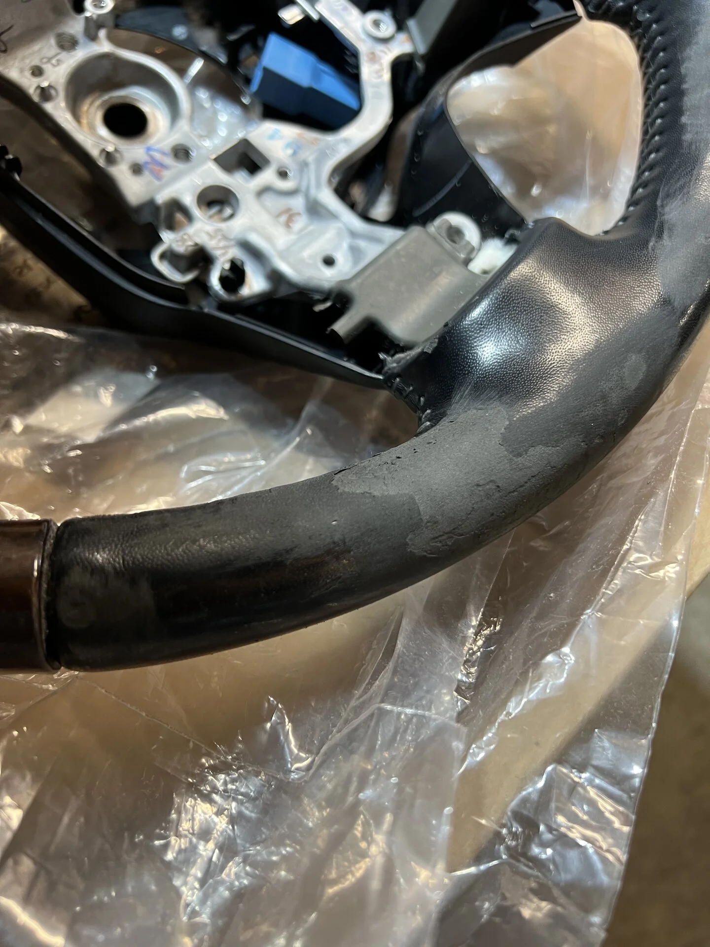

When I got the steering wheel, knowing it was to be a loaner, I sanded down and feathered the edges of the damaged areas, cleaned it with alcohol and moved my Loncky cover over to it. My sewing job isn't going to win any awards, but it is perfectly serviceable as a stand in for a few weeks.
My steering wheel is on its way to Texas and I expect this loaner will be ready to go out to the next person in line by April 1st.
The first person in line is @Fisher23. I'll coordinate with him to get it shipped as soon as mine gets back.
Please post up here if you are interested.
This is a bit of an experiment too, it relies on everyone doing their part and keeping the goodwill started by @Norcal470 going as long as possible.

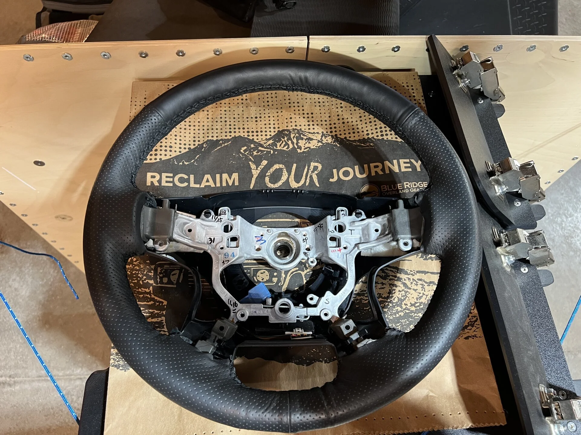

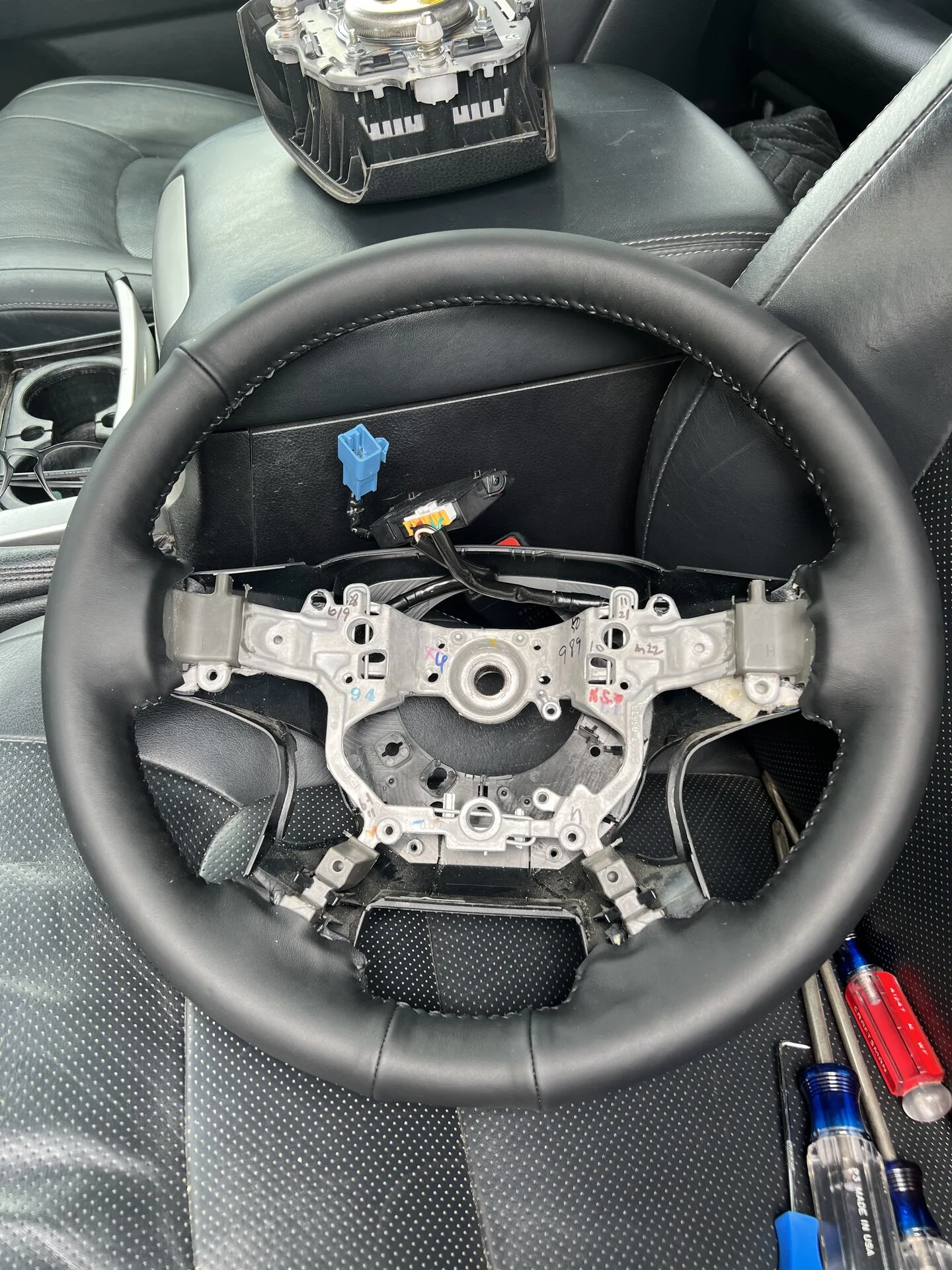

Some pictures of the loaner wheel.
After moving Loncky wrap over..
Before

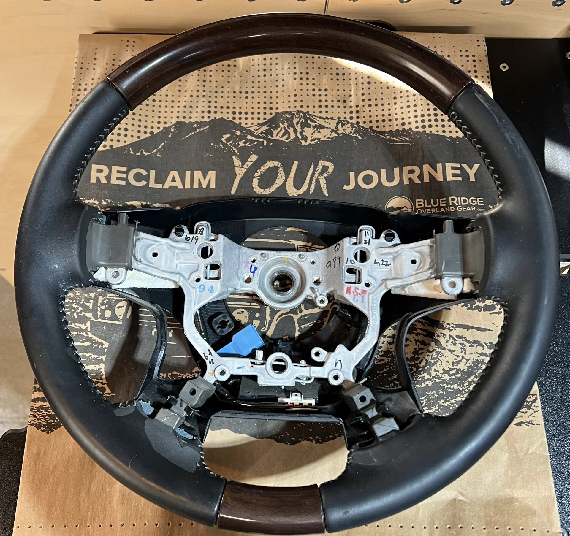

Holding this post for some before and after pics of the steering wheel from my '16 that I am having redone.
Before:
After:
