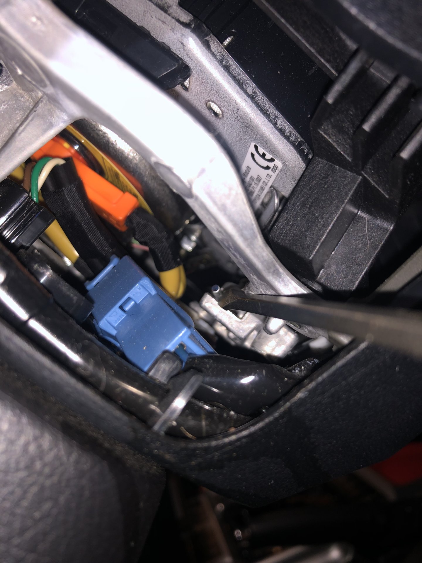

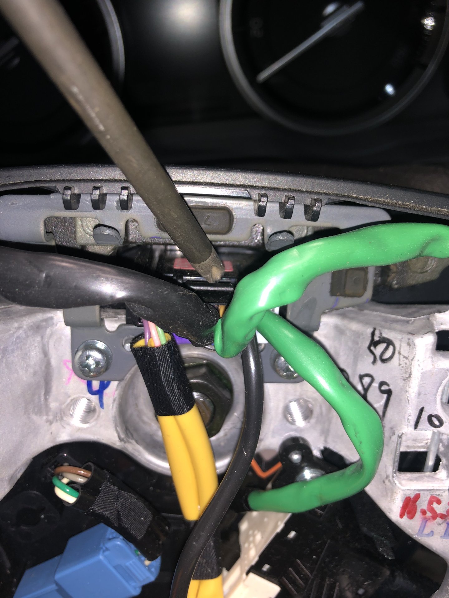

I used a flat bladed screwdriver to push the end of the clip outward from it's closed position.
Once you move the spring pin far enough, the coiled springs in the airbag/horn mount will pop that portion of the airbag free.

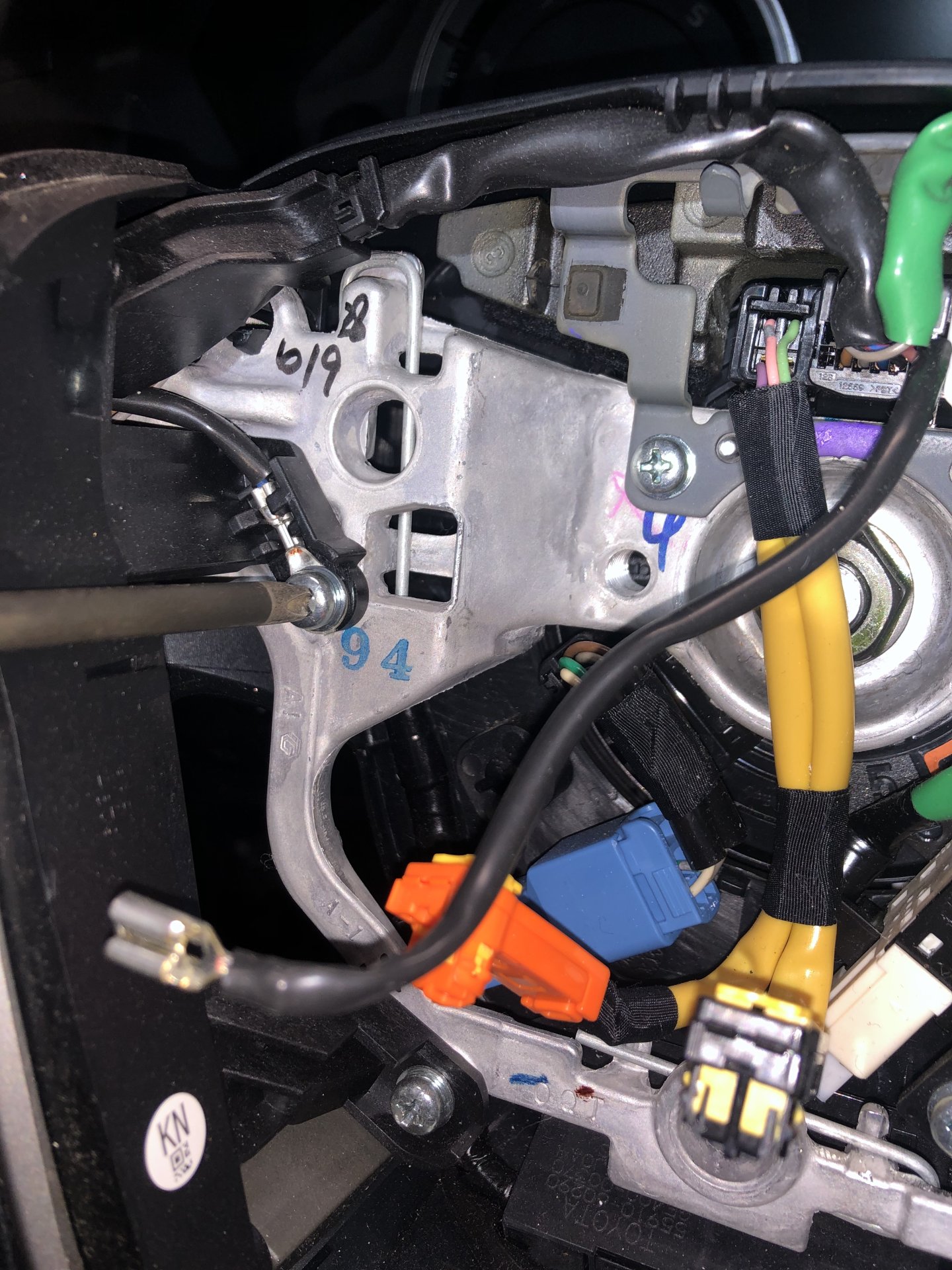

There is one clip on the bottom, and two on the top, they're in the holes shown here.
The screwdriver below points to one of the clips. You need to push on the metal clips where I've drawn the red arrows below (but you can't see them with the airbag installed).
To remove the airbag, you need to disconnect three leads - two airbag cables and what I believe is a horn ground wire.
The airbag cables have a locking clip that needs to be pried up before pulling the connector off. I did that with a 90 degree pick.
The horn wire is a female spade clip, but it has a locking feature that you need to pry outward to remove it from the airbag assembly.

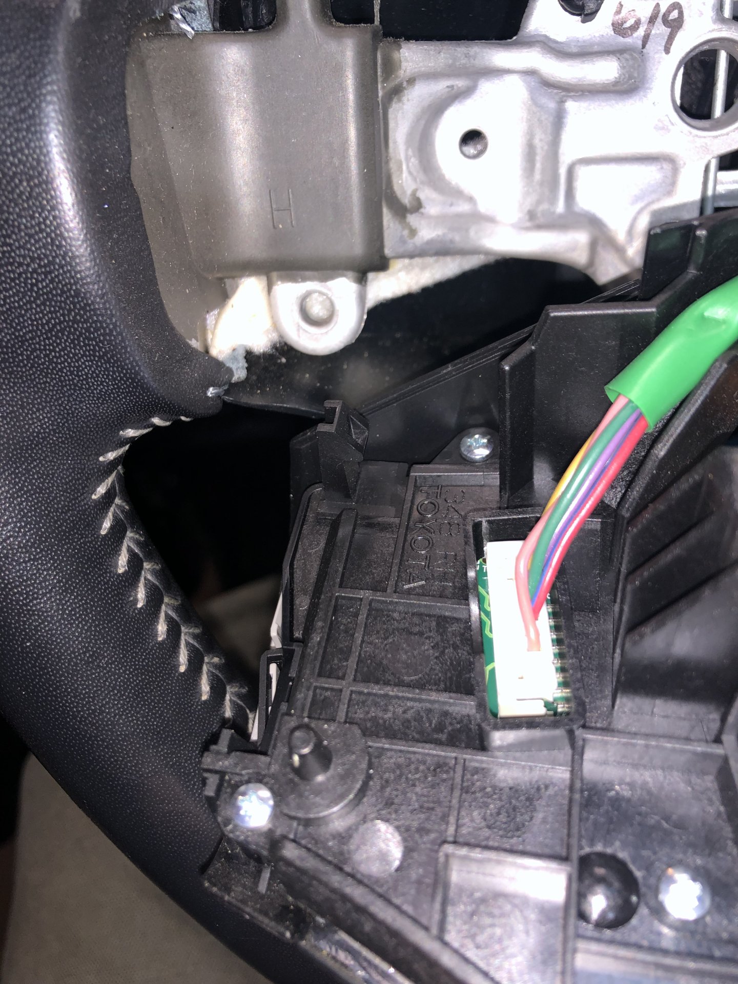

From here you can easily remove the switches on the face of the steering wheel by removing the phillips screws and unplugging the electrical connector.
Once you remove the screws, you can pry up from the bottom and then the top (toward the outside of the wheel).
