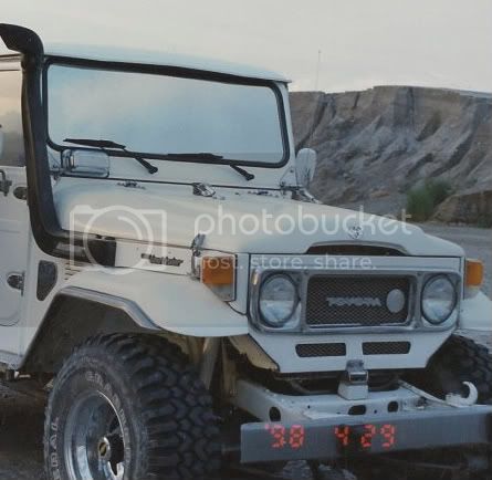

The reason why I decided to go with a landcruiser was because my Dad used to drive the 40 series in the picture below. pls dont flame me for having a 40 series pic in the 100 thread

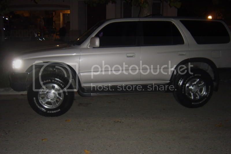

Before I got my 100 series, I was driving this 4 runner

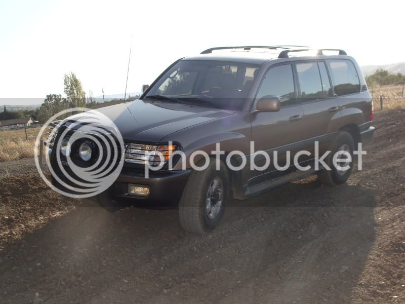

Finally! On to the 100 series and the way it started out!

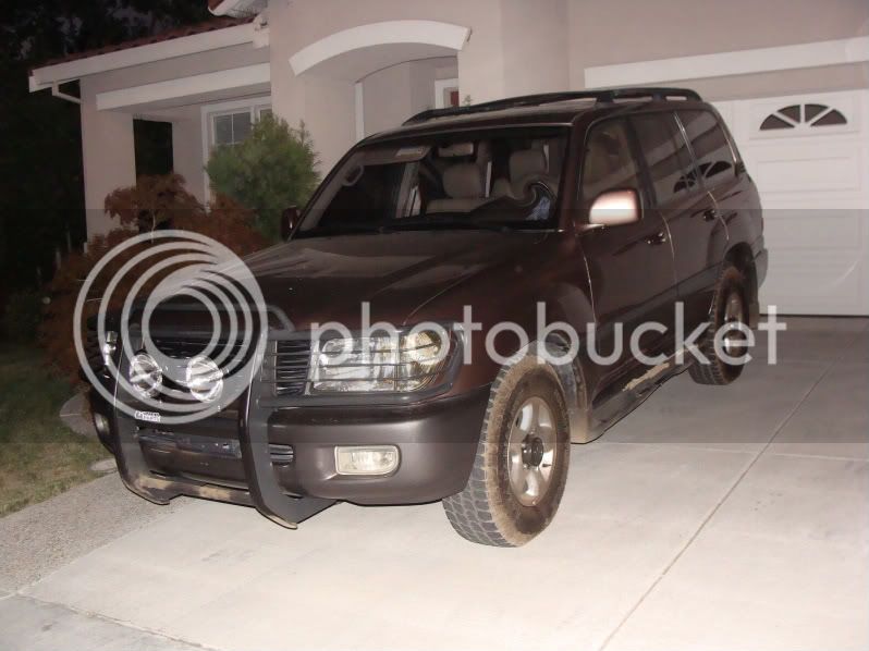

Don't laugh, but I had a brush guard for a little bit
I am kinda mad that 4runner and 80 series bumpers, sliders, etc are way cheaper than parts for the 100 series. But I do not regret getting the 100 series and adding to it, Jus cant replace the V8:flipoff2:
