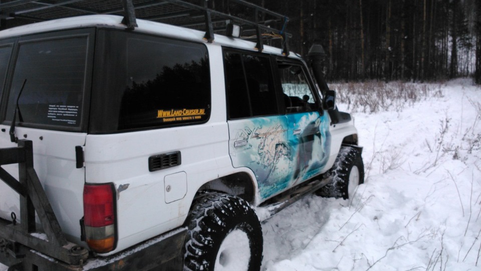

the same swap (click auto-translation for English)
