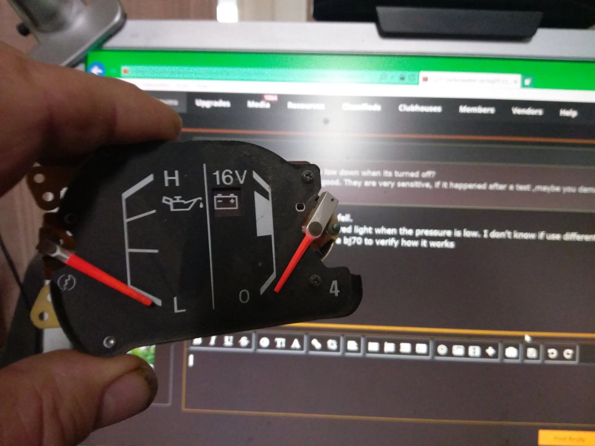

When they are good they look like this. If you have shorted the wires, they die very quickly.
Do you have an LJ71 or BJ70?
