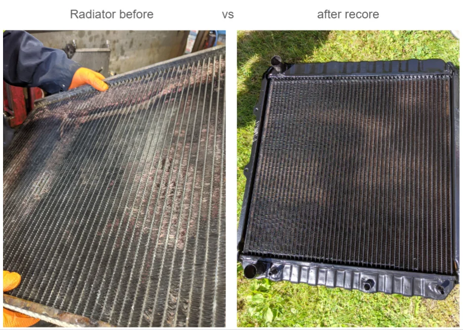

    • Radiator: Re-cored (it was ugly; before/after photo for entertainment below.) It does sit behind the A/C but surely it's not airflow that's the problem at this point.

Our rad before vs. after because I always enjoy seeing folks' horror pics on here. (Fins crumbled with a slight touch and there was coolant leakage at the seams too.)

How thick was your radiator re-cored to? That has a really big impact on the cooling. I ran a 48mm for a while and it sucked big time compared to a 56mm I had before. I've now re-cored it to 64mm.
