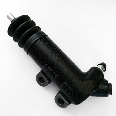

The slave cylinder is bolted under the vehicle. You have to crawl under to see it well. On my vehicle, the clutch slave is on the left side (sitting facing forward)
It has one rubber hose going into it, less than 1cm in diameter.
The hose looks like this: It might be dirty and wet.
Slave looks like this but it will be dirty and maybe wet with fluid.
well there are only three places it can leak from, the master, slave and the line between them. If you refill it you will need to bleed it, not simply just pump it up. the bleeder valve is on the slave. If you refill you should be able to find where it is leaking from but I still deal with the master and slave as one unit when replacing rather than two individual pieces. YMMV

Yes, the black disc is a float. And as the others said, the clutch hydraulics is a sealed system. If the fluid is low, there is a leak somewhere. They don't "use" any fluid.
I just had this issue on my LJ70 after a clutch replacement. The slave cylinder was leaking but keeping the fluid inside the boot. When it was cold, it wouldn't work at all but once warmed up it worked like new. Replace the slave cylinder and you will be good to go.
Looks like you have a power booster on your clutch.Is the slave cylinder(one that pushes the clutch fork on trans) wet or leaking? If not your master (one on firewall attached to booster) is bad and instead of leaking into the cabin and floor it's filling your booster which is not good since it will ruin the booster if left in fixed..my 2c
