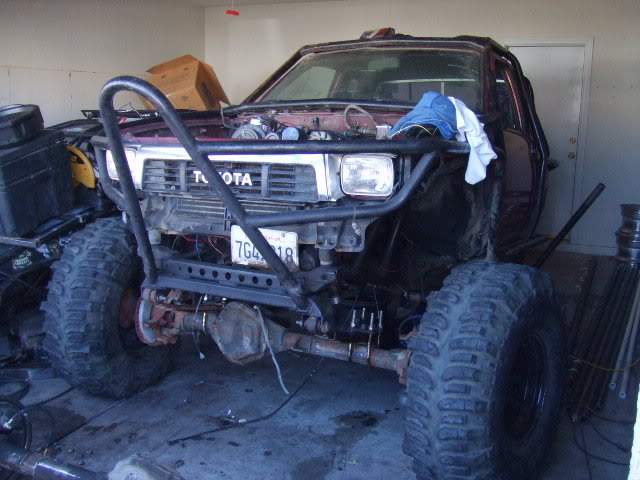

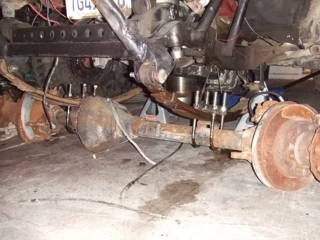

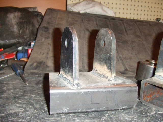

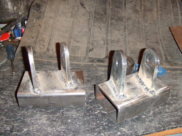

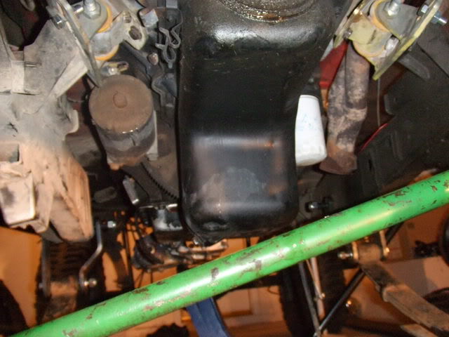

Some updates for you all. Here's some pics of the rear tubework
I'll have the rear axle sitting about where it is when I'm done

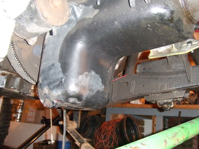

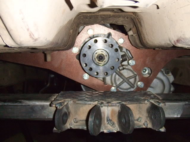

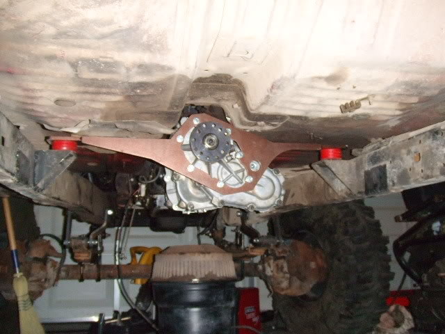

Under the motor

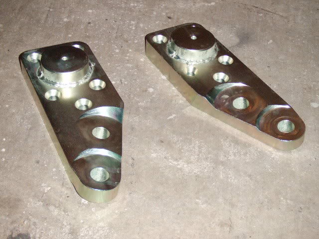

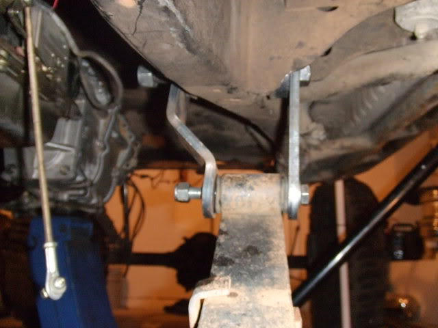

Sky's offset shackles

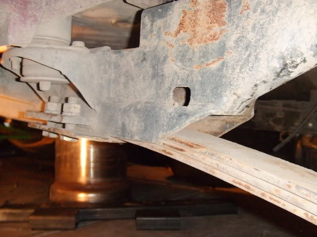

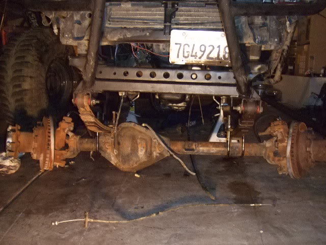

It's hard to tell from the picture, are the springs actually going into the frame?
yeah the 1/4 ellips are going into the frame. The frame was notched at the bottom and capped with a bucket to put the 1/4 ellips in.

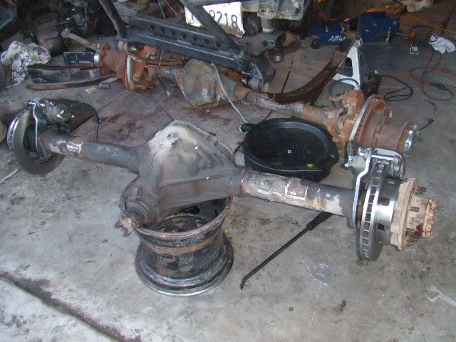

It'll have a 60 front. And I have another 14 bolt with 4.56 and a detroit i'm putting in. I'm also having the axle out to grind all the existing brackets off and then start the truss and wel the link mounts on.
Some updates over the weekend. Put the discs on the 14 bolt. Going to start The link truss today. They clear 15" wheels. I can't remember what kit it is but I'm using ruff stuff bent brackets.

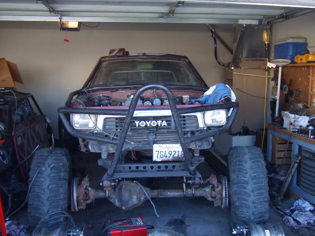

mounted the 60 all the way. Mounted some 38's. Still haven't gotten the single wheel hubs.

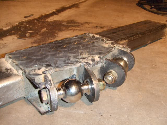

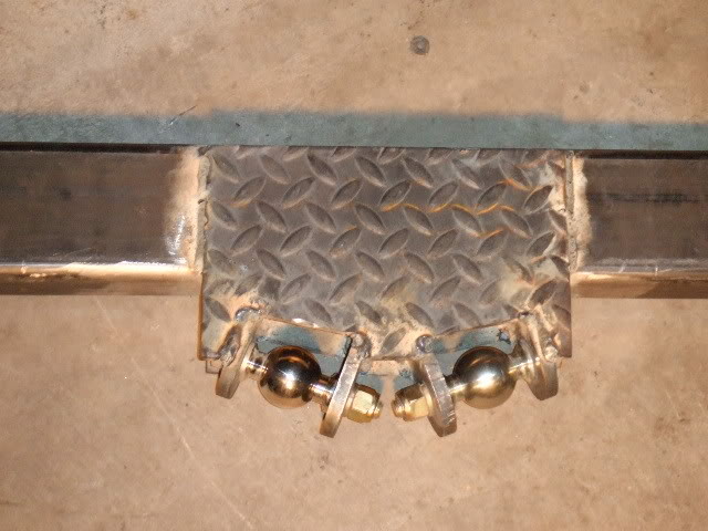

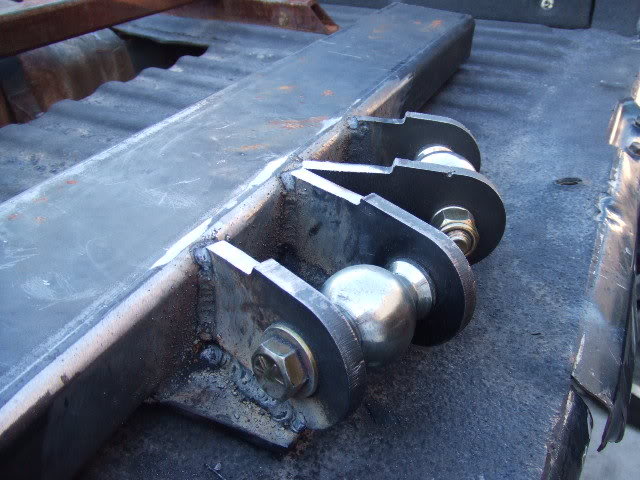

Upper frame link mounts. STill going to beef them up a little more.
Lower link crossmember in.

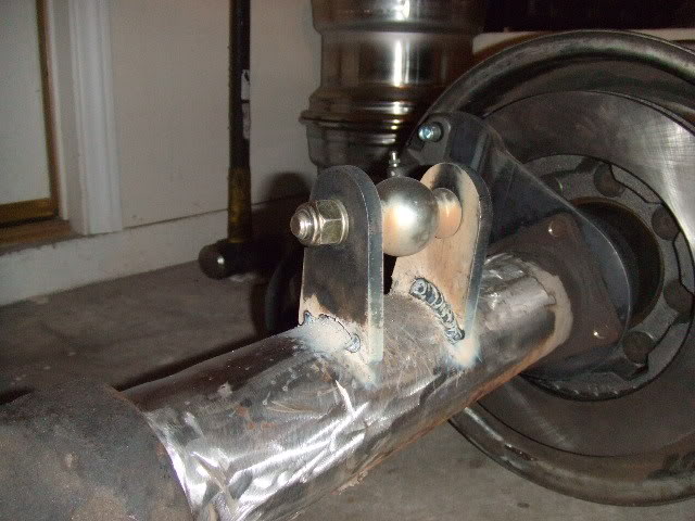

Started the axle lower link brackets.

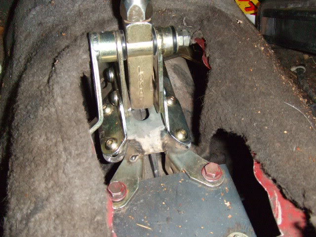

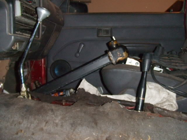

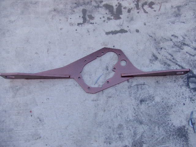

Got the lokar shifter in after modifying it a little. And the 2nd case shifter. I still need to get a shifter for the crawl box
Why did you choose the lokar shifter? reason I ask is because I have a th350 in my mini with a hurst (i think) shifter, tranny has a shift kit, but the shifter seems to be installed "backwards" and the action is mysterious... it is a ratchet shifter type. I am looking for a better option...
looking good overall man!
I actually got the shifter when I bought the tranny. It was included in the deal so thats why I am running it. Good observation on the pattern of that. I need to flop the pattern. I have been looking at other shifters so there's nothing out of the question yet. Also think about throwing a reverse manual valve body in it. I don't know yet.
