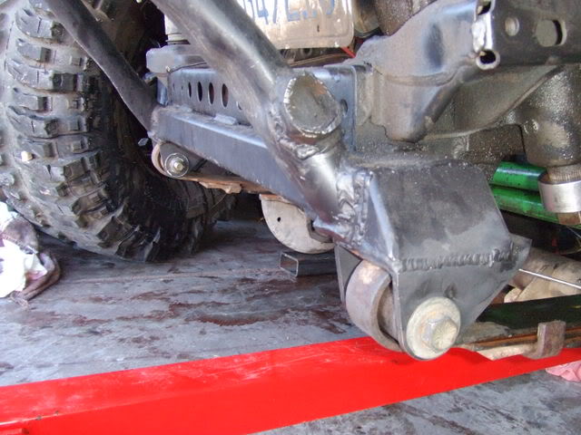

Well it looks like I'll be in a mad dash to get my rig going now that my bro's is done. I need it done by the first weedend of november. I picked up booger weldz old chassis a while. here's some pics of it when we loaded it on the trailer. with some axles and rollers.... even though they are 38's
and one when I got it home
I'll be swapping in a 4.3-th350 and either a dana 300 or dual toy cases or something. I haven't made up my mind.
The suspension will be toy rears front. possibly 51" rears. depends on how far forward I want to go and 1/4 ellips in the rear using 57" fords cut in half using the long side. the shackles have felx joints in them. with a dual triangulated 4 link. Here's a pic of the rear axle. with my 14 bolt truss and pinion guard on it. not sure if i'm using it yet
I should have some soon. I gotta get some more spring hangers fron ruffstuffspecialties.com and redo the front spring hanger. I also have a lead on a complete drive train. it's a 4.3-th350-and a single toy case. but if I pick this up i'll be adding dual cases. hopefully the guy is interested in shipping it to me.
