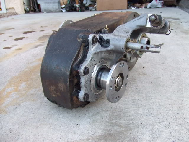

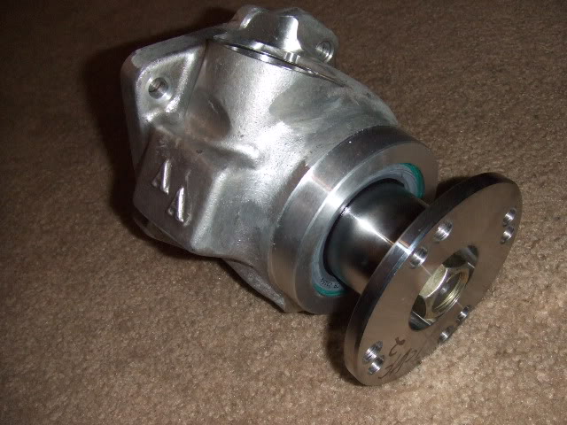

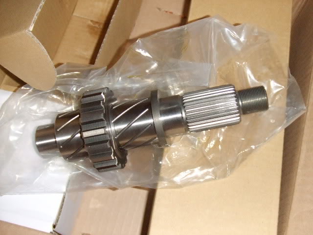

Here's some updates finally. Got my 32 spline front and rear outputs. twin stick stuff. CPI harness and computer. greatlakes 14 bolt cover.

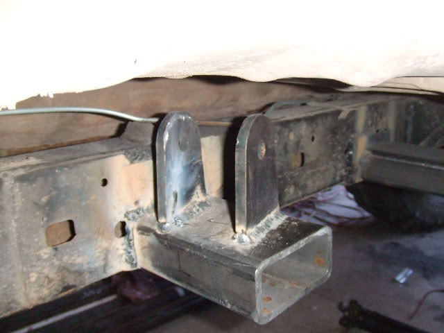

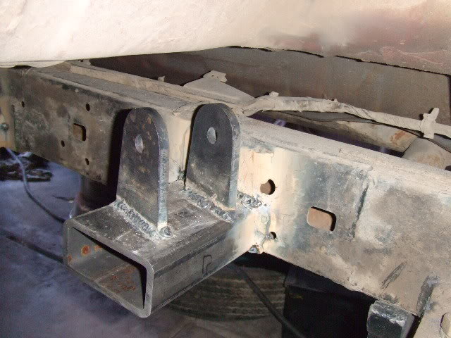

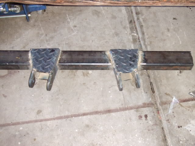

Had to redo the lower link crossmember

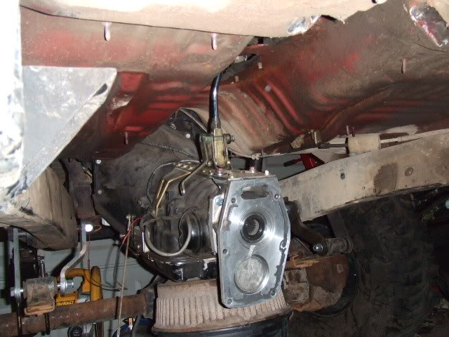

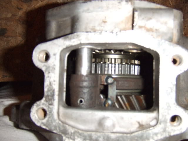

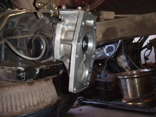

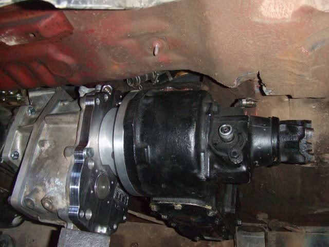

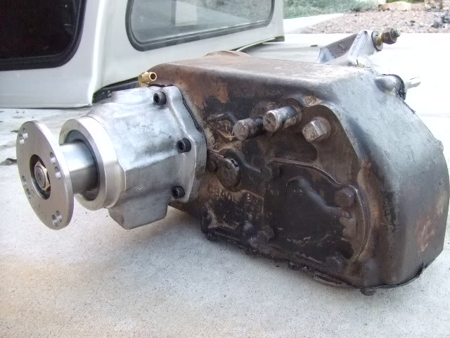

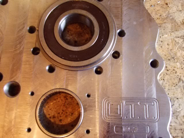

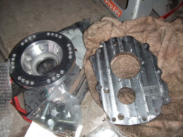

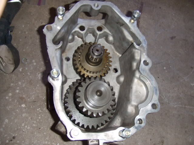

toy-dana 300 doubler up for mock up.
been working on my little brother matt's jeep Here's some other crap I got in for it.

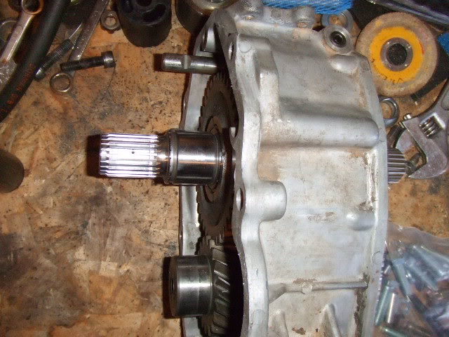

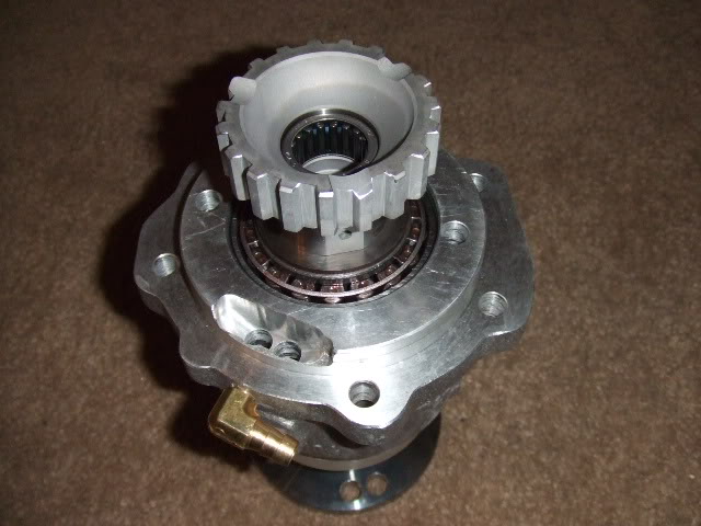

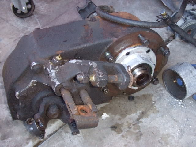

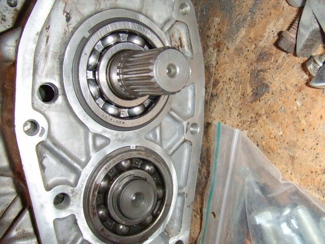

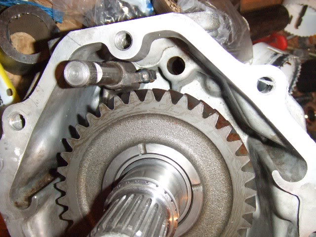

32 spline front output for the dana 300

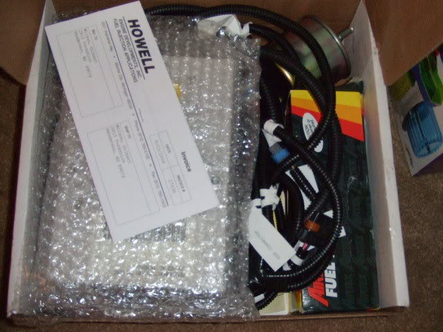

cpi 4.3 harness and comp

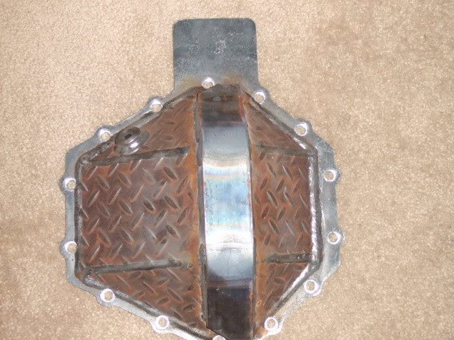

great lakes cover. Thick stuff

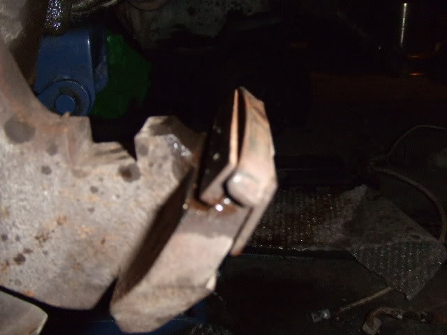

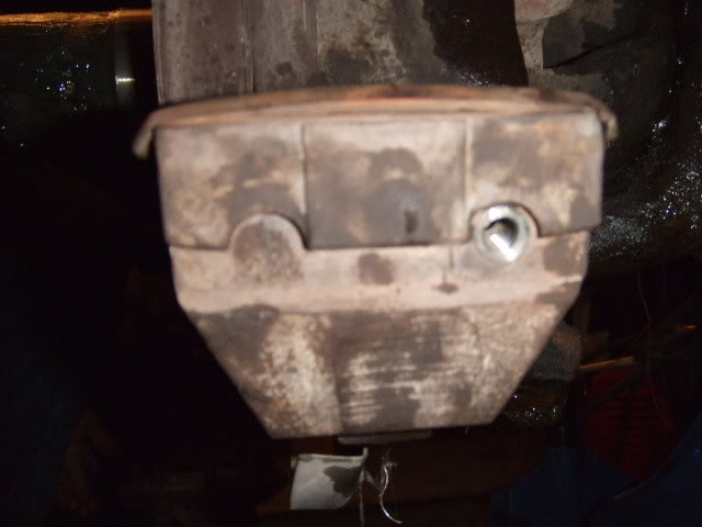

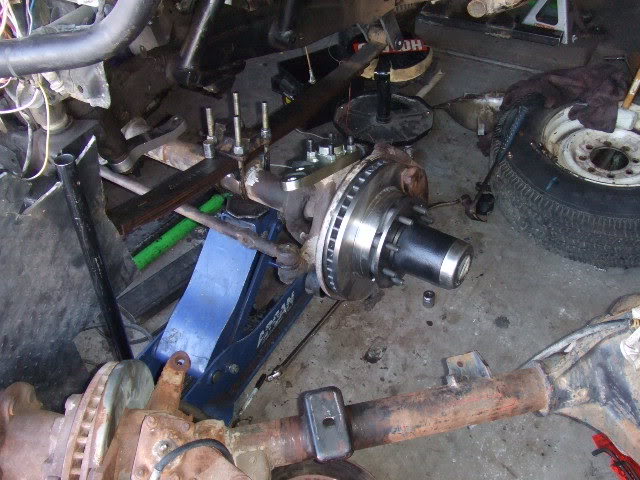

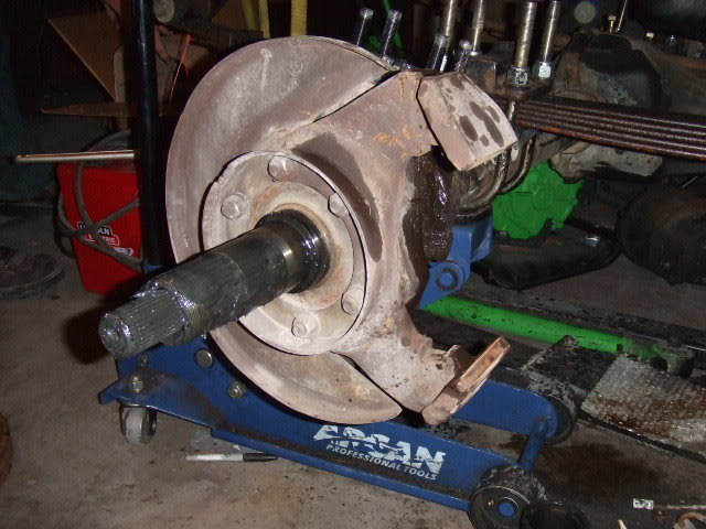

Started to take the 60 apart. Don't forget to hit the pin out on the bottom side of the caliper to get the caliper off. Don't just hit the damn thing for an hour thinking what the hell am I missing.
and then once you get it off it looks like this in no time. Just a 100 pound rotor and hub.

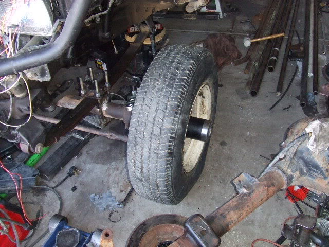

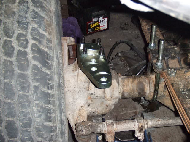

Got the single wheel done and the high steer arms on. Oh and you can see the extra Chevy 60 I keep tripping over there too. :mrgreen:
And the new bling wheel and tire combo

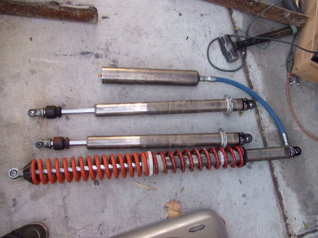

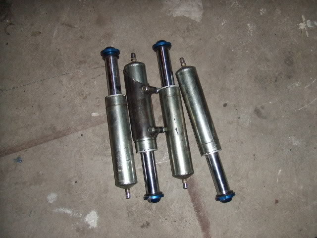

Picked up 2 sets of 17" Bilstein coilovers. $600 for all 4. 2 are emulsion with dual rate and 2 are resevoir with dual rate and coils.
Also picked up four 4" fox bumps with cans for $200

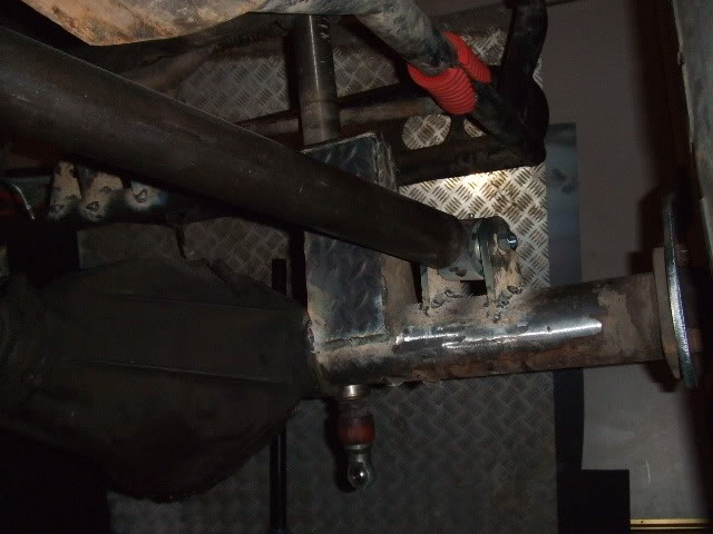

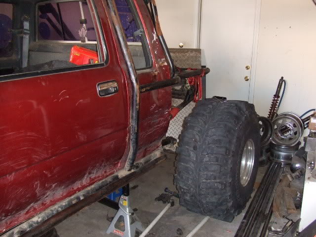

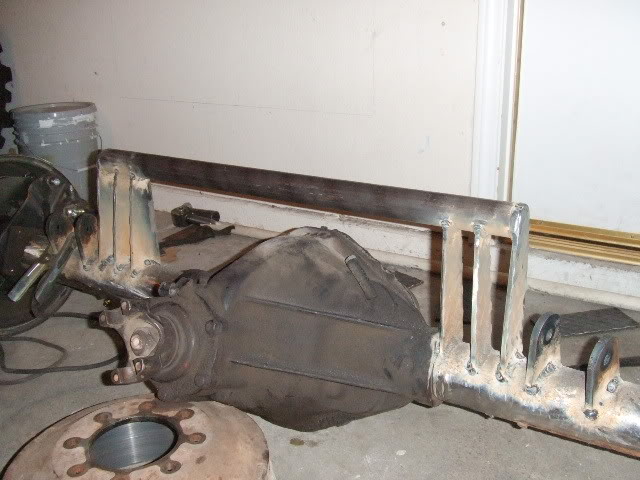

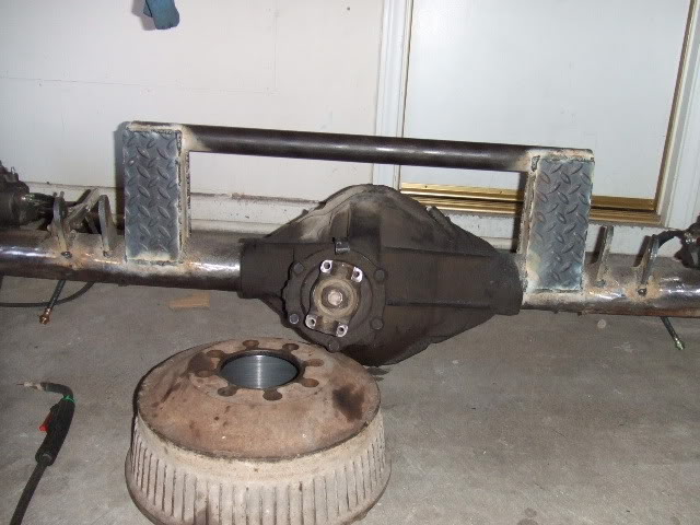

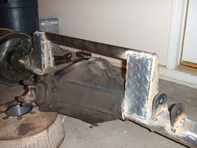

Completed most of the truss. just going to add some braces and also tie the truss the the pinion bolt things and probably make my own pinion guard.

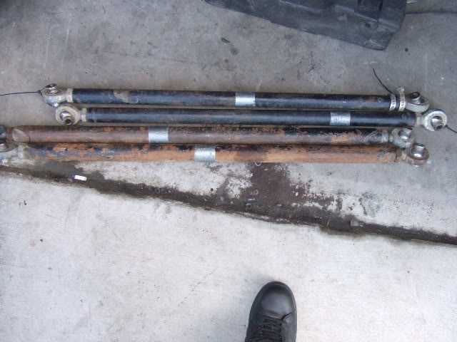

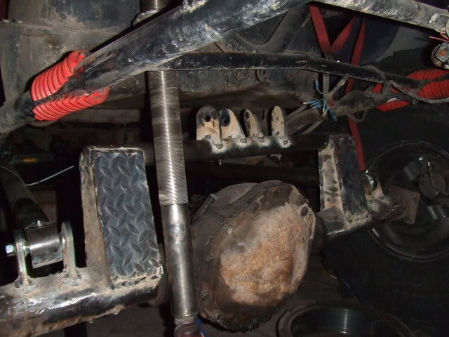

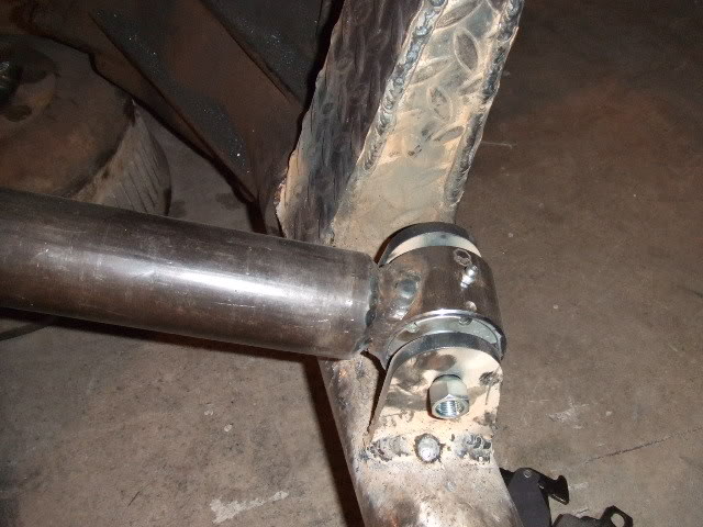

Made the lower links. 1.75 DOM .250 wall sleeved with 2.25 DOM .250 wall with Ballistic joints at each end

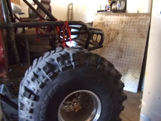

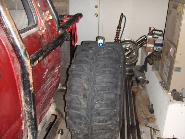

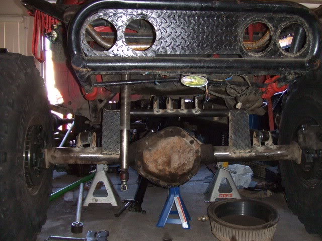

The last pic I have for tonight is the 44 boggers I put on the rear. It's at full bump right now. Test fitting coilovers and everything else.
