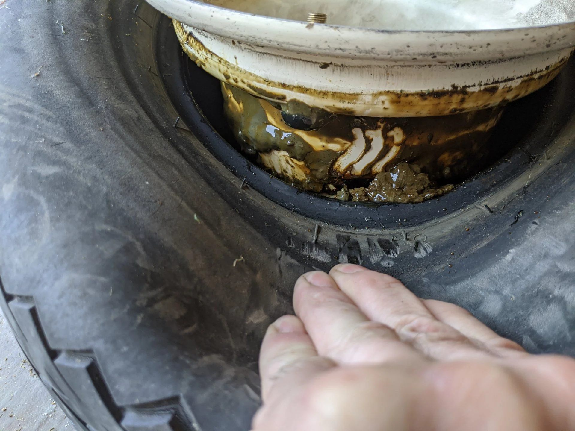

If so it is to be used as a last resort. That stuff is nasty and creates a huge mess when it comes time to remove the old tire and put a new one on. Basically ruins the valve stem as well. That said, I do carry a can of it in my DD Avalon in the event of a second flat since I work in a very remote area hundreds of miles away from home.
For the cruiser I would recommend a good tire plug kit. Generally if a can of fix-a-flat can fix it, so can a plug kit.
Definitely go with a plug kit as primary repair.
As mentioned fix-a-flat is LAST RESORT.
Using fix a flat ruins your tire, and if not removed promptly, your wheel too.
