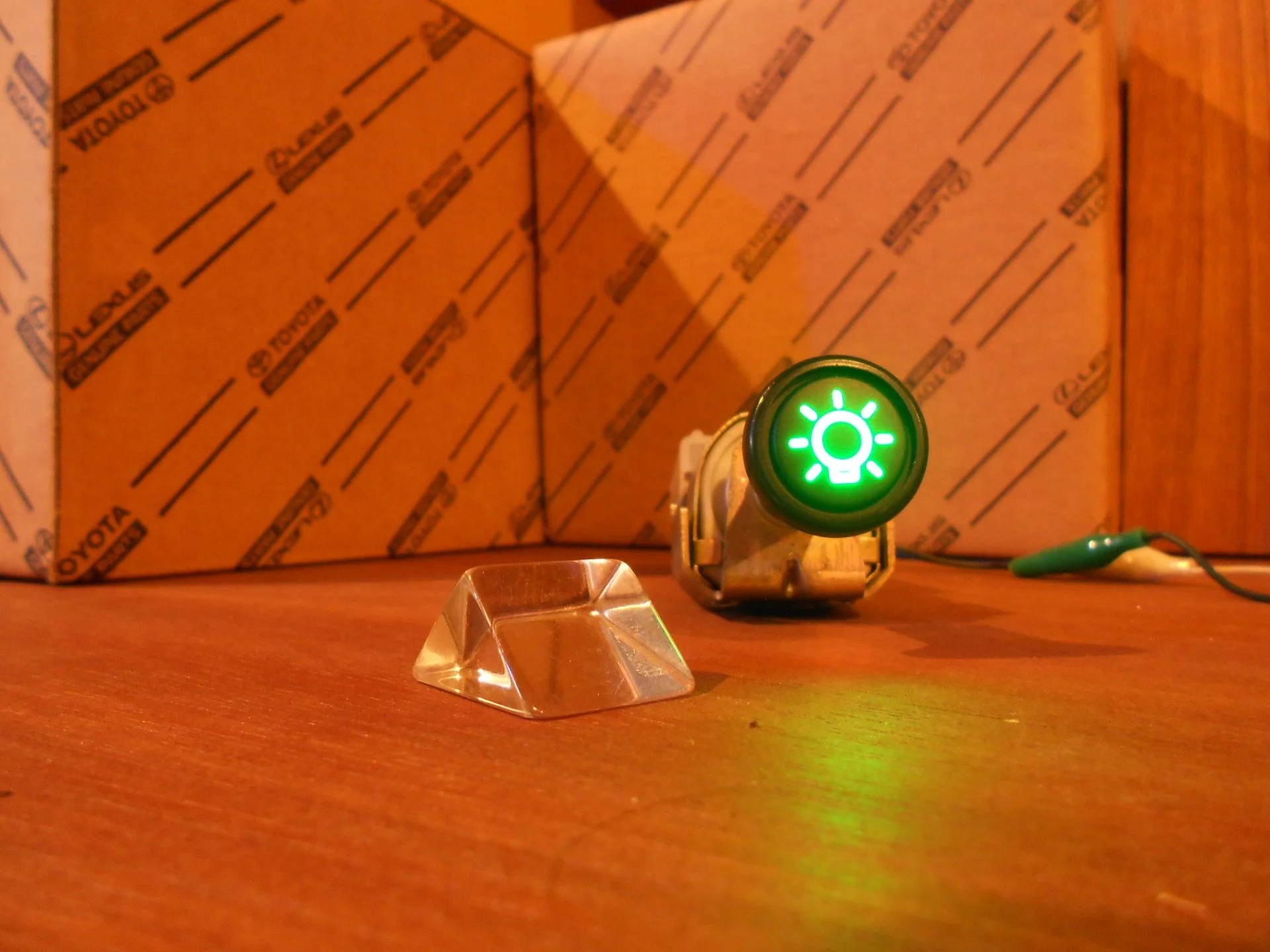

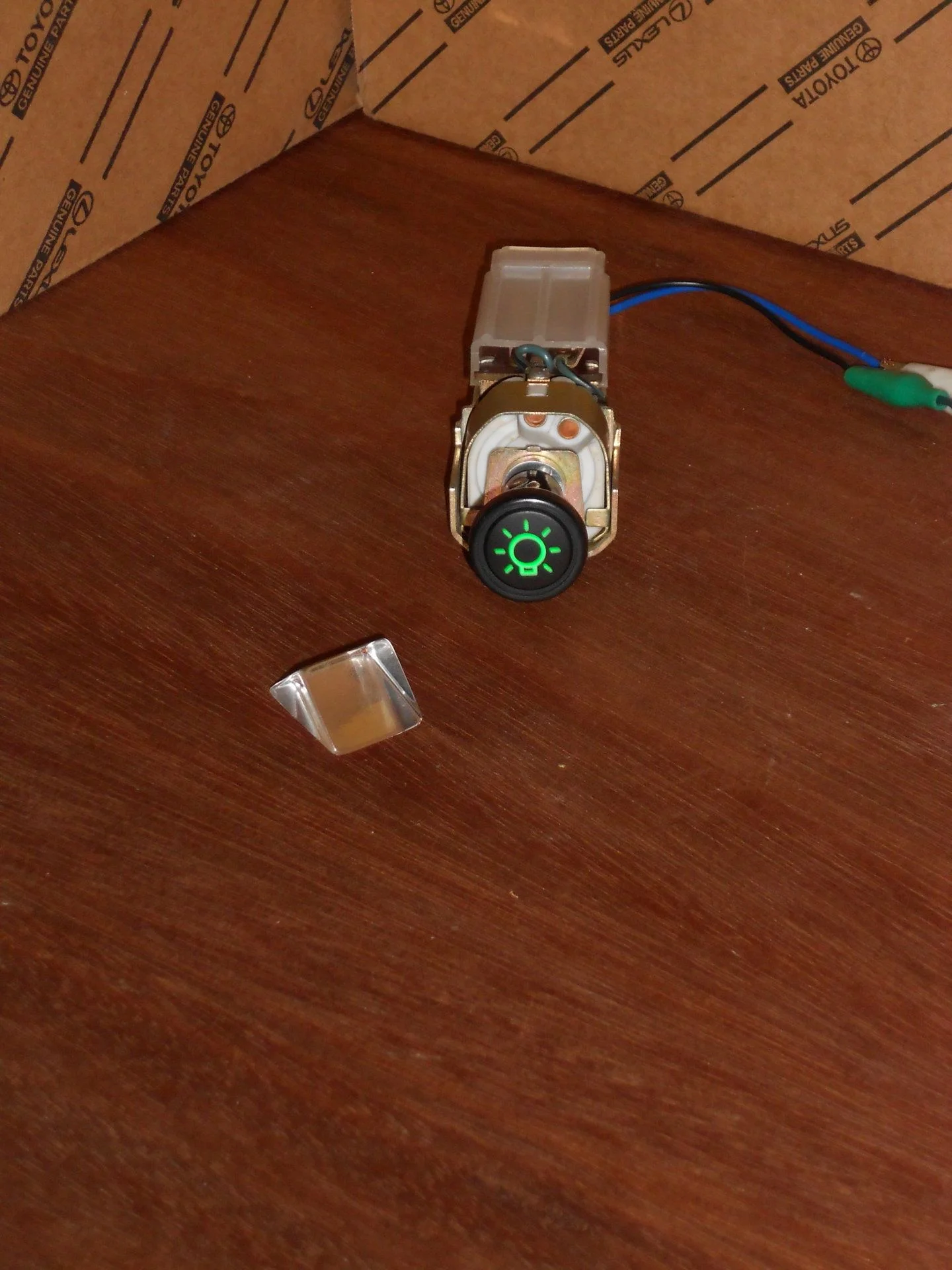

Yes it will fit a USA spec headlight switch with a dimmer Lit knob socket as @Not A CJ CJ was looking for ,
shop job client I am doing now , ALL 100% OEM Toyota Parts ( except the LED Bulbs )
- OEM green Int. illumination , like dash like and heater control one on triangle bracket
- Blue was a good choice for cluster , it REALLY Pops the cluster Black Backgrounds out !
- Fully polarized so the dimmer rheostat Dims down all LED bulbs
Just completed a batch of these :
- OEM TOYOTA Lighted knob Head Light's ( No Dimmer )
- Fully Polarized During Refurbish For ...LED equipped OEM Green Tone Bulb
- New OEM Toyota parts Service Connector W/ FJ40 FJ55 75-84 Color Coded OEM tracer stripe Leeds / wire

I can’t exactly tell...but I think I have an old, broken remnant of a headlight switch bulb in my housing like yours pictured...is that possible.? They don’t screw in...do they twist in the holder.?? Thanks...new 40 owner.
Yep, push in and twist.
I've been rebuilding my harness and I just soldered this light socket in to the harness connector. Mine had a short at the light switch and melted the connector.
The piece I would like to source is the fiber optic shaft in the center of the switch. They get cloudy and quite fragile after 40 years or so.
