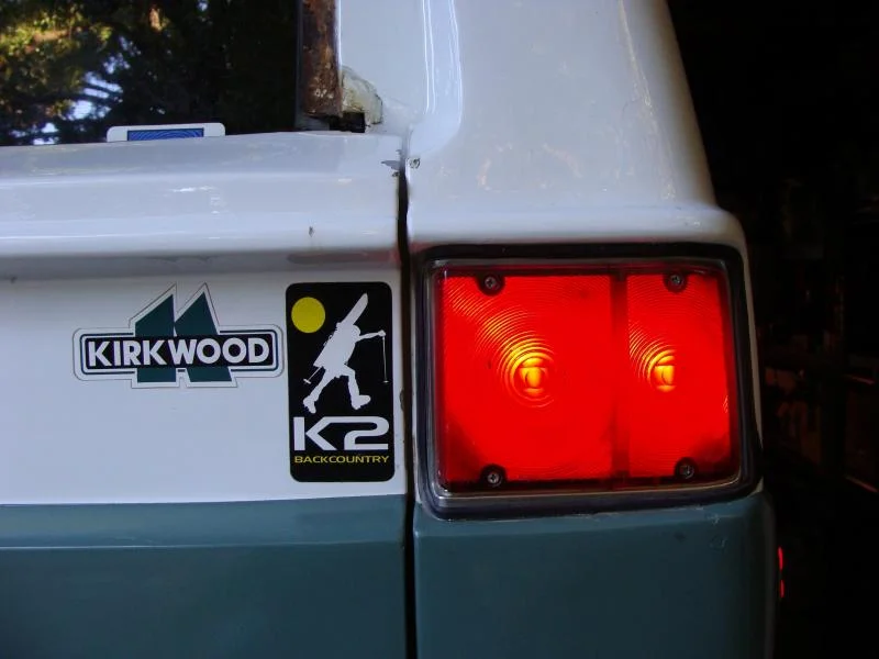

The reason the dimmer red LEDS in the side marker lights actually look brighter is due to the fact that White LEDS actually put out a lot of BLUE light which the red lense filters out very effectively.
Yes I know and I alluded to that above.
The white ones put out more total light than the red or amber of course. I was interested to see whether this or the filter function of the lens was the greater effect.
Through the amber lens the white bulbs are much brighter than amber bulbs but through the red lens the red bulbs are much brighter than white bulbs.
I suspect the red lens is a more narrow band filter and more closely matched to the red LED's output spectrum compared to the amber lens and amber LED. Also the difference in total output between the amber and white LEDs is much larger, i.e. amber LEDs are pretty dim in general. I won't be buying any more amber LEDs.

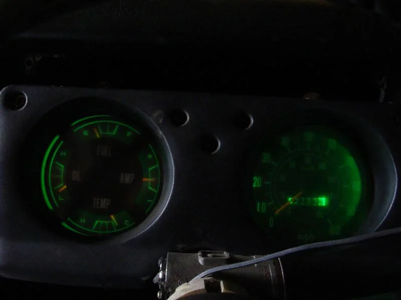

Instruments, incandescent:
Instruments, LED (WLED-6 in white, blue, and green)
FAIL: general illumination of gauges. I think this is due to my choice of LED bulb specifically, they don't have enough side illumination. Also I did not remove the shrouds.
WIN: the high beam indicator. I can barely tell when it's on with the factory bulb, now it's nice and bright. In this case the bulb is directly behind the blue lens so the LEDs are shining straight through it.

I got some brighter LEDs with a 360° pattern that work really well, much better than the factory or the CCOT incandescent bulbs. Each bulb has 5 high power SMD emitters. I used cool white. The green would work well too I think.
High Power SMD WLED-xHP5 (194 type) 360 degree Wedge Base bulbs Specifications

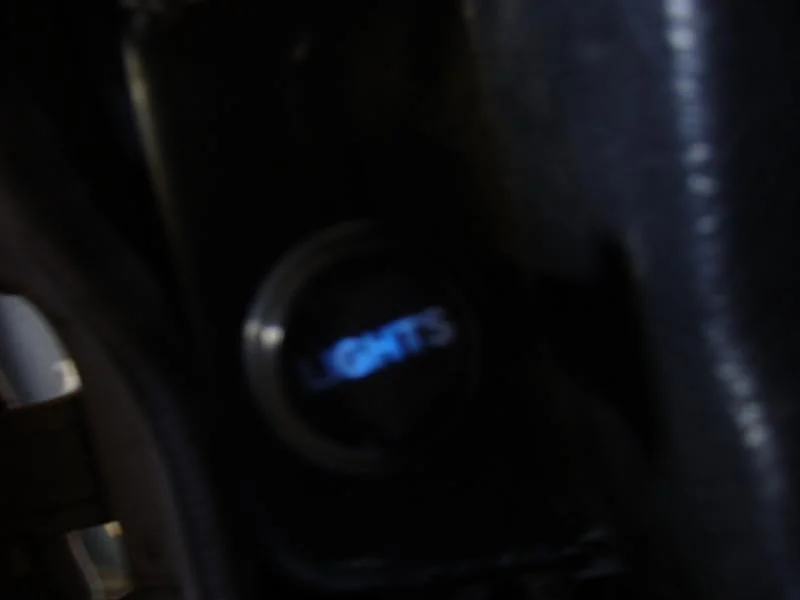

Kind of pointless, but here's the blue:
The dramatic one was the dash light, which I never even knew was there.

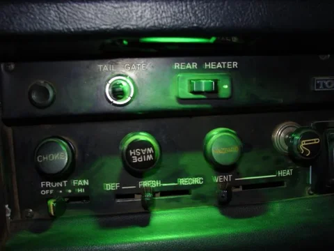

I changed out all the interior lights in the Lesbaru, too.

Instrument cluster. I used WLED-6G, which BARELY fits in the holes. Velly nice.
