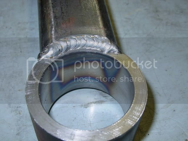

I was of the same opinion until I purchaesd a 110 volt Hobart 140 and got surprising results. That is 5/16 wall tube and it penetrated really well. It does a good job on the thinner frame material as well. :cheers:
Thats actually really nice penetration- The 110 Hobart we have has cautions on its use for metal above 3/16's.
