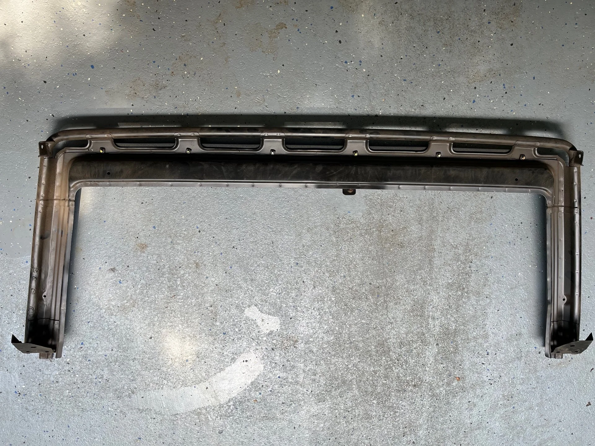

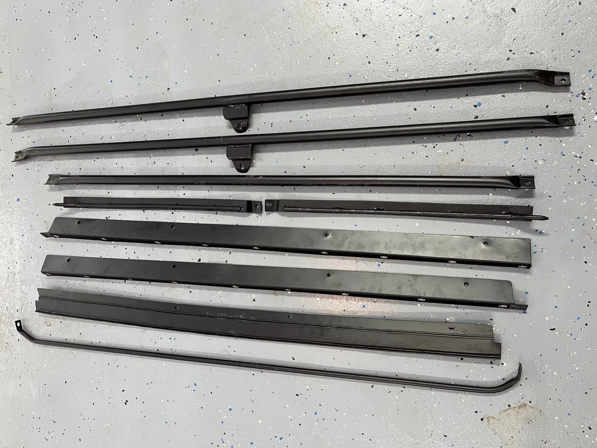

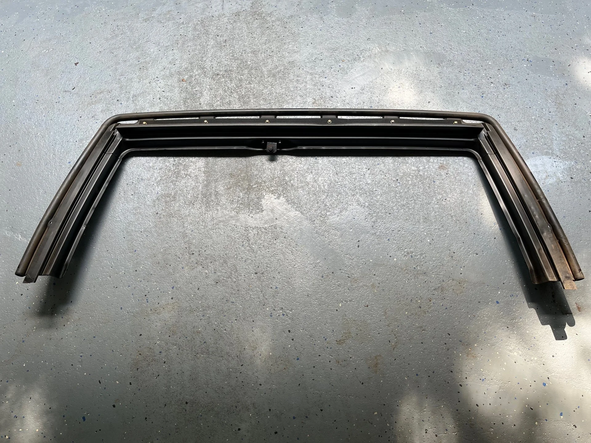

I received my soft top and bows from @4060seriesnut a week or two back and finally have had some time to unpack it and sort through it a bit. The quality looks to be first rate and it was delivered as promised and actually a good bit ahead of schedule. Very pleased.
My only "issue" so far is no instructions. If someone could link me to a thread on installing one of these, I'd appreciate it. I can't find one but I'm old and dumb.
Failing that, I need some advice from those who have removed their hard tops. The soft top comes with no hardware. How confident would you be based on this pile of parts that this all bolts on with factory hard top hardware?
Thanks!
TJK
I believe @FJBen installed the same top. You can probably find some info in his build thread starting here:
Or perhaps he'll chime in and can lend a hand.
On a quick trip I’ll respond shortly with my thoughts but yes in my thread it goes over most of it.
I would just get all new hardware and keep your hard top stuff together.
That's good advice - thank you. I'll take the hard top set down to my friends at Asheville Bolt and have them duplicate it.
Your thread is excellent too - thank you!
Thanks!
You might wait on that and see if you want it that way. The bolts aren’t the same, or length or amount you need.
The windshield needs short nuts/bolts
The sides in the rear need nuts/bolts, 4 each side
If you have above front doors you can use same bolts
Framing in back and across the top needs nuts bolts
I haven’t put the side piece that in that goes by the roll bar but that will need a really short setup. Most of it is finding right length and orientation but it’s pretty easy.
It will take some bending and possibly shaping cutting elongating of holes to fit right
