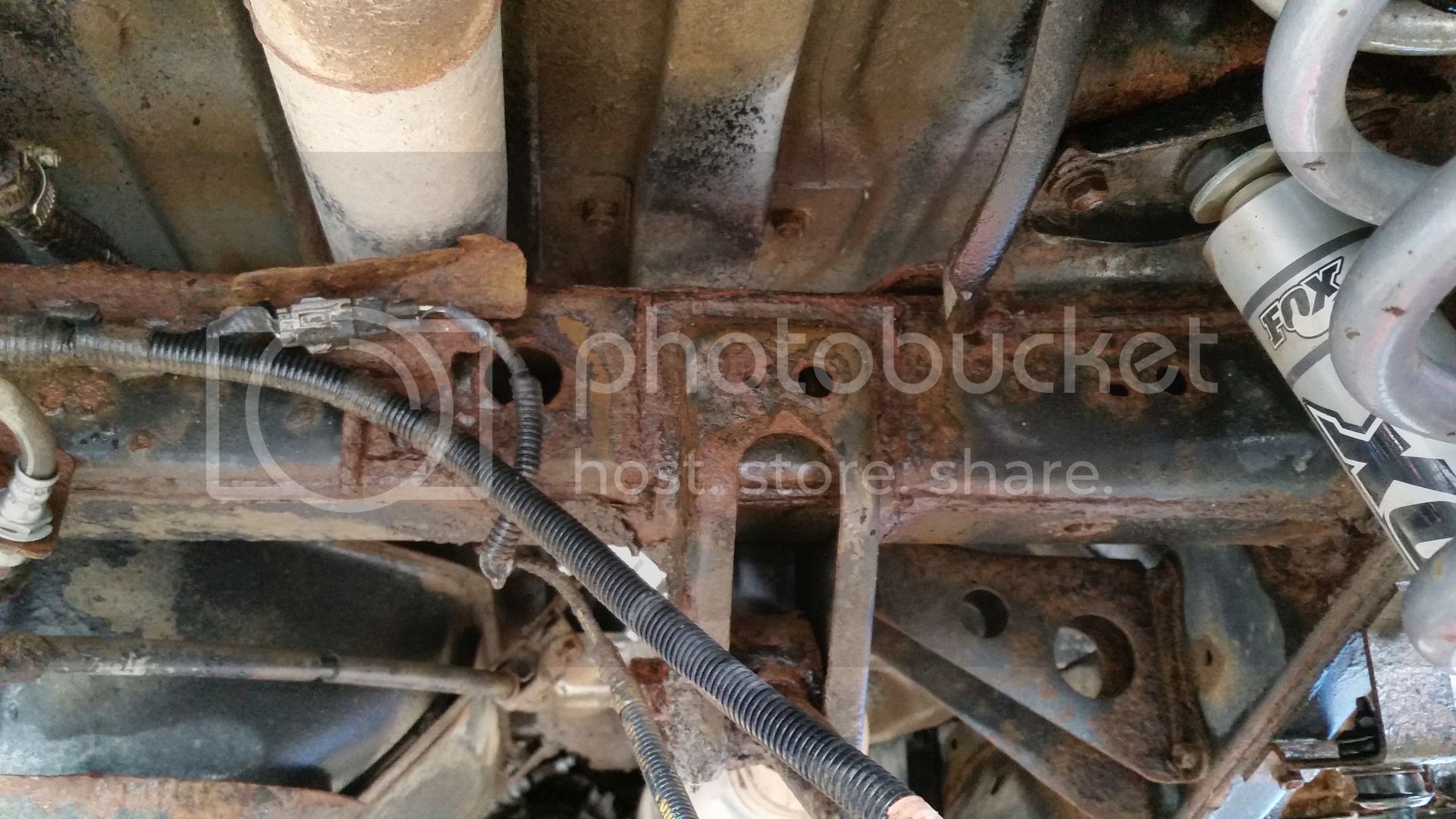

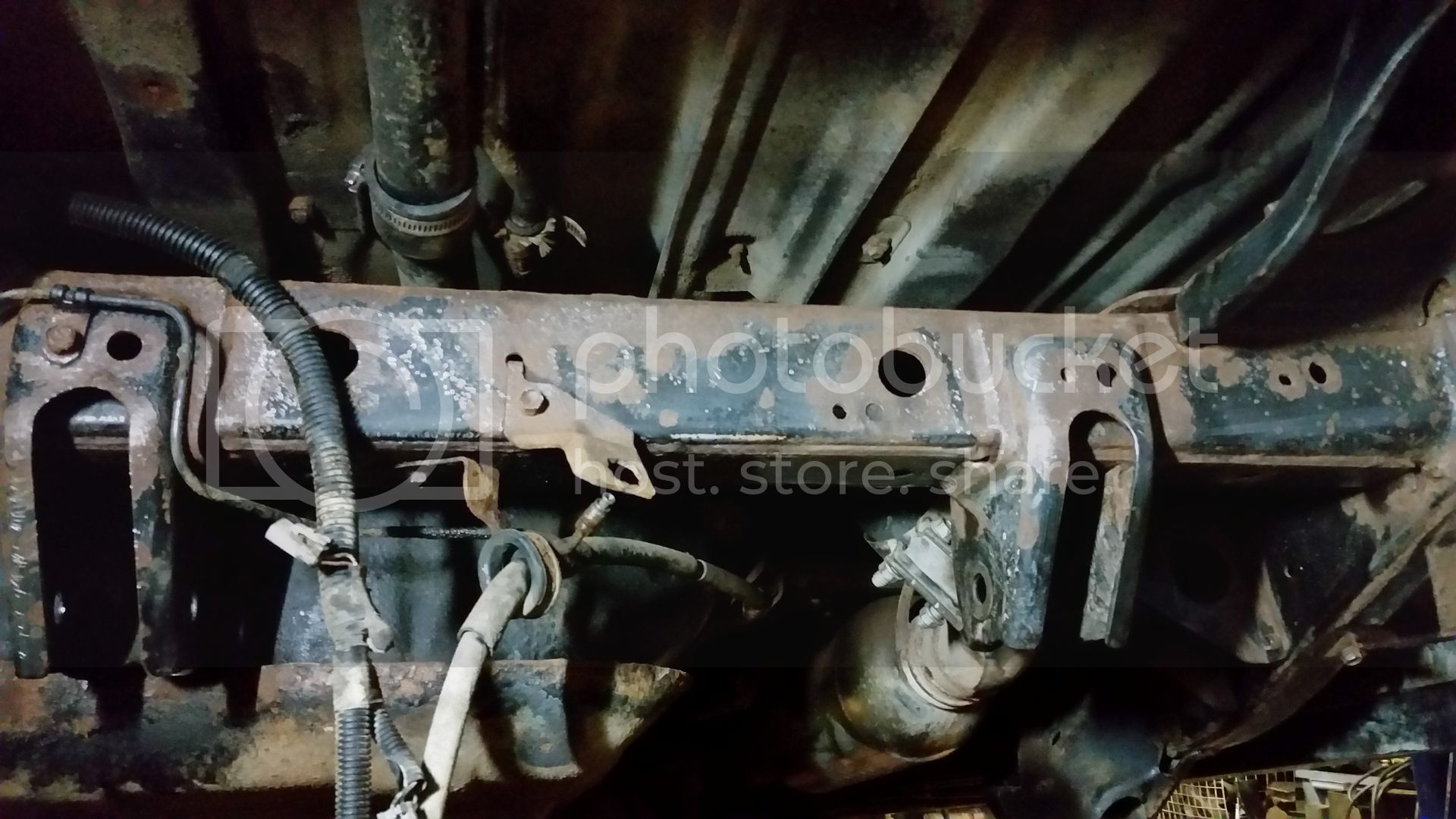

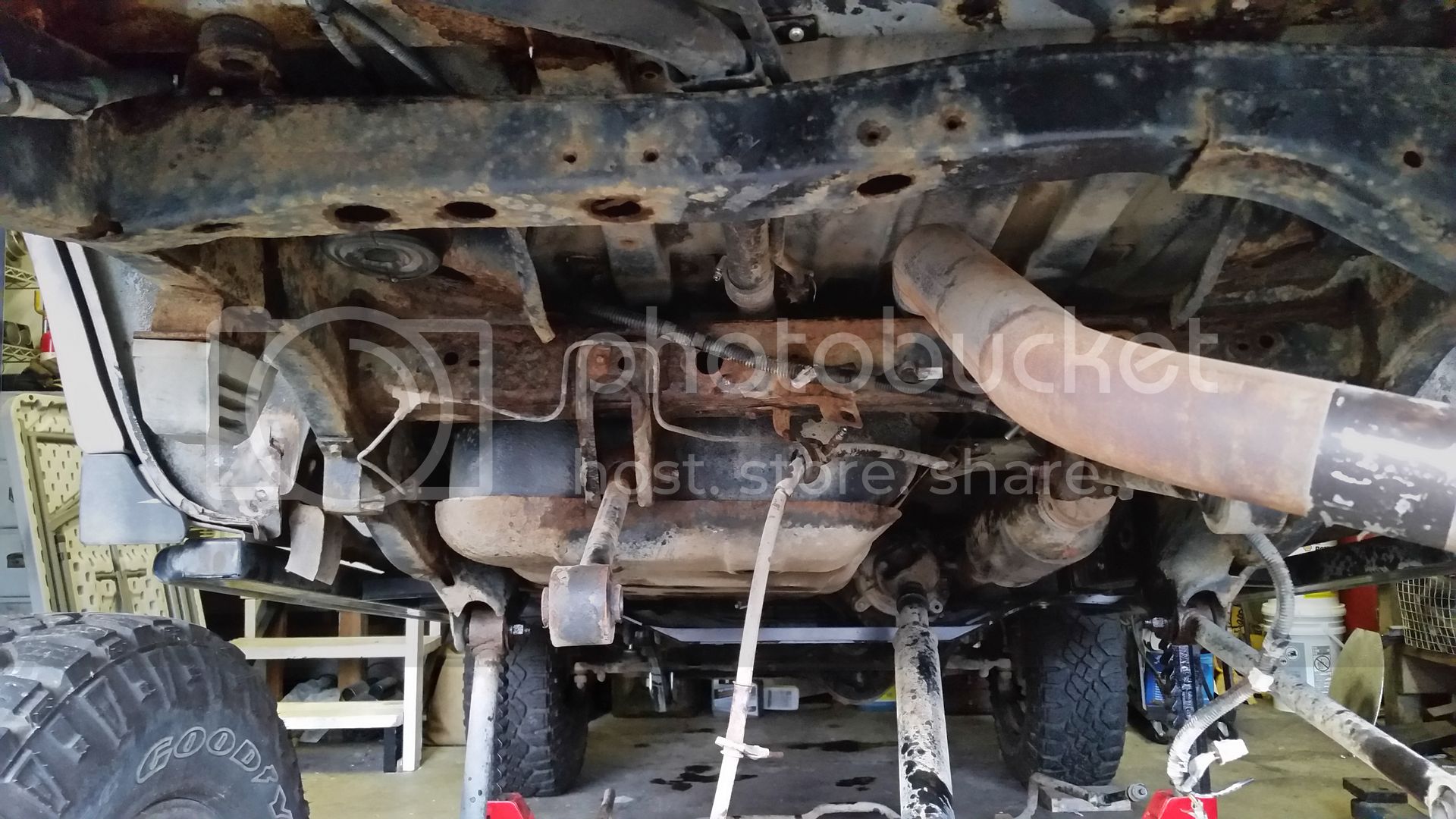

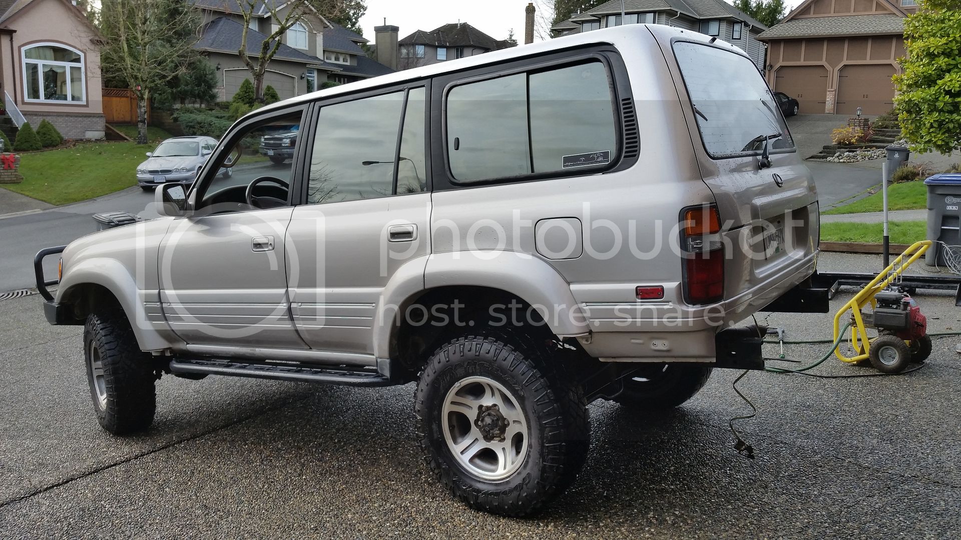

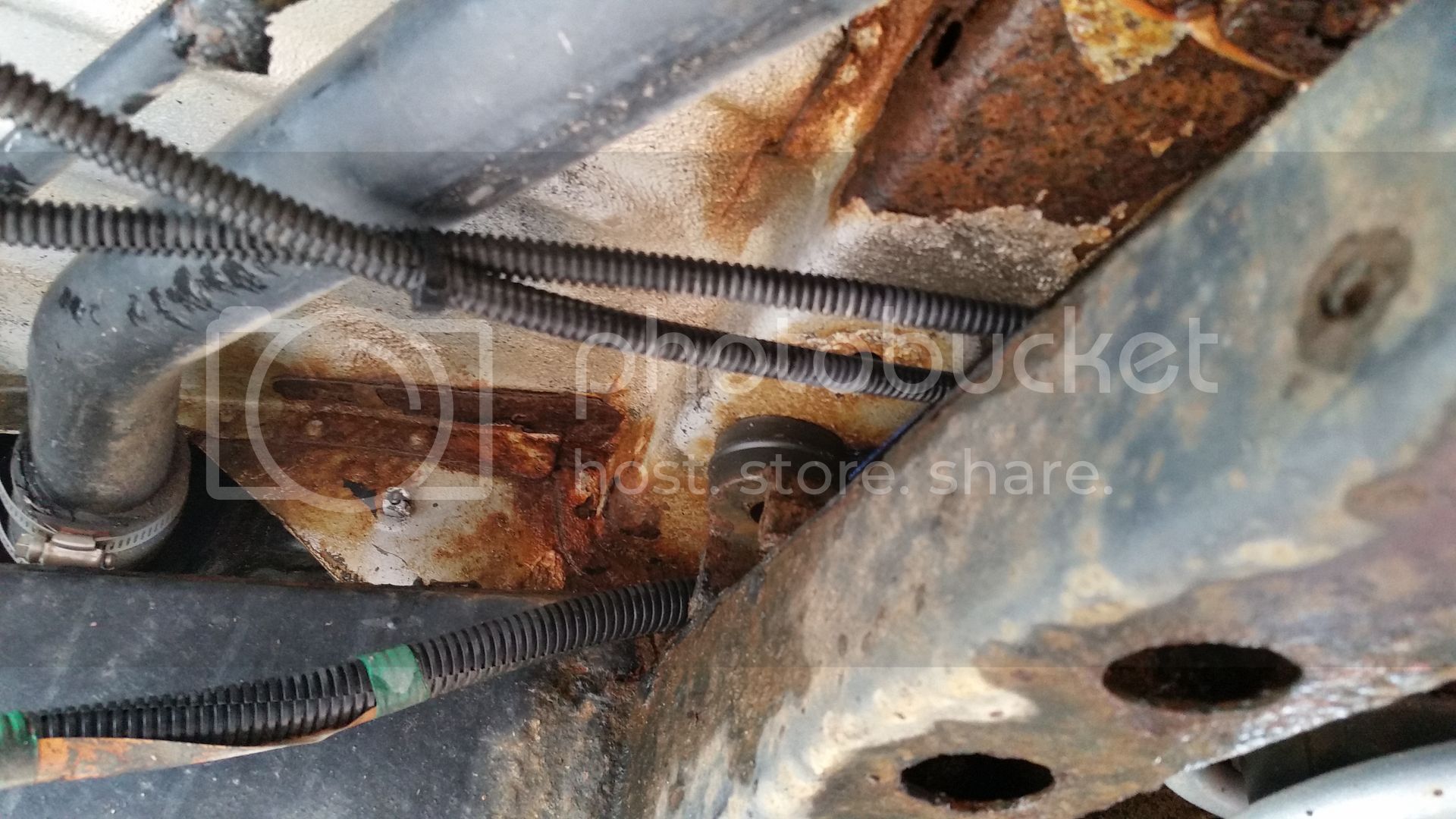

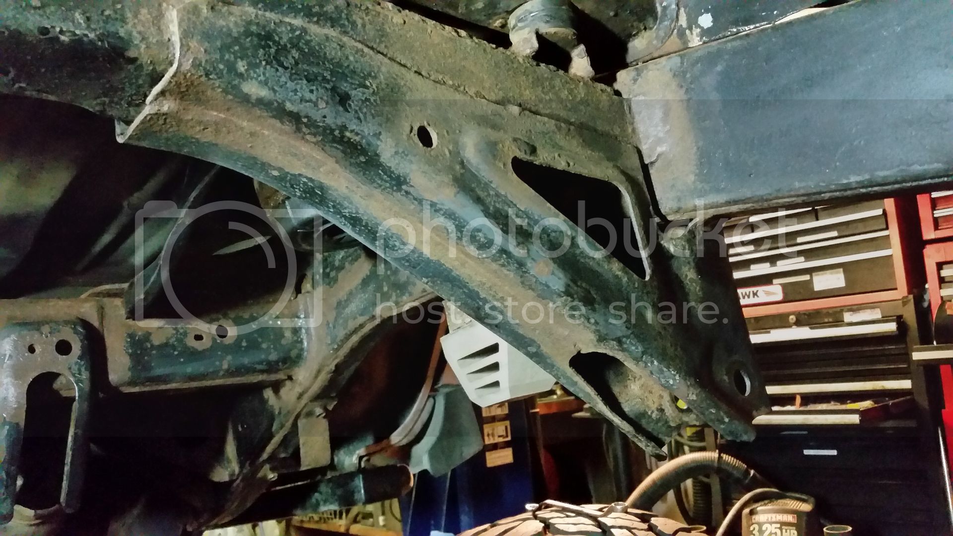

Started taking the back of the truck apart today. I soaked the underside down with Simple Green then took a pressure washer to everything. Made a dent but still have a lot to do.

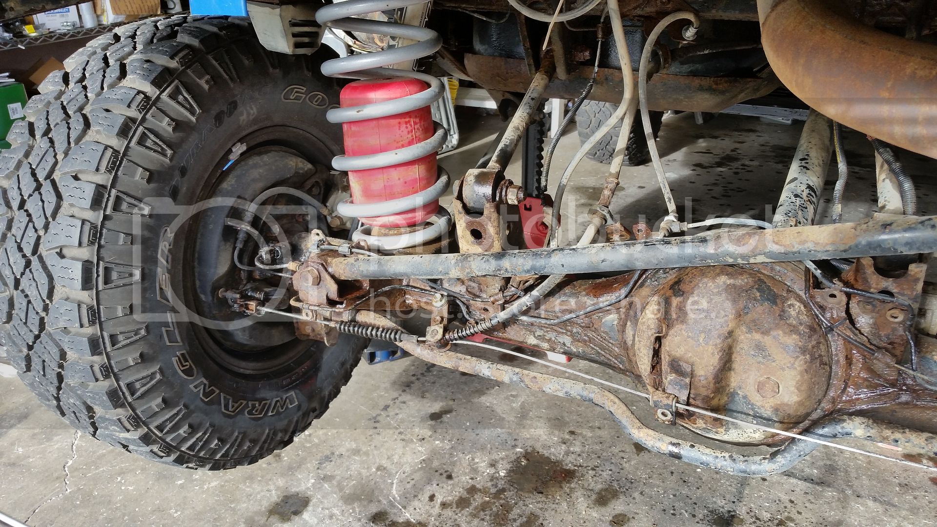

Reason for the newer rust free rear axle, I'm not sure how much material is left on the pumpkin. There was 1/4" of rust scale.

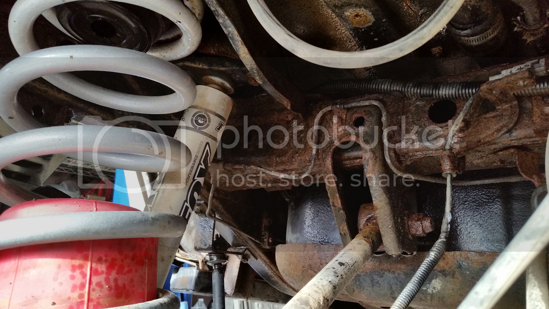

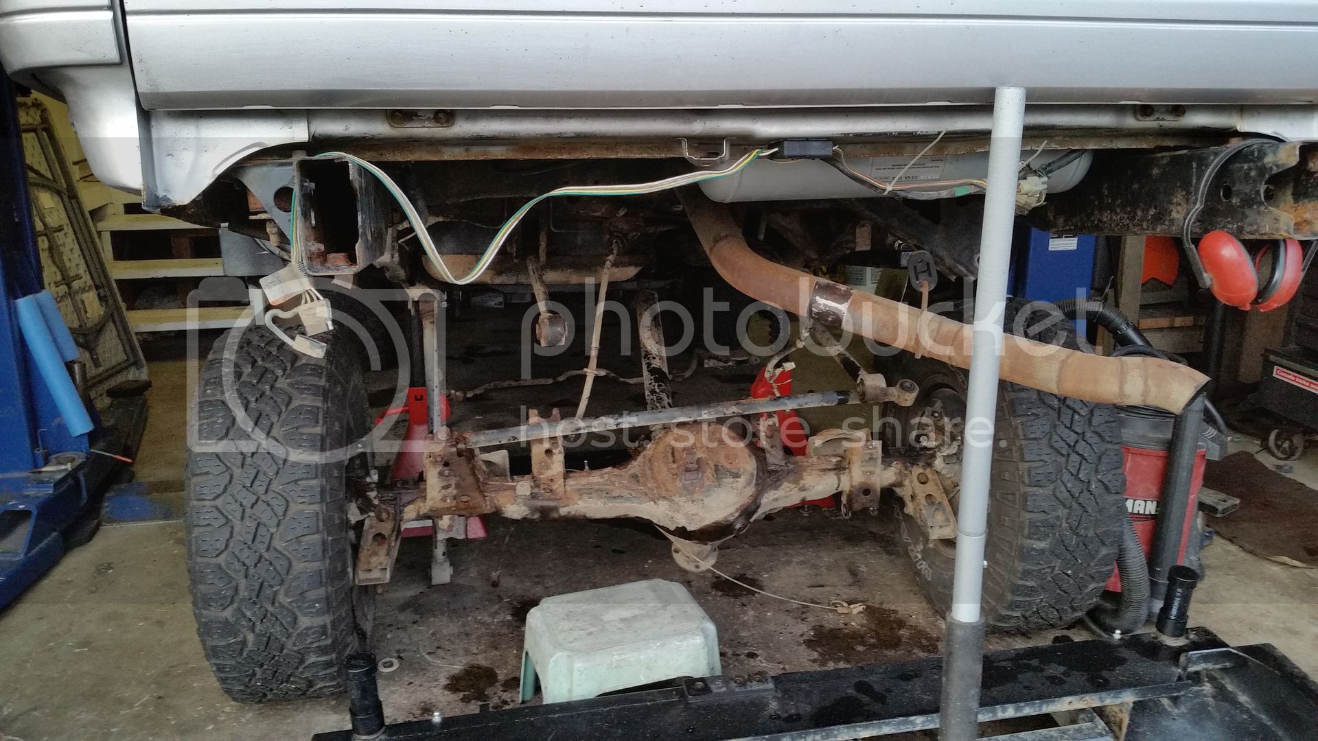

How I finished the day axle free, rear bumper off for extensive weight reduction and DIY penitrating oil on all the fasteners that will need work over the next week.
My skip leg day submission.

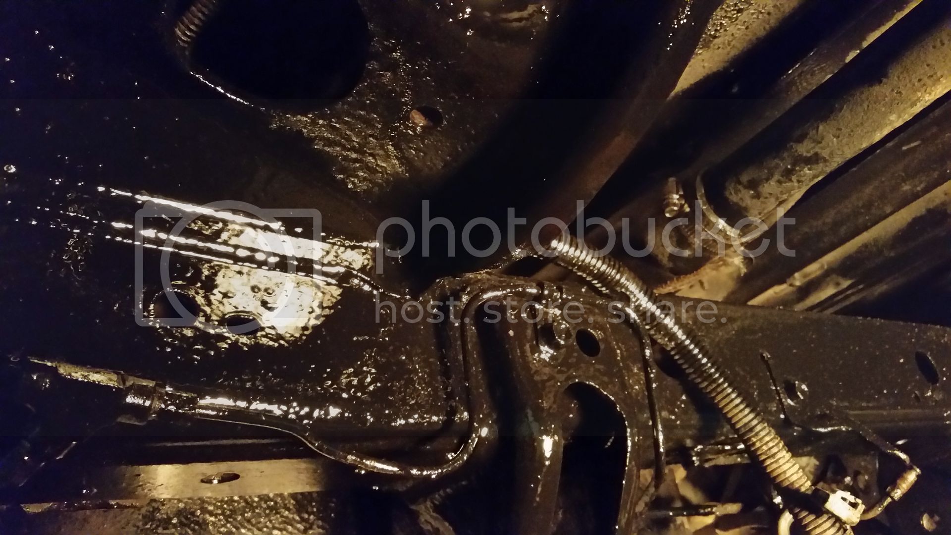

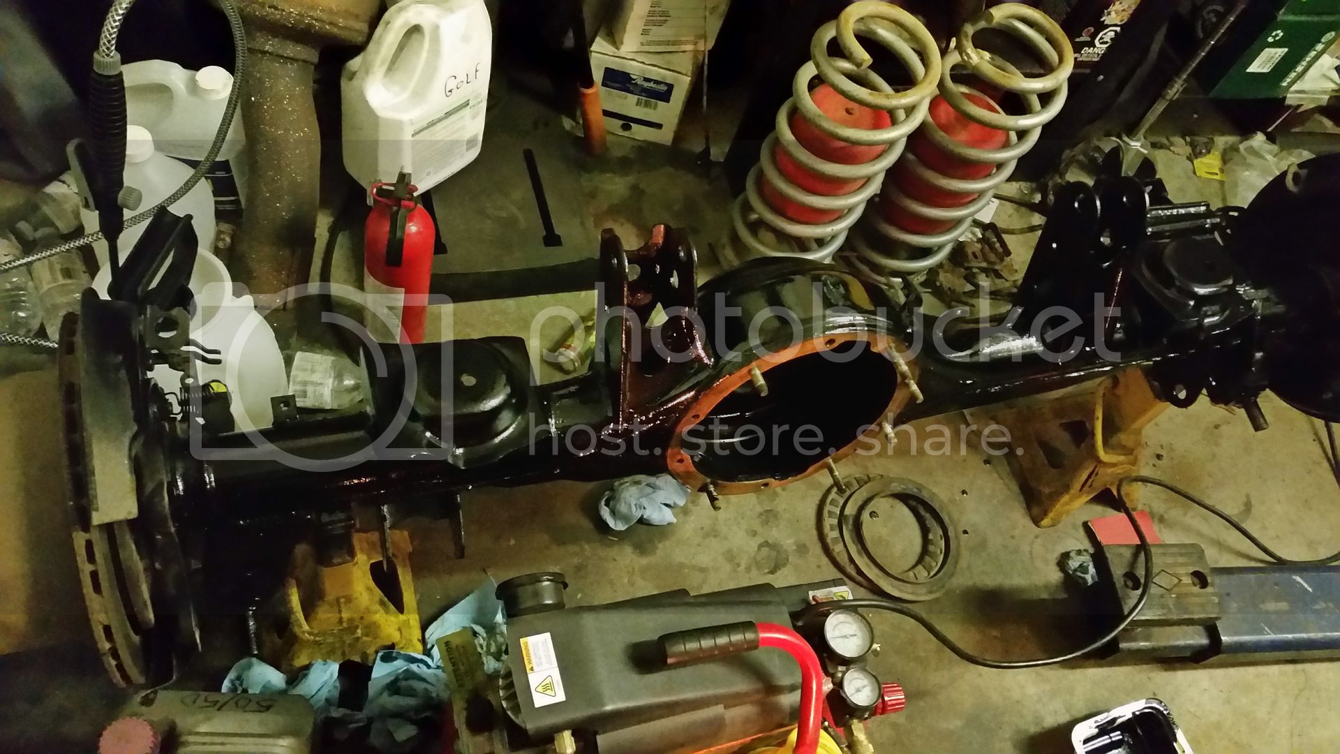

New housing is getting coated in Chassis saver. I have not been overly happy with the area in the back of the truck that got POR15 5 years ago. Most areas are very rusty again dispute the correct prep.

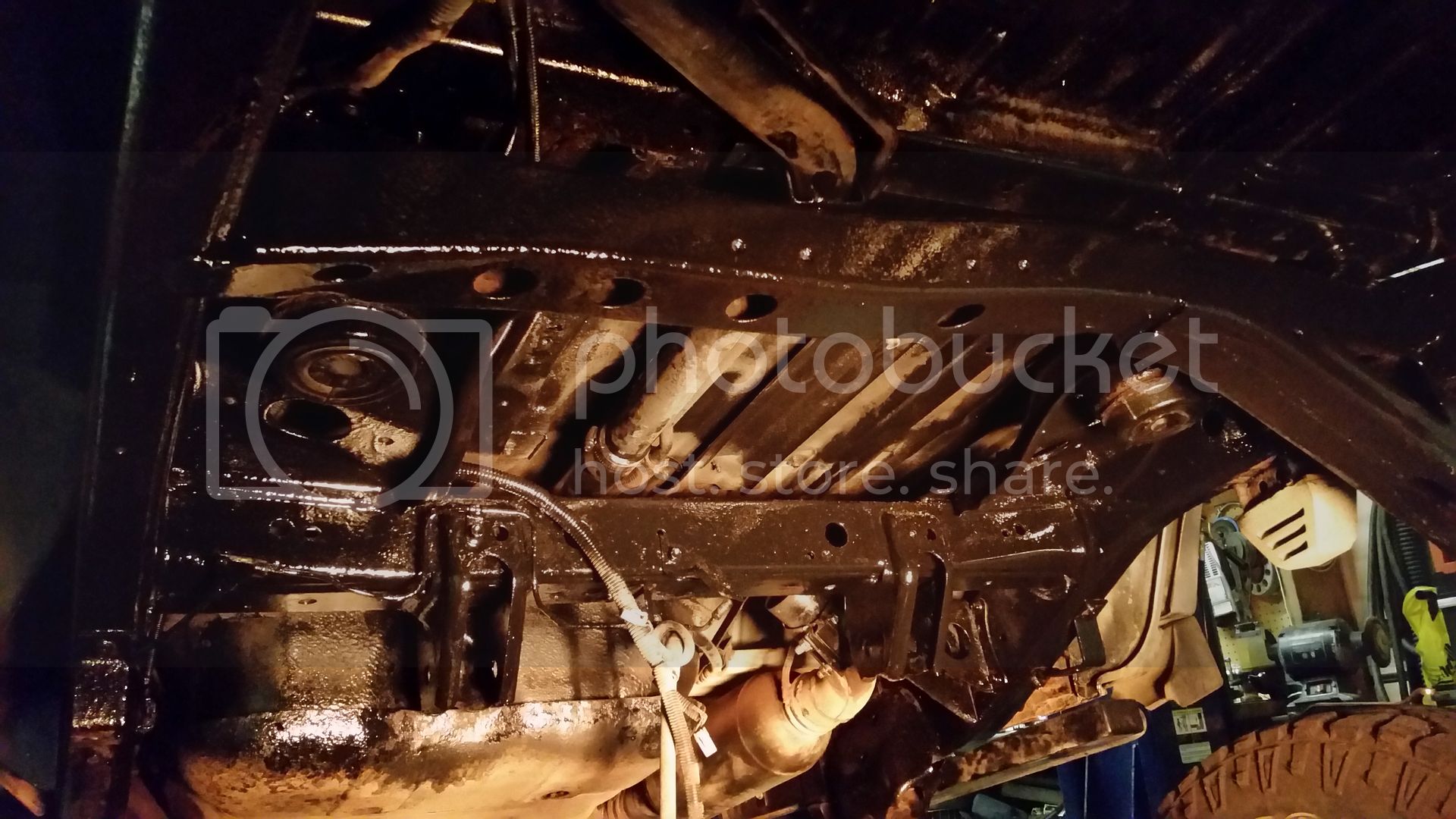

Two evinings worth of stripping and descaling and it's ready for chassis saver.
Brushed on the rusted areas then sprayed on the rest as a second coat.
Body rust repair...... :(

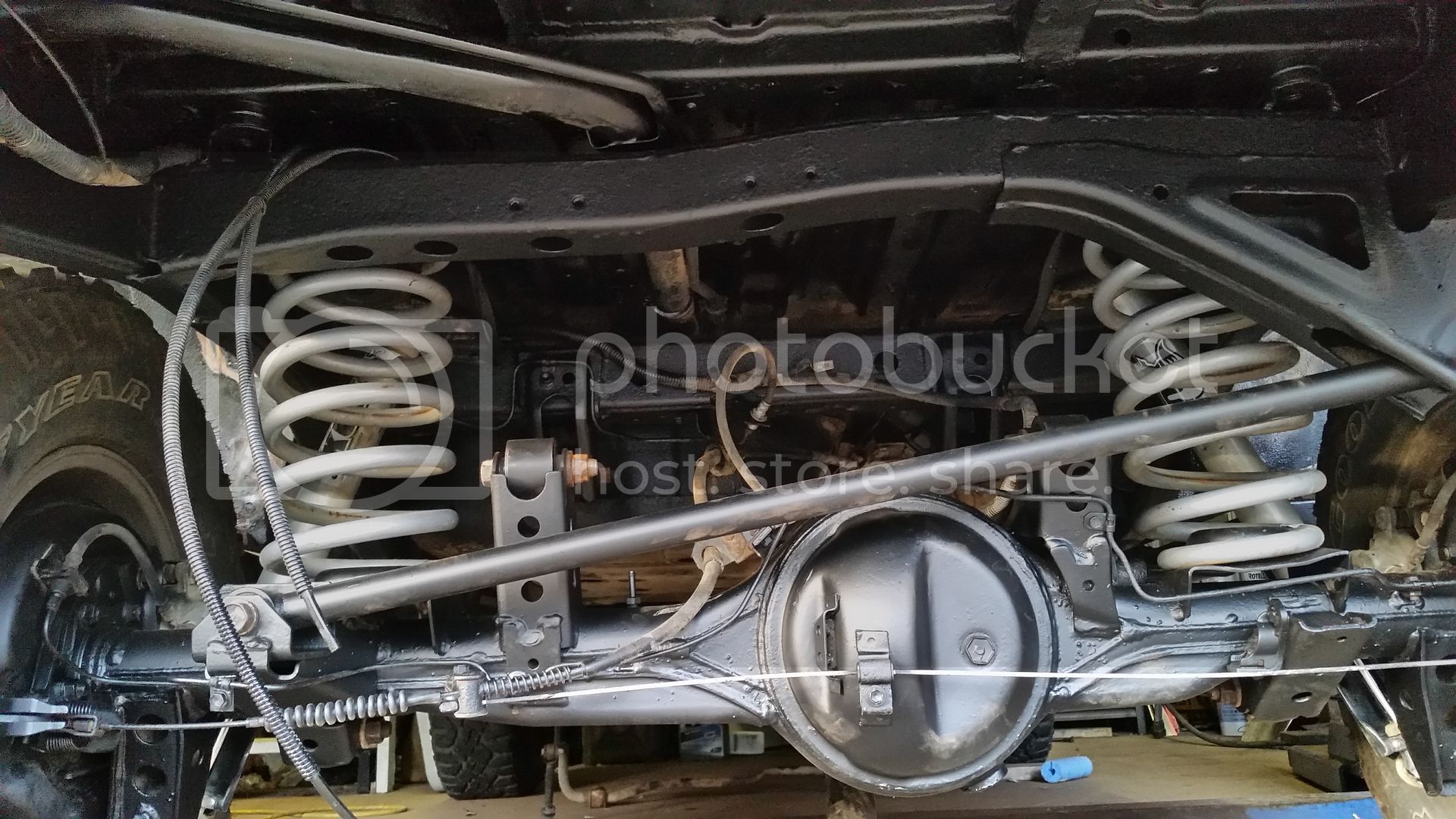

Axle housing all ready to go as well. 3 coats on high wear locations.

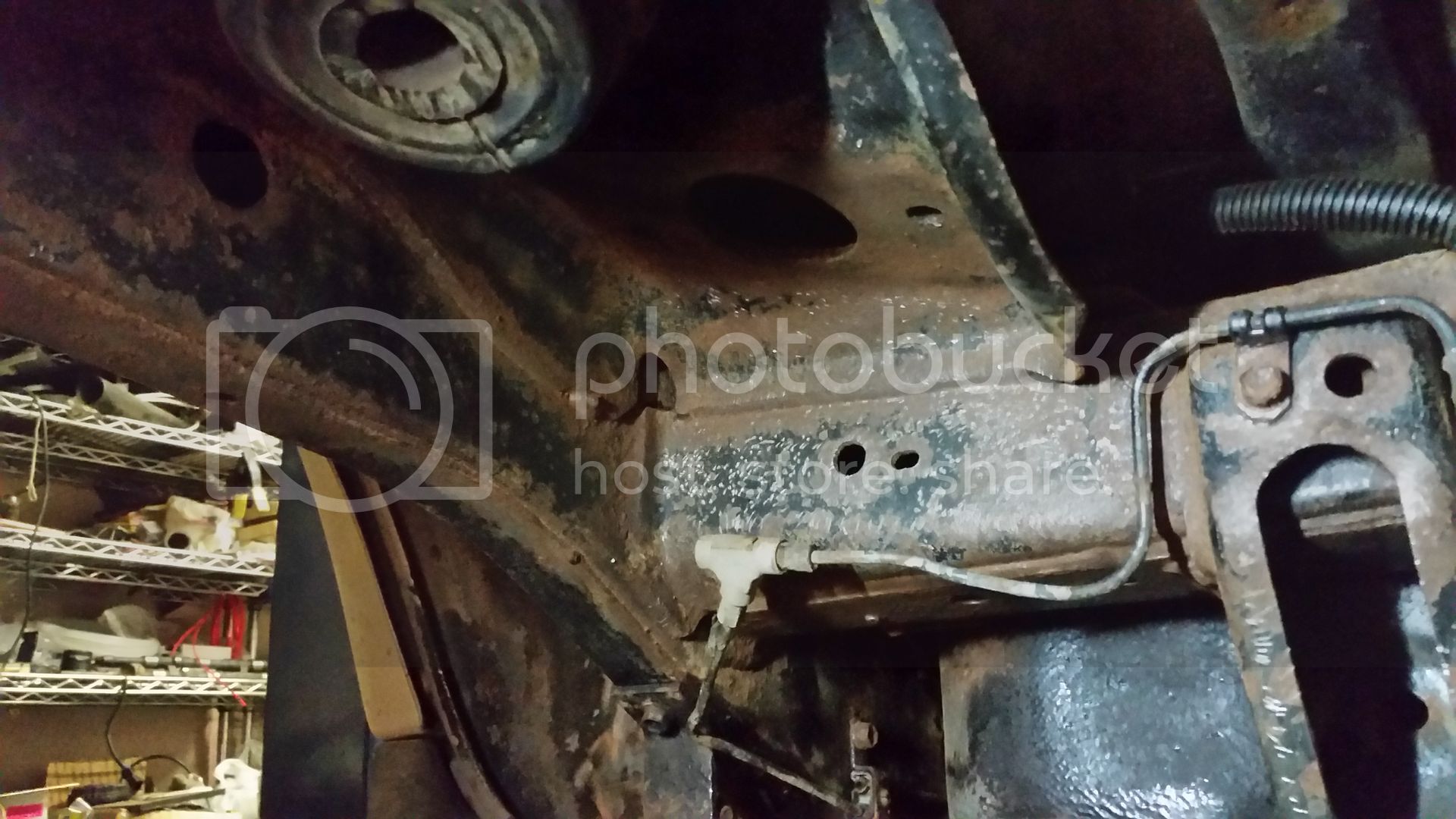

Got the rear axle back under it. Everything is connected and got torqued at ride hight. Need to connect drive shaft and put axle shafts in, would have put them in but did not have the paper flange seals. I'll need to get thoes from Toyota tomorrow. Brakes need to be bled but I plan to delete the ABS as it's useless now and I want better braking.

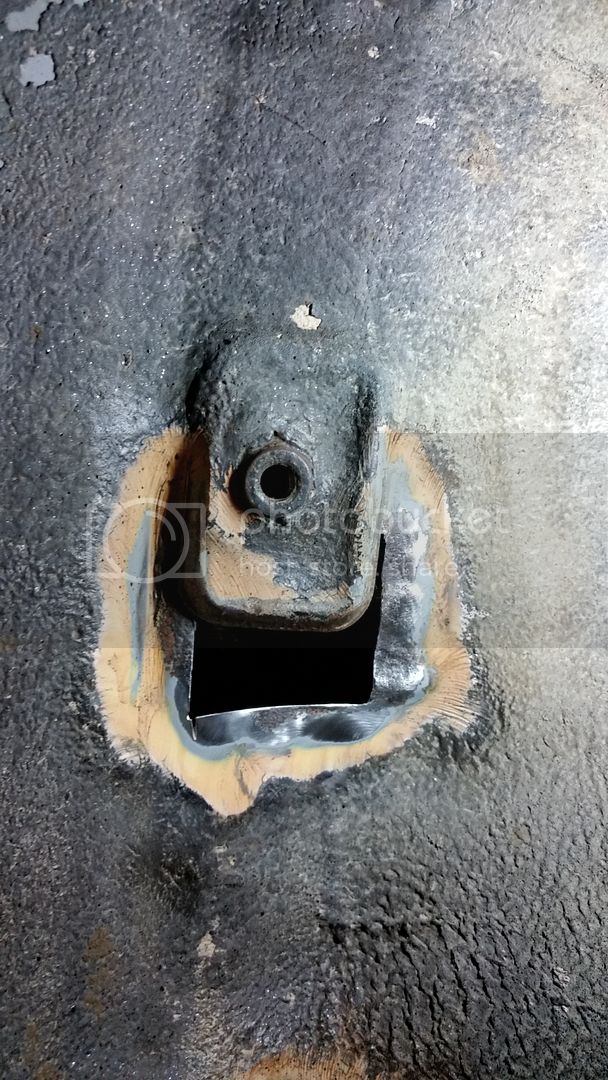

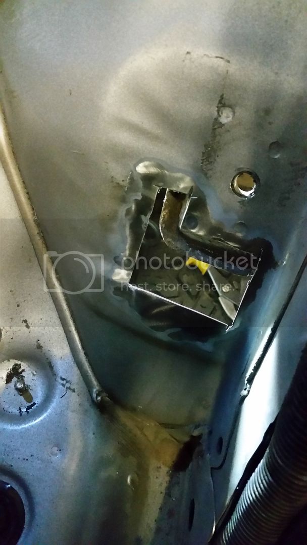

Once I got everything back under the truck I started patching the body. I got the patch welded in and ready for paint. I the looked at the rocker and things went down hill fast. I hate the LX450 cladding the s*** covers everything so you can't see what's going on under it. I need to remove the rock sliders and then the rocker plastic cover to really see what is going on. We have an arctic front blowing in and I was not dressed for the temp drop this afternoon so did not get any of that done.
Looks like I'll be working on this for longer than planned.
