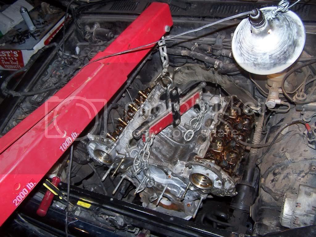

Here are some teaser pics of the engine I am using, installed into the 4runner.... it fits well with about 7 inches of radiator and elec. fan room. going a tiny bit into the core support as well as it has about 1.5 inches of space between the hood and topmost part of the 1UZfe, I have a 1.5" body lift that Iam doing my best to eliminate at least 1 inch of if not the whole lift, I am using 4" springs and the spring hanger lowers it an additional 1" making for 5" of lift in the front and I am running 255/85/16s (34.5) so I really dont need the body lift

it is pretty full but it still is hosting the v6 pwr steering pump (to lazy to remove) It also has all of the v6 electronics too
I will be putting the v6 back together this week so the v8 is coming back out for about 3-4 weeks then the installl will be for good.
I am sourcing a radiator and electric cooling fan that fits my parameters ( I was able to get a bit over 5 inches of space between the engine and core supportwhen I made the final set of mounts as well as lowered the engine an additional 1.5 inches)

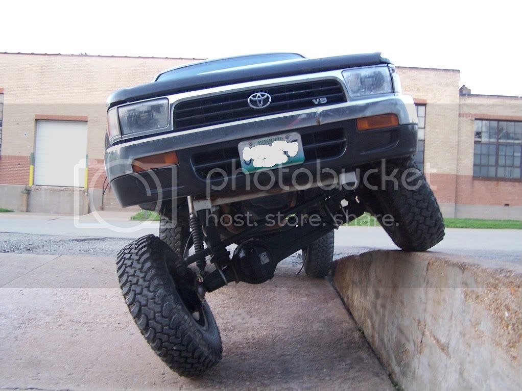

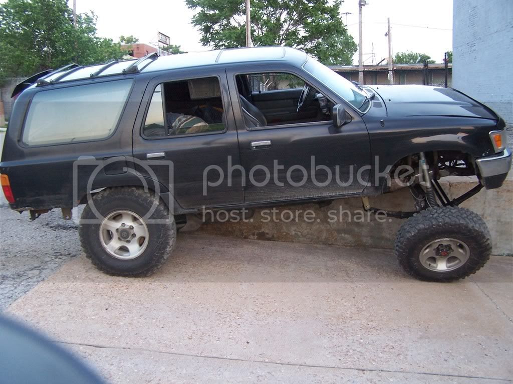

here are some pics of the new suspension flexing a little bit to check clearances.... yes I know I have duct tape where my diff should be but one thing at a time. the engine runs great, now its off to someone else and the v8 will be going in. next post will be some of the v8s sc400 manifolds and how well they fit over the motor mounts.
