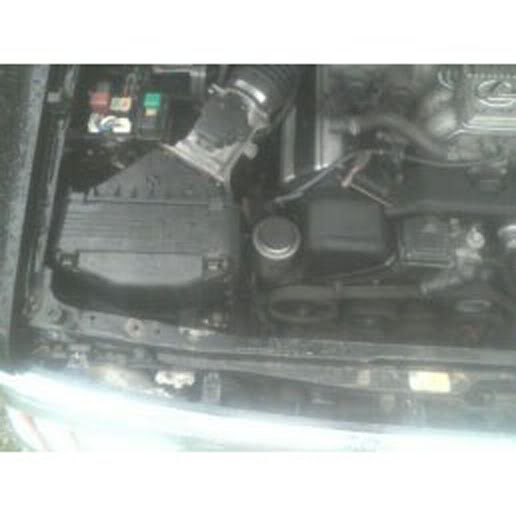

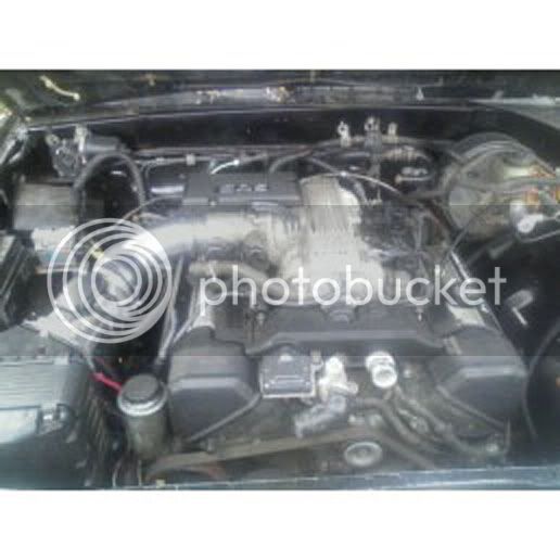

the V8 found its home and after many hours putting lexus fuses/relays into factory (underhood) fuse/relay box on the 4 runner.
I will post up pics of a wire harnes that plugs between the 2 vehicles systems using factory Toyota plugs.
SC400 air box and a 3 inch intake (mandrel bent stainless)
I had to make a 5 degree wedge to make the mass air meter 'point' at the intake butterfly otherwise it wouldnt have mated up to the mandrel tube without a goofy silicone hose

The fuel pump relay is the bright yellow/green (Lexus) one that you see in the fuse box.
Not all models have the same fuse/relay box or an empty location but this one did and it worked out fine.
The Circuit Opening Relay went inside the cab where the original Toyota C.O.R. went.
Underneath the red main battery (+) wire you can just make out the 2 speed fuel pump resistor, I had to upgrade the fuel pump main power wire to the pump. The original was about half the size of the Lexus wire.
The black plastic shiny 6"X 6" box behind all of that is the cruise control....not quite mounted yet.
