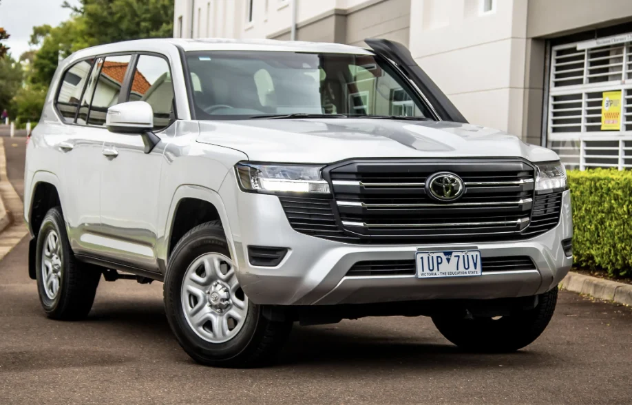

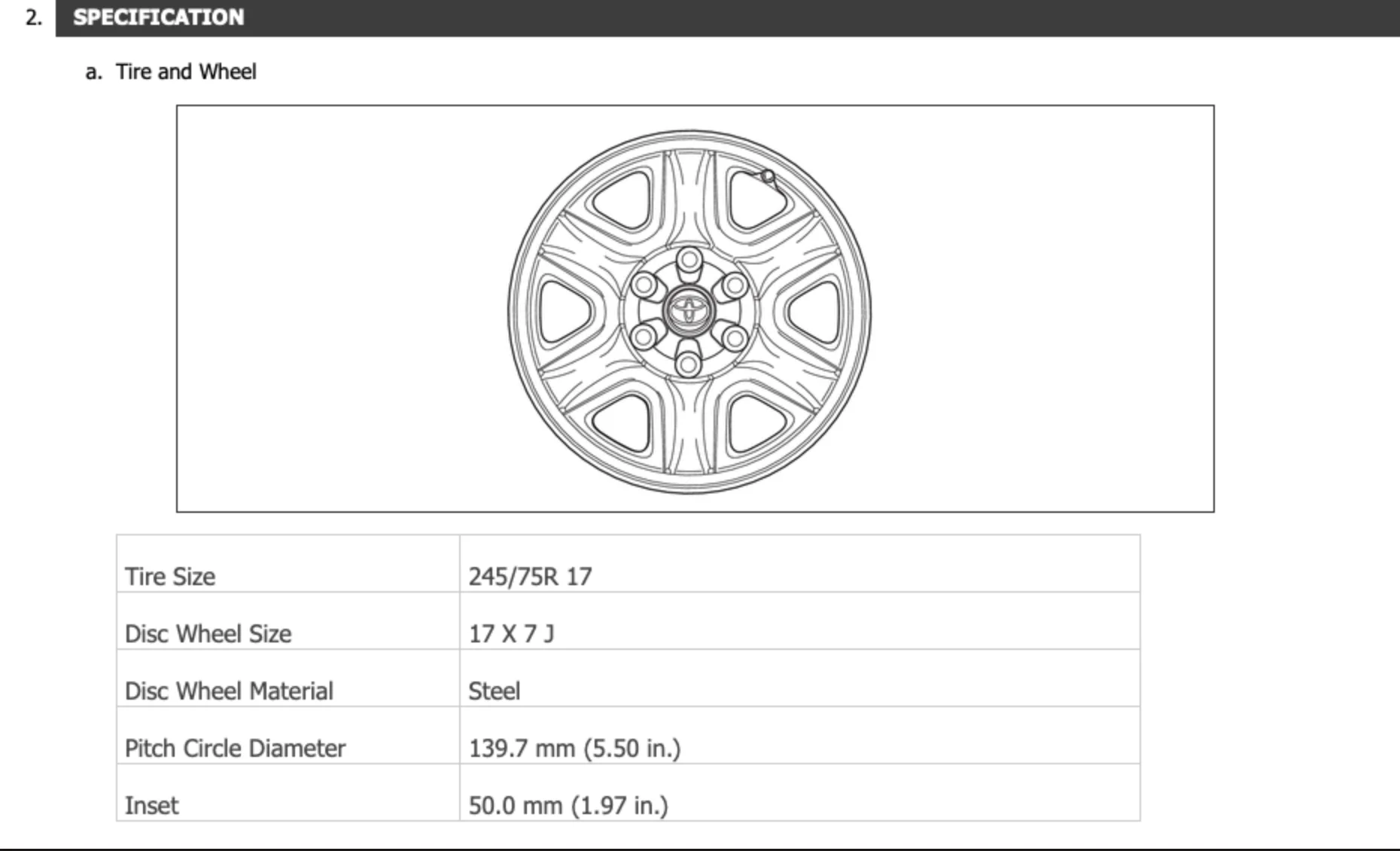

So starting with the J300,
We have this base wheel option ( which doesn't clear the front of higher spec 300s FYI )
Part number
42611-60F20
17x7

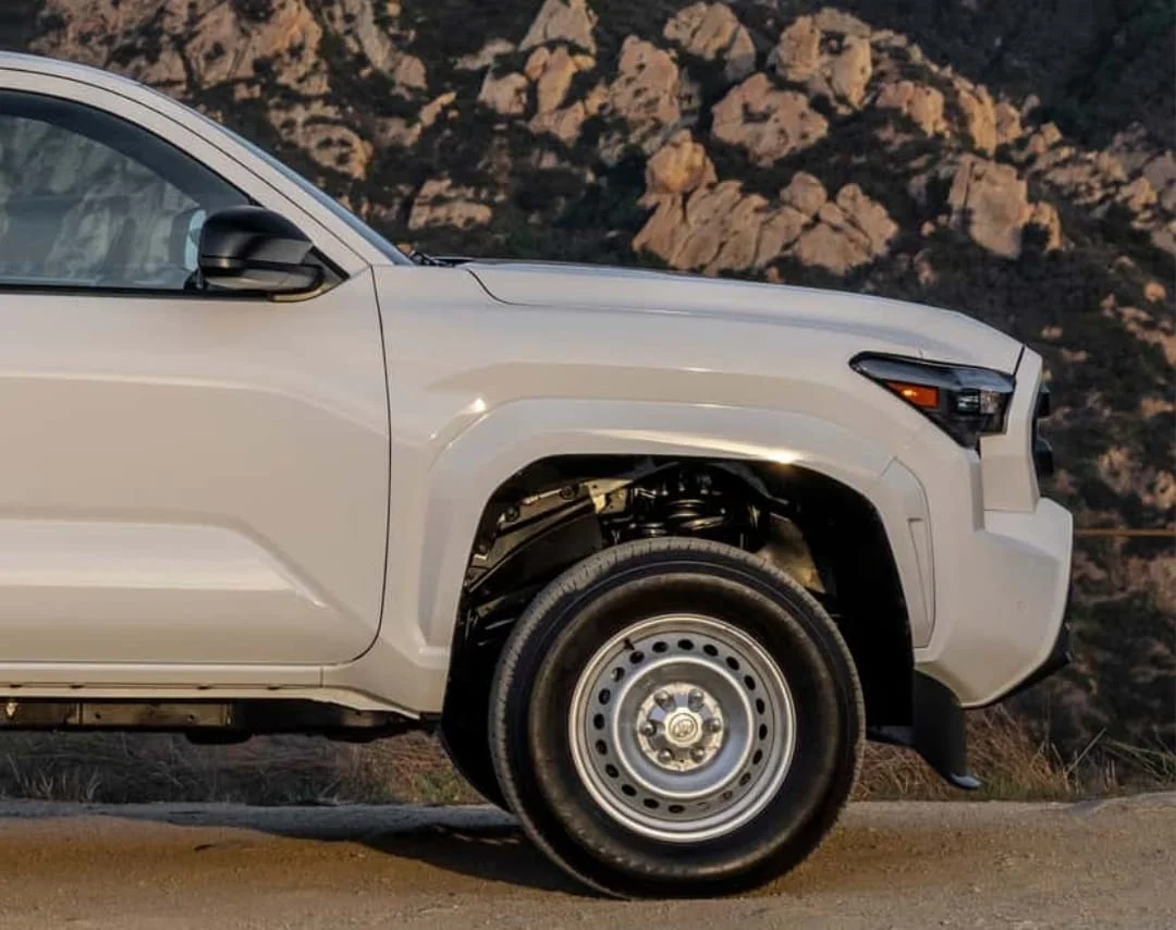

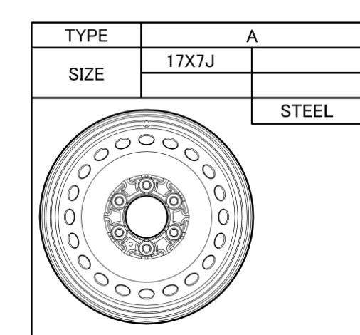

Option 2
is the '24+ Tacoma steel wheel ( the more traditional hole steelie design )
17x7
Part Number
42601 - AK031

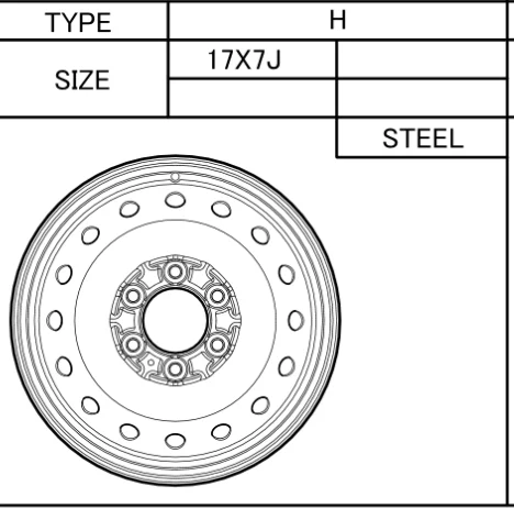

They also have a Type H ( which I assume is the same but in black for spare applications? ) not sure of the part number

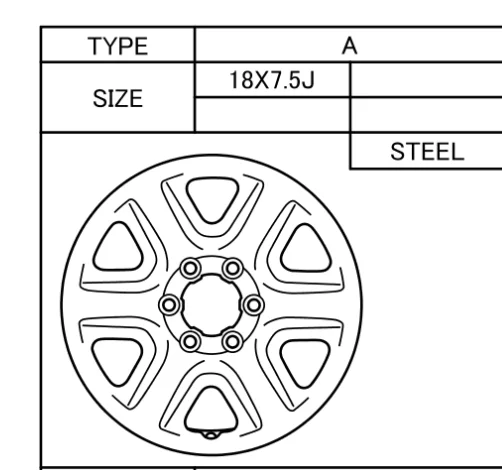

now we move on to the 18 inch Tundra options
42611-60F20
18x7.5

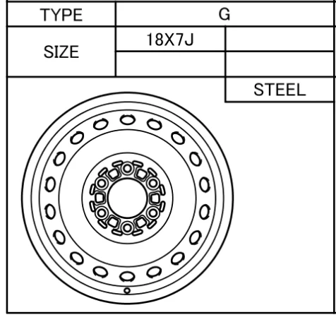

You also have the spare wheel option which I don't have photos of but looks like this
42601-0C080
18x7

This could be of shared interest between J250 and J300 owners and other possible current and future TNGA-F products.
So I know some people like base steel wheels, especially those looking for narrower tires.
Toyota has made plenty of 6 lug steel wheels in the past but for now I am focusing on the steel wheel that came out during the TNGA-F era.
Part number
42611-60F20
17x7
