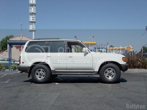

Here's my rig with 2.5" lift and 33's.
When I had 33's and no lift the rig looked kinda funny as if no articulation was possible.
33's before lift
33's after lift

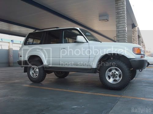

mine
OME 2.5 33 bfg ATs
I need to get a better pic of how the tent lowers the rear...
adding a rear cargo box helped bring the ass end down... but still sits well above the 33s

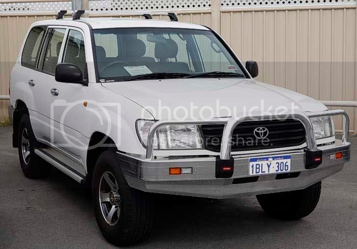

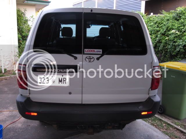

These threads are really useful, so I thought I would run through some of the things I've done. I've had this car for a few years now, a 2001 HZJ105R Standard. She is built as a remote area tourer, but goes out sometimes for a 4x4 play weekend. These are affectionately known as the poverty pack, barn doors, and basic basic basic. They get almost no extras, 1HZ diesel, the weaker R151 gearbox, manual door locks, winding windows, no air bags on pre 2002 models. No glove box light, footwell lights, central locking, nothing! Some basics are good to have, the vinyl bench seat and vinyl floor mats are a joy when covered in mud or beach sand :)
Here she is at the dealer

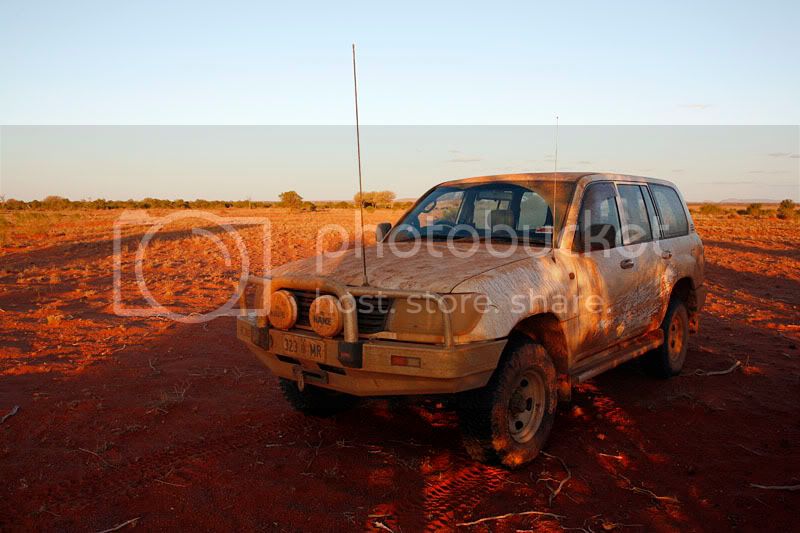

Here she is out the back of Broken Hill in New South Wales.

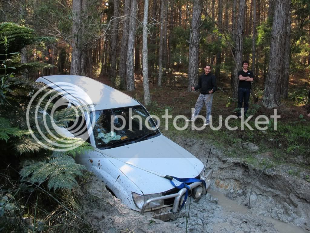

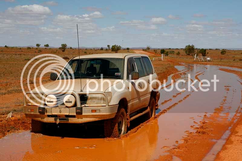

Turns out she can't go "everywhere"…

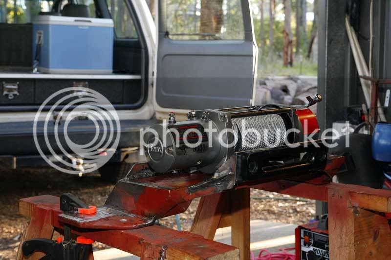

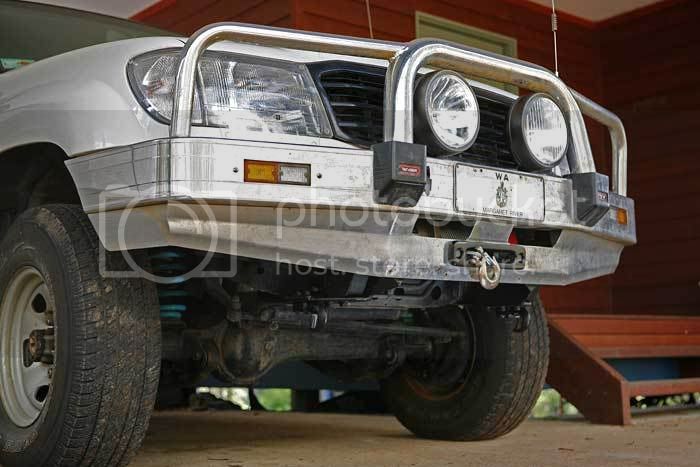

I built a winch cradle for the alloy bullbar, it was on the car when I bought it so will have to stay until it eventually comes to a sticky end. When funds allow an ARB steel winch bar is the preferred option.

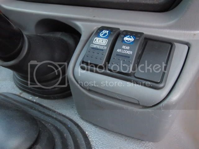

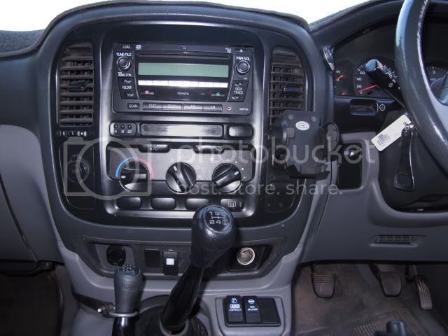

Basic interior with some mods…
Murdered the ashtray, promoted to a more important role…

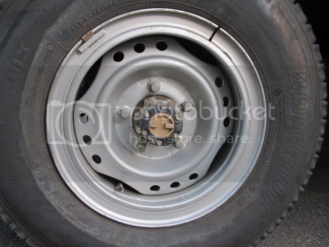

Standard 16x6 0 offset split rims so I can fix them myself whilst away.

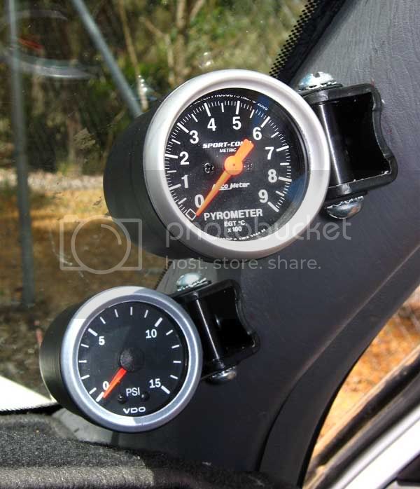

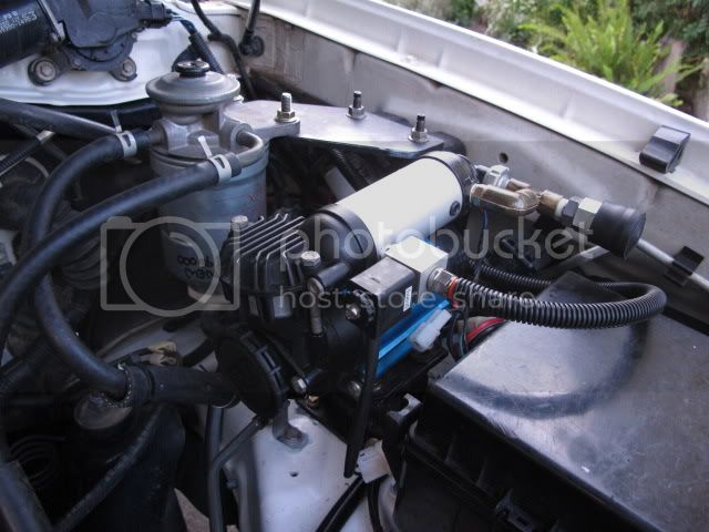

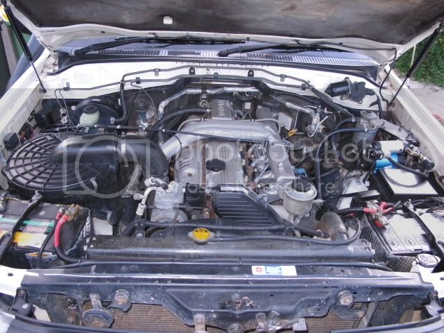

Engine bay - Safari turbo, dual batteries, ARB compressor for locker and tyres
Roof console, a bought item from "4wd Interiors" I think…
These models have an ugly fat rear end…

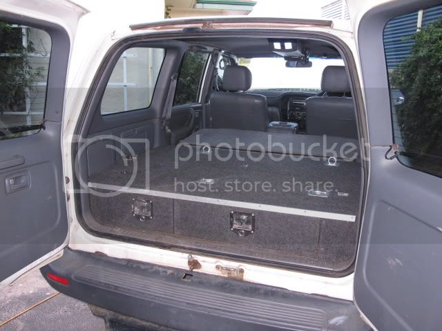

Inside a drawer system I built, when the back seat is folded down we can sleep in the back.
http://i179.photobucket.com/albums/w320/echelon_1000/IMG_2215.jpg
Get a good set of tire irons and a bead breaker, and you can change any tire on any rim yourself. I got rid of all the split rims we had here at the farm due to the danger of popping the removable part off when inflating. A high lift jack works nicely as a bead breaker, but for the farm I got a special bead breaking tool that is a special screw jack.

actually, it depends on the design of the split rim and the idiot working the wrenches.
the toyota splits have a 4 degree bevel so as long as you have the rim seated properly then the ring will seat tighter the more air applied
but
if a person is concerned, nervous, uncomfortable (or finds them ugly) then a one piece rim is for them.
