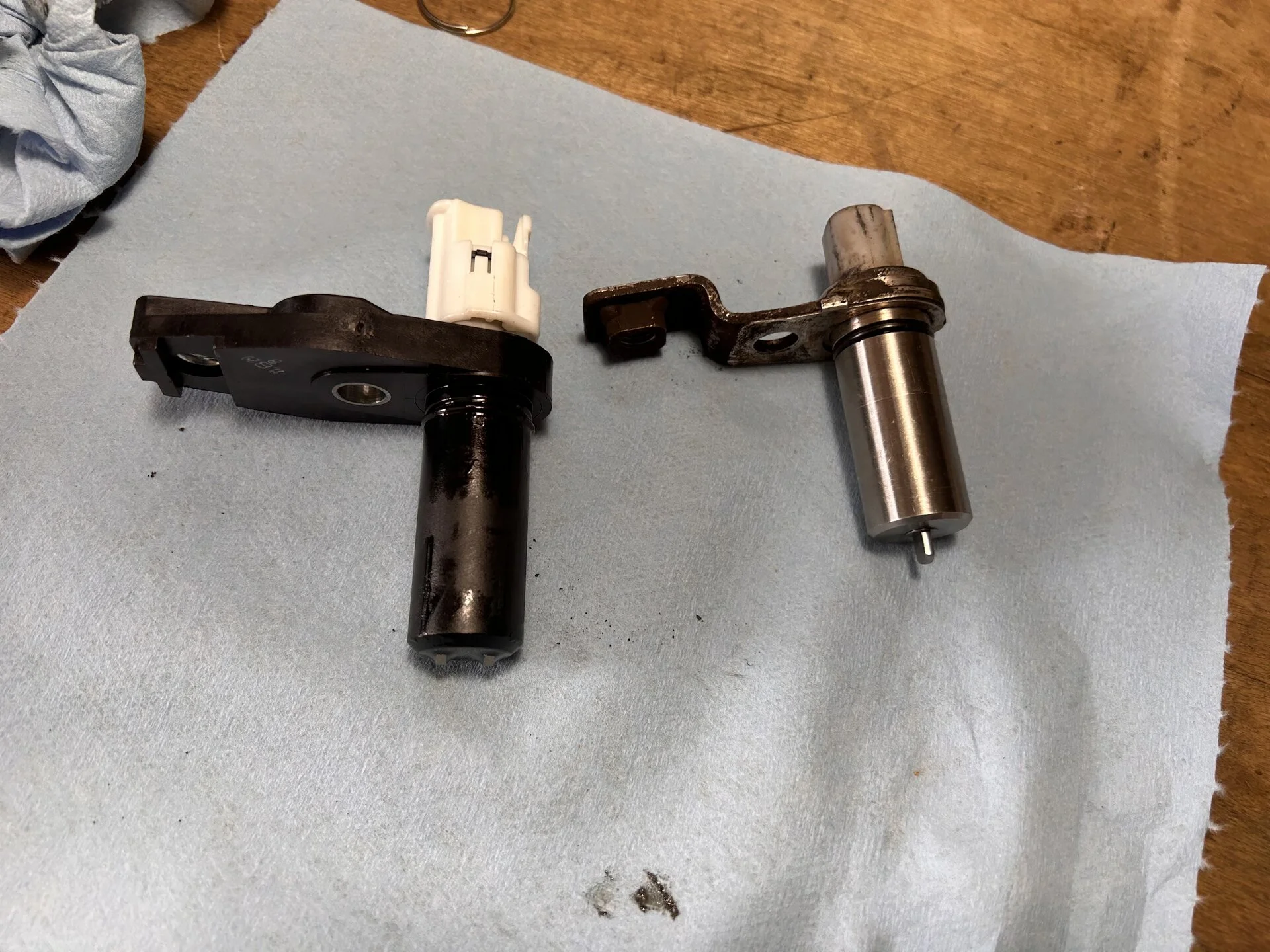

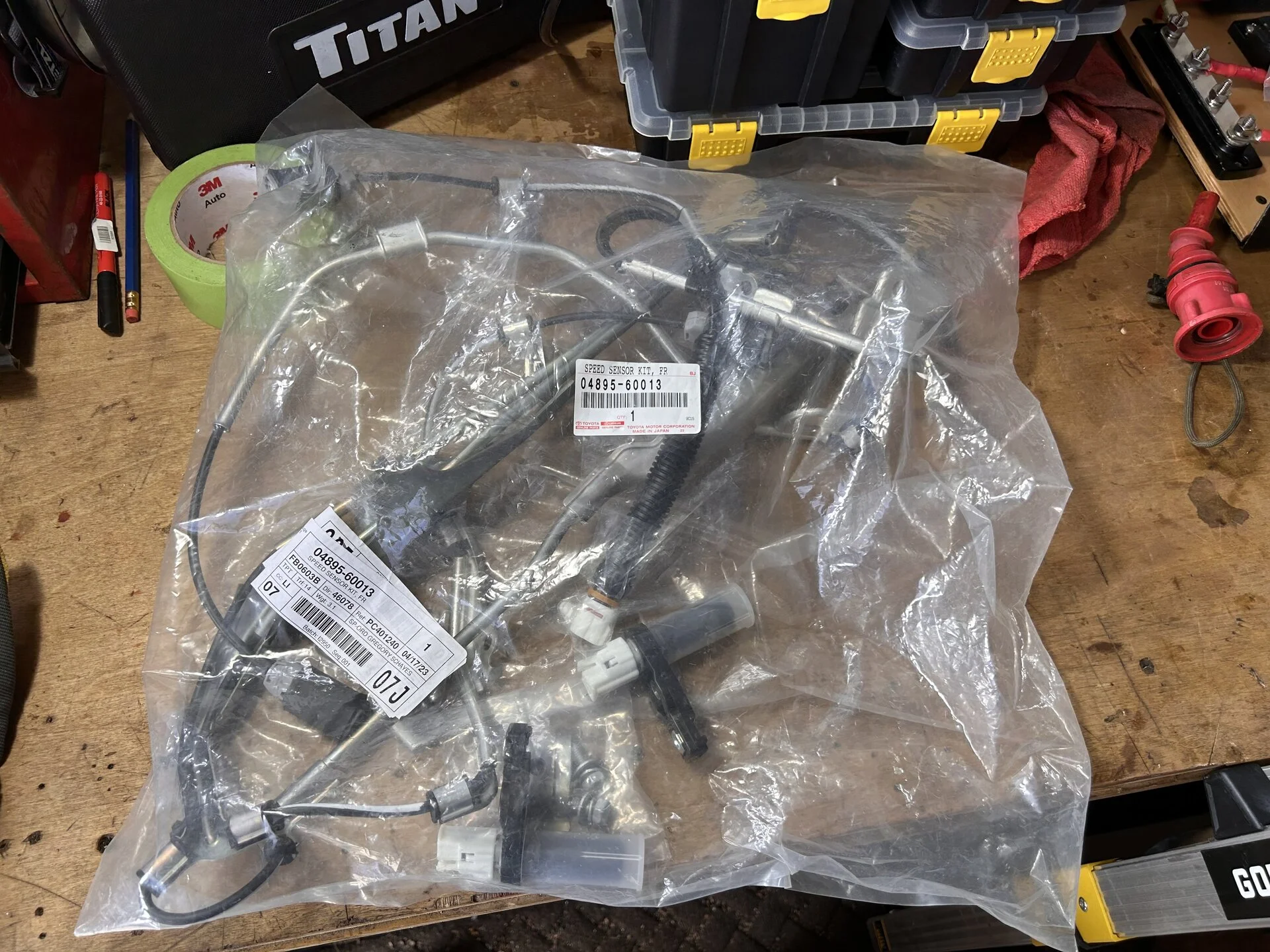

$500+ later I now have a brand new speed sensor kit, complete with a whole new wiring harness and all the brackets. You probably already know that the speed sensors are only available new as part of the kit.
New on the left, old on the right. These new ones are pretty different than the old ones.
-plastic housing
-no shims
And two magnetic pickups vs one.
After some research on the forum I concluded that it is possible to run new style sensors (95-97) in old rigs (93-94). The old style sensor is not Available new and a used one will cost you a pretty penny and are not readily available…especially if you’re in a hurry to fix. So $$$$ to foothills Toyota.
The part fits fine—no issues installing. But my ABS light went on after starting up the truck. I did clear the ABS codes before my first start up. But it came back with code 36: open circuit in R front speed sensor.

I replaced the passenger side front ABS harness (and reinstalled the old speed sensor). I pulled the old harness and it has some break in the wire somewhere. After putting the new one in I started the truck up and no ABS light. Took it for a test drive and the light came on with in a block or so. Drove more and the light went off at 35-40 MPH. The light came back on at low speed again. Then at 45ish MPH the light came off but when I applied the brakes moderately the truck pulled to the right and made everything feel kind of crazy and unstable. Not cool--so I cautiously limped home. I'll pull the ABS codes again and see if there are new ones.
I'll finish replacing the diver side harness and put in both new speed sensors and see what happens next.
Hopefully last of the ABS issues
I removed the driver's side ABS wiring harness this morning and replaced both speed sensors. The harness came off easily despite being sealed to the radius arm with undercoating. I smeared some dielectric grease in all the connectors and bolted every thing down. The new harness is impressive in its massive amount of brackets. I'm 100% happy I ended up ordering a new harness from Toyota. Its very easy to say "I'll just trace down the break in the wire and splice in a new bit to correct the issue..bla bla bla." But getting to some parts of the wiring harness would be tedious (at least for me). I can easily see why folks would then choose to ditch the ABS, especially when so many people share their positive experience running with no ABS.
I digress. I took the rig for a test drive to a steep gravel hill into a parking lot in Fairhaven ( a neighborhood of Bellingham). ABS worked perfectly and no codes. I took it up to speed on the freeway and made some strong stops on the off-ramp. I feel satisfied that the ABS issue is now solved. Its no joke that you need to treat those sensors very, very carefully when you remove your airfields during front axle services. One last gotcha: don't drop any lock washers into the hole for the speed sensor. Its difficult to get them out, and its why you need a tiny telescoping magnet in your tool box.
Key notes for the special 93-94 year folks:
  • Available speed sensor kit 04895-60013 happily works with our special rigs.
  • New style sensors will physically plug into the old harnesses, but are quite different looking from the old ones.
  • If you are following along in the FSM for speed sensor replacement, I no longer had my 2mm spacer (read washer) below my speed sensor bracket. I did not consult the 95-97 FSM to compare the procedure. I was happy that my "air gap" seemed ok and I didn't need to figure out shims for the new sensor (I don't think they exist...)

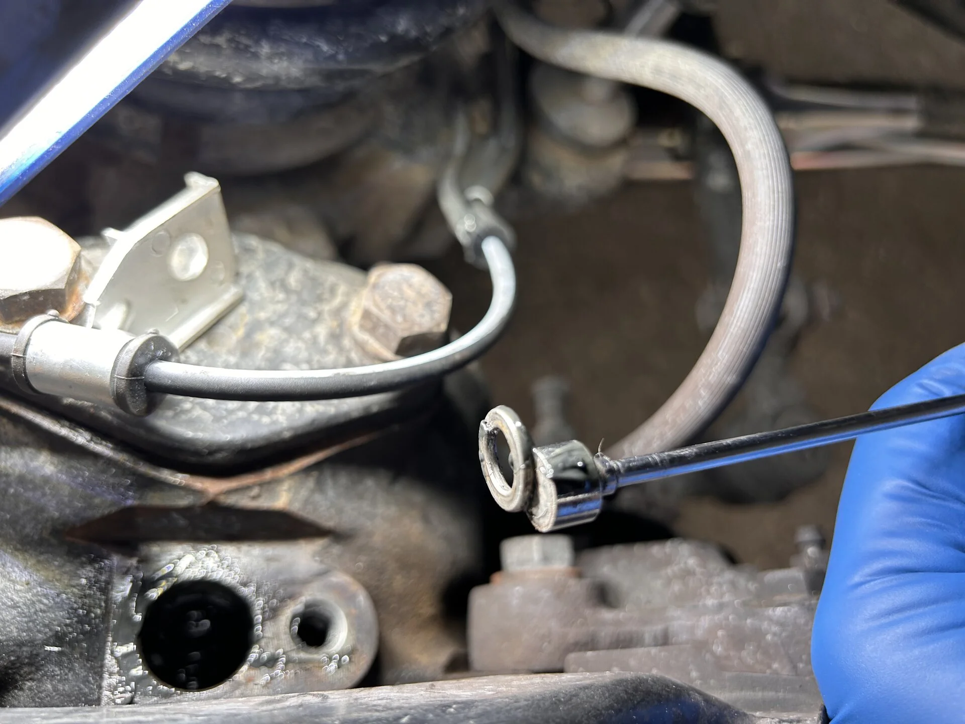

Don't drop this into the hole. Also buy a telescoping magnet. because you will probably need it.

fortunately it took all of 3 seconds to retrieve this one. That moly grease saved the day and caught the washer right on top of the birfield. I'm glad I didn't need to go shopping for a borescope...but there is always tomorrow.

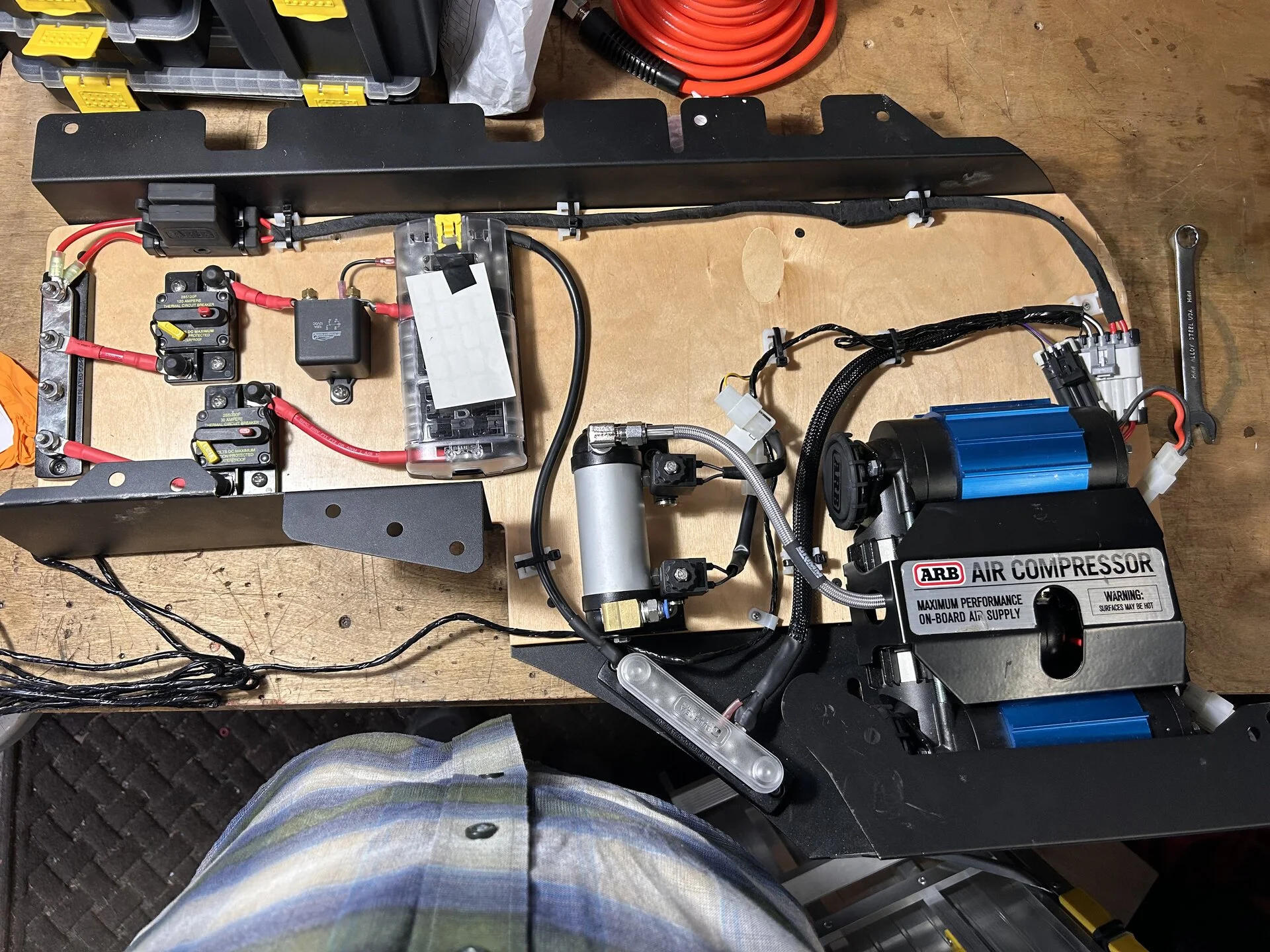

I also finished my lingering air plumbing on the QPM. Ready to install.
The small lower press fittings on the ARB manifold will route to a quick coupler mounted to my drawers. I have an elegant little ARB bulkhead mount that I'll mount once I'm all moved to MN. So that will be a wrap for the QPM stuff. I'm planning on stuffing it in the rig and hooking it all up when I have some time to actually enjoy the process. I'm not likly to be using the lockers or the compressor until the fall at the very earliest. I'll keep you posted.

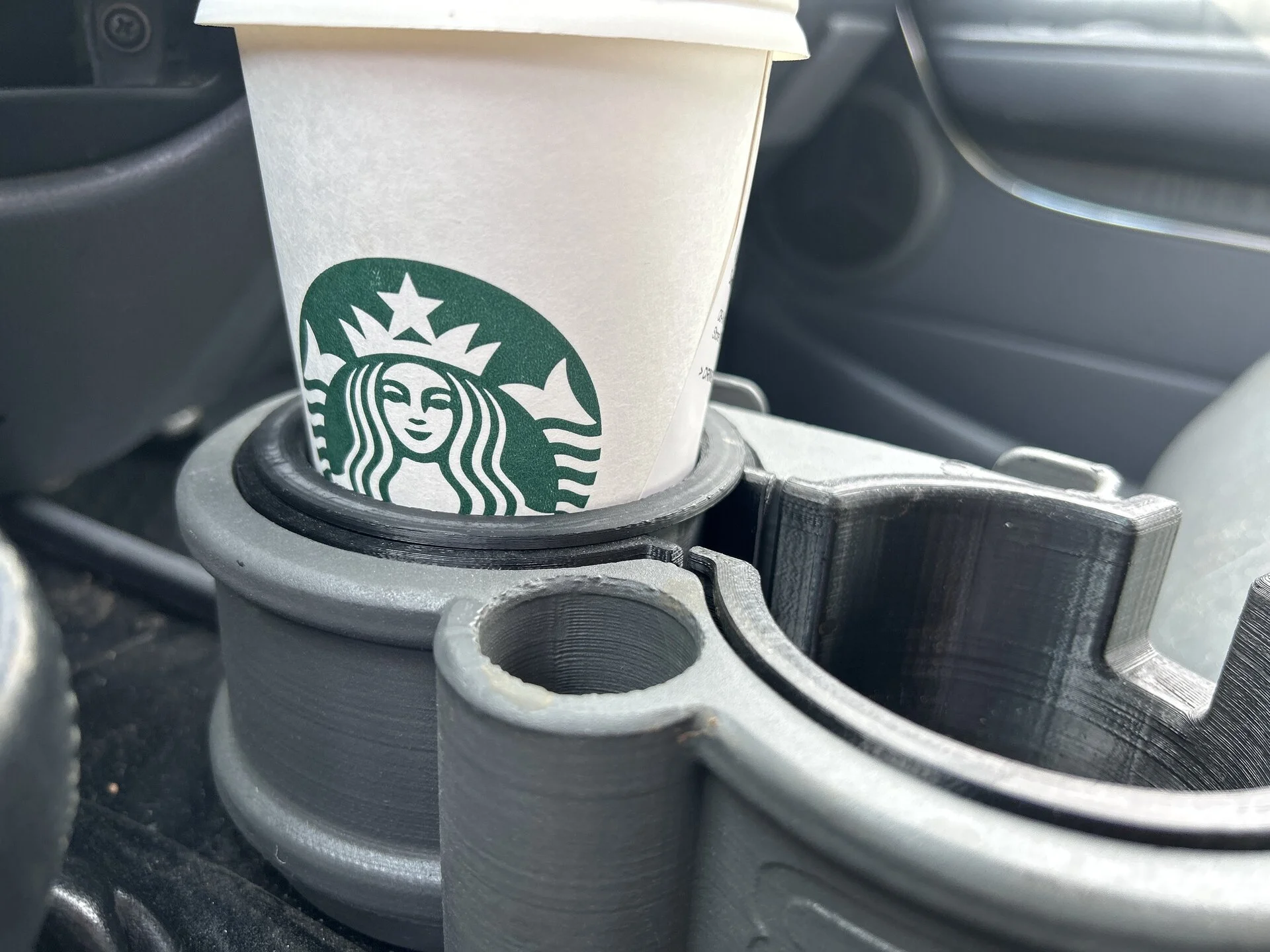

Break in service supplies are in hand. But the real mission today was to fill my cup holder with this…
Because you all thought I was kidding about Starbucks…malls possibly.

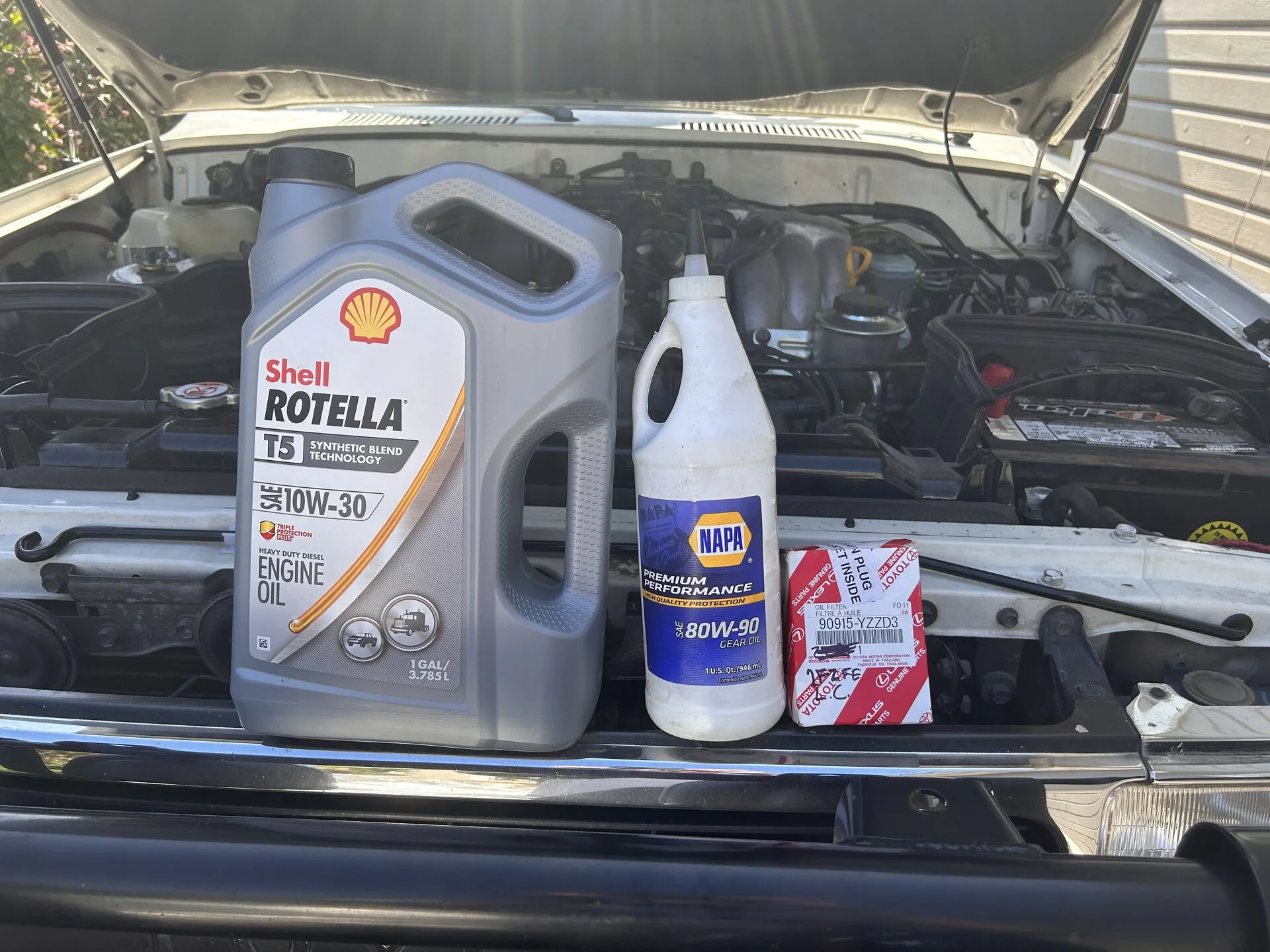

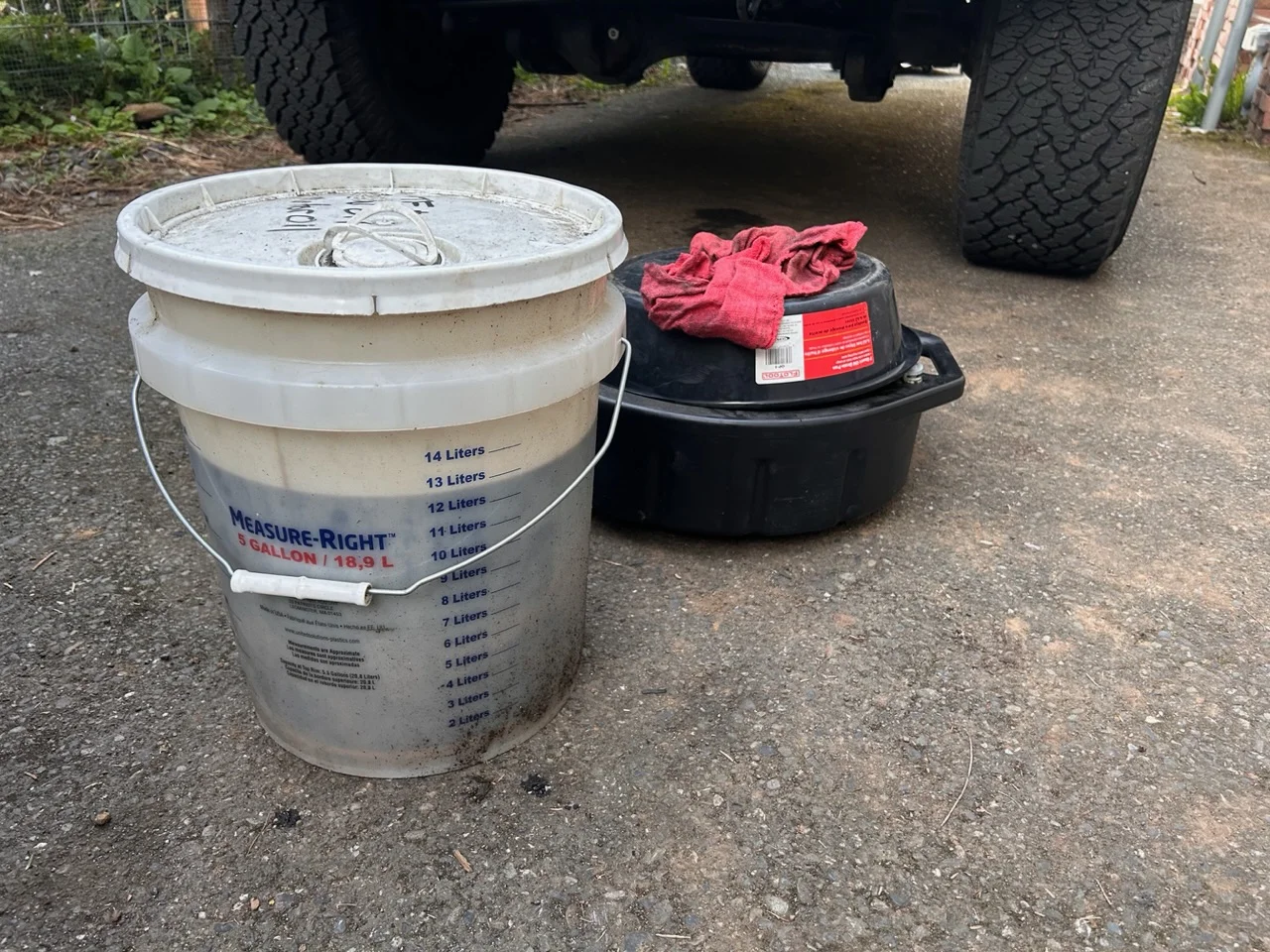

Fresh Oil @222,808
Changed out that break-in gear oil. Lots of fine metals on my drain plug magnets, and a few small flakes. After some consulting with @baldilocks about gear oil with out LSD additives (I’m not really into psychedelics), I decided to go with NAPA house brand gear oil. It meets API GL-4 or GL-5 requirements. It also has no claims about Limited slip Differential additives. A NAPA employee told me that the NAPA oil is rebranded Valoline. It’s not especially fancy, but I anticipate that I will change it more frequently than my other vehicles given its intended usage.
I changed motor oil brands from M1 10-30 to the Rotella T5 10-30. I may switch to a lower weight oil this winter, though I don’t plan on using my LC a lot in the nasty MN salty road environment. I do however want it ready for service if necessary, and I do plan on some short drives to keep it happy and lubricated.
Filter is the made in Thailand Toyota. Out of fear of leaks I decided not to run the “big Toyota one” I have in my parts bin.
Full engine drain, and two diffs (plus a tiny lawn mower) is a lot of oil. Plan accordingly!

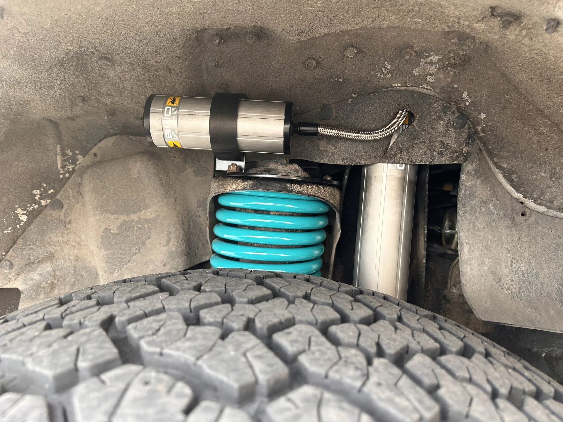

The poor folks at @cruiseroutfit are gonna laugh at my hard finished project, but I'm still excited to meet them and get those tropical fish colored springs on the Cruiser.
Teaser…
My new coils and shocks are a big upgrade.
Also there’s this…
Please excuse the truck’s filthy appearance. 2,000 miles of interstate travel has prevented me from shining it up for some photos. The difference between before the delta arms and after has been dramatic. I’ll be excited to see what long radius interstate mountain descents feel like, because before it was often a little scary to have the truck need corrections mid-turn.
