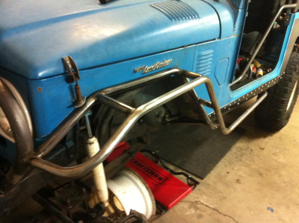

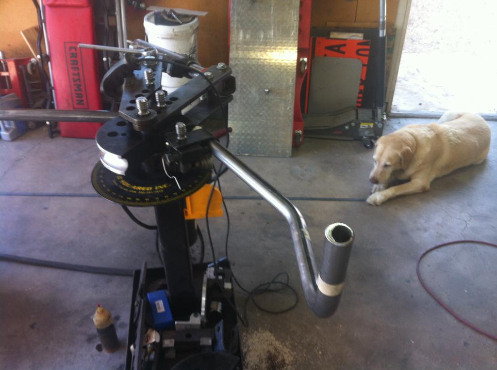

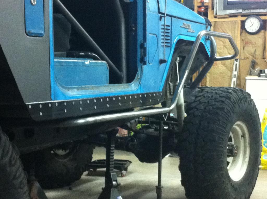

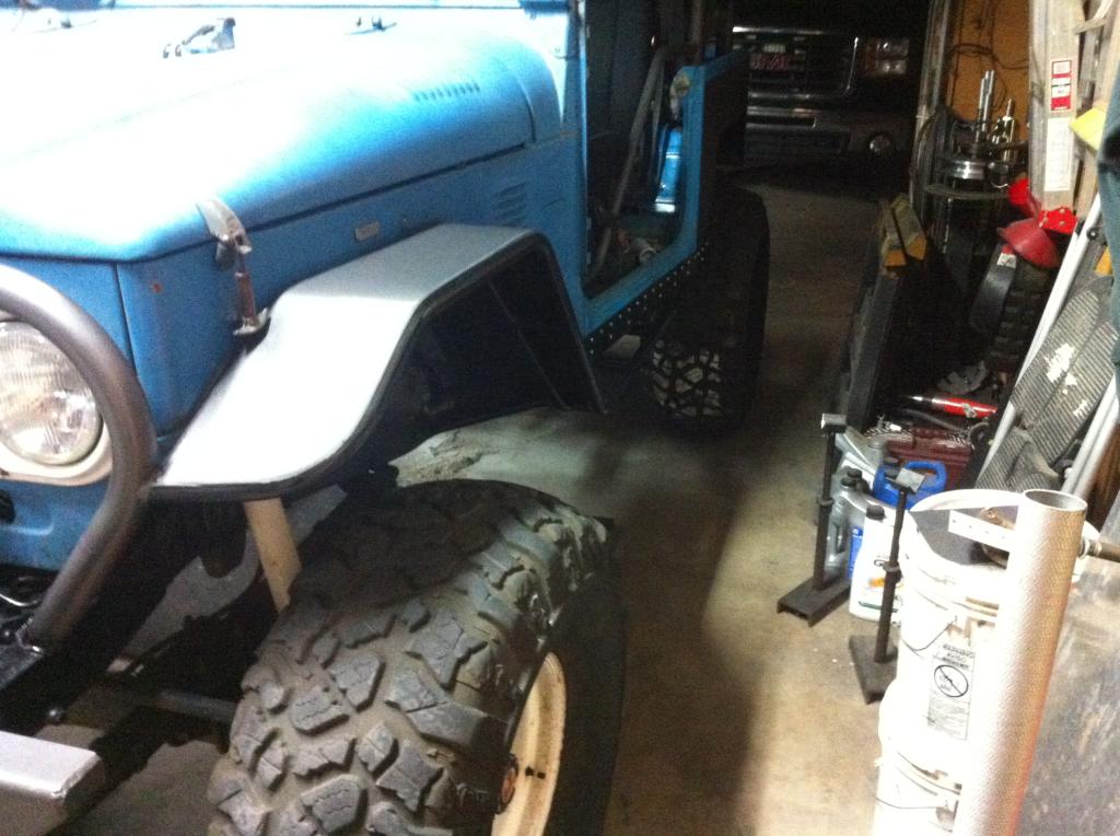

Been working on the tube fenders... this has turned out to be tougher than I imagined

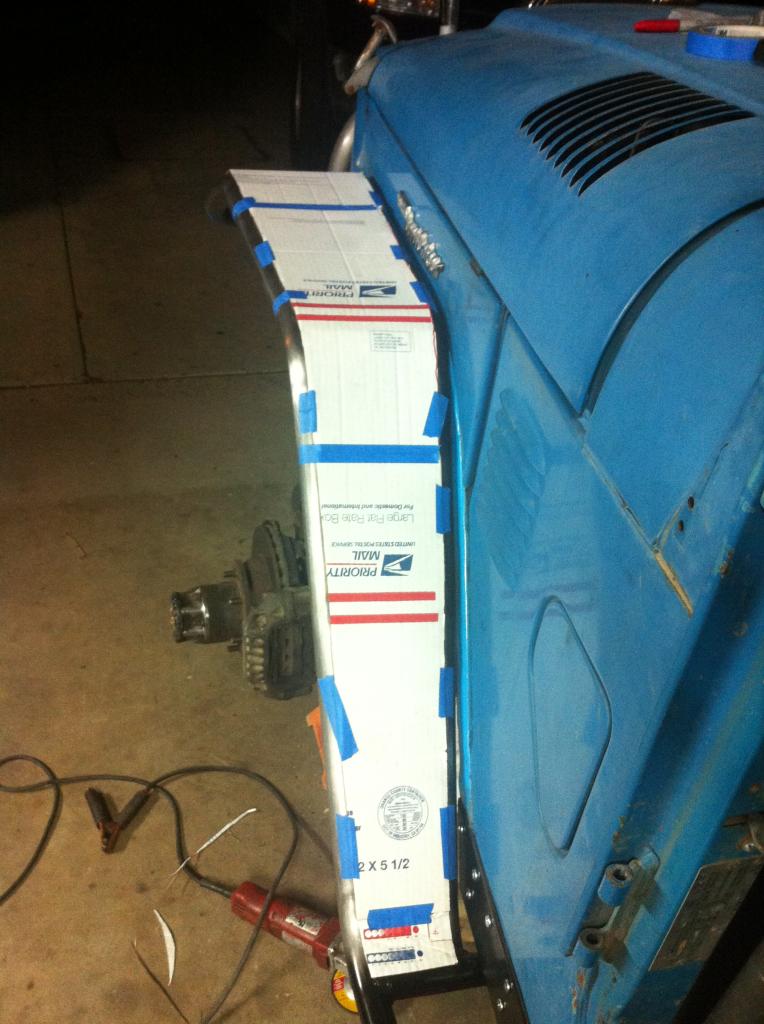

CAD program, thanks to the USPS:hillbilly::hillbilly::hillbilly:
those look great! we need to come back by to tighten 1 bend to 90* at the front on each of ours. I have to double check it first. I hope ours look as good!
Thanks again. You should come take a look at it and we can talk about building fenders.

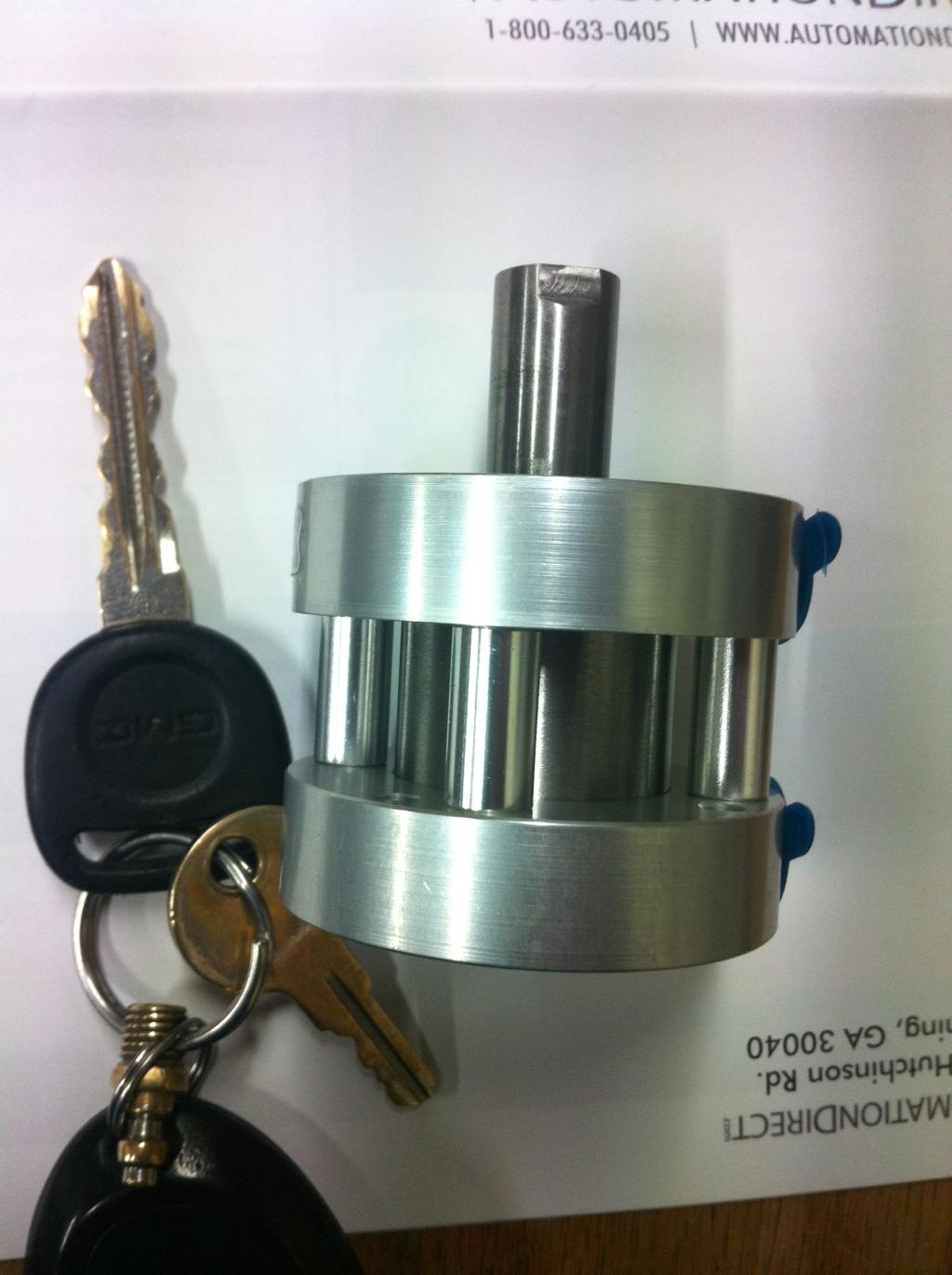

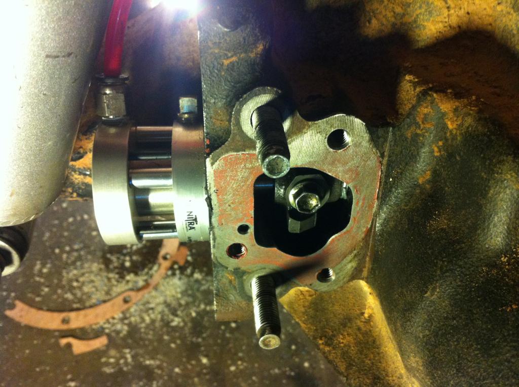

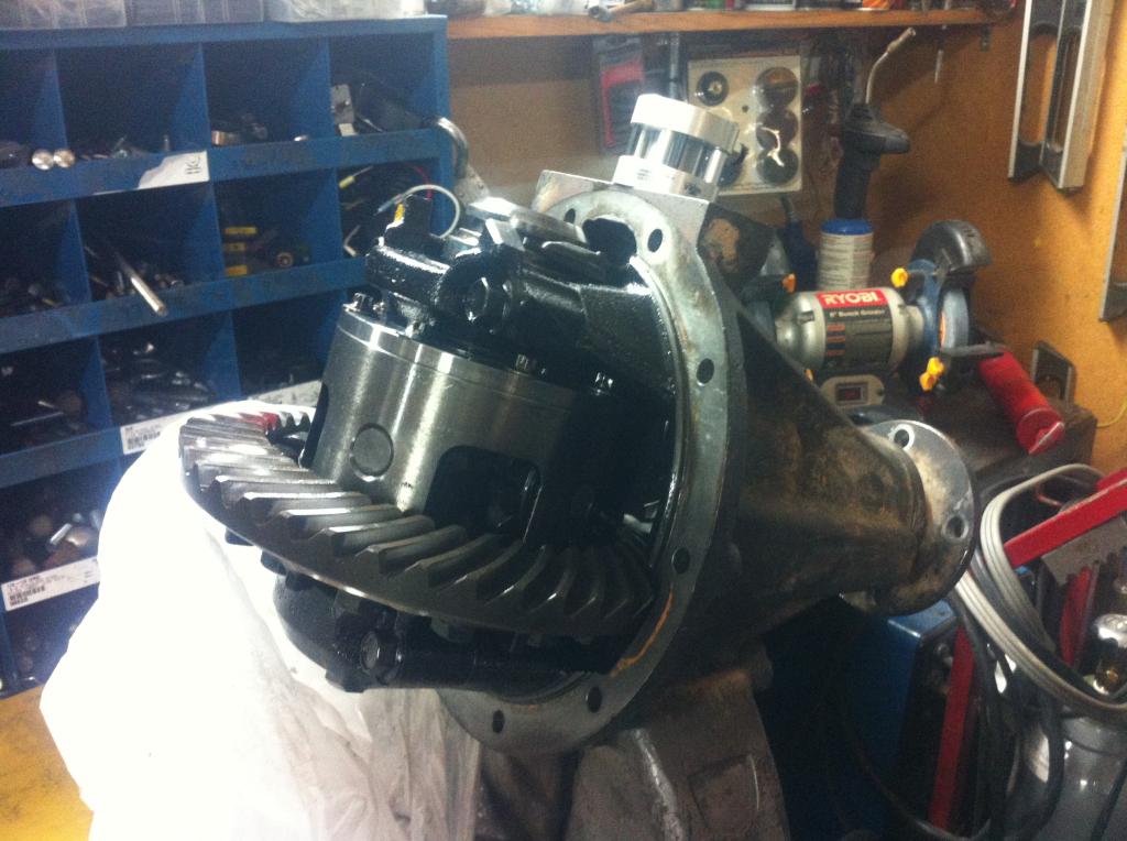

Toyota E-locker that I picked up from u-pull-it then I added this great little cylinder from automationdirect to it
You can see it at the top of this picture

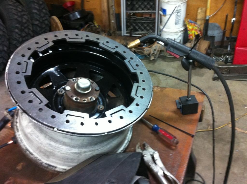

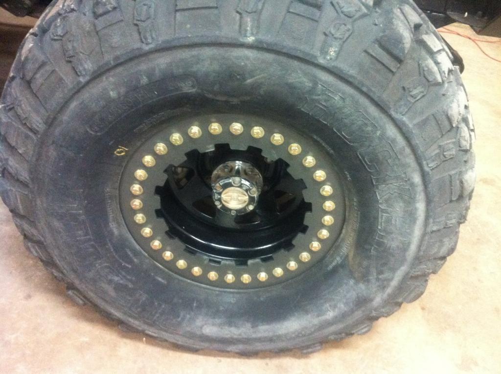

Then Santa bought some DIY beadlocks from Metal Inovations

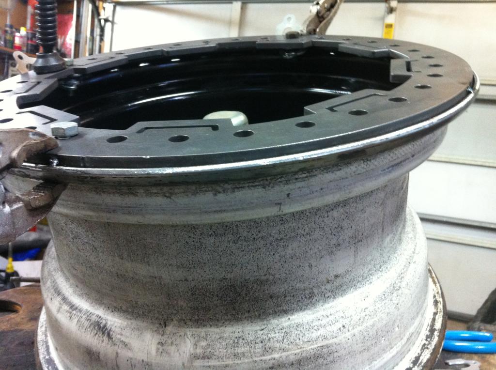

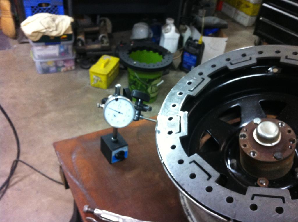

Checking run out

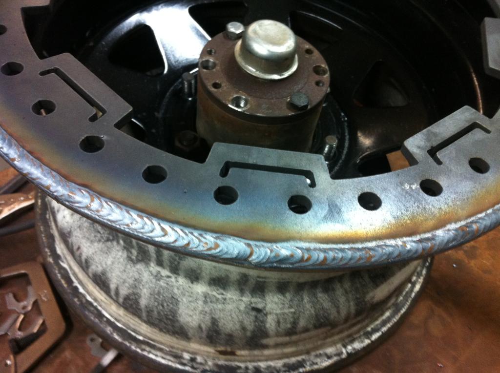

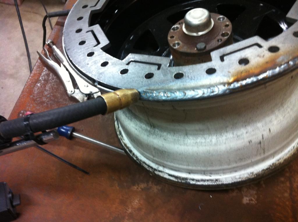

and setting up the mig for a steady weld
it took a little while to get the hang of not moving the gun and just moving the wheel
