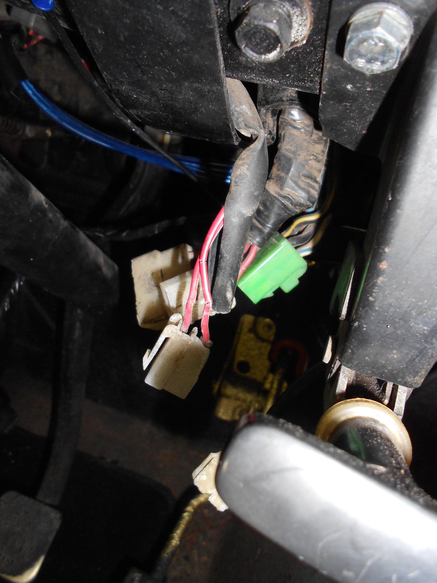

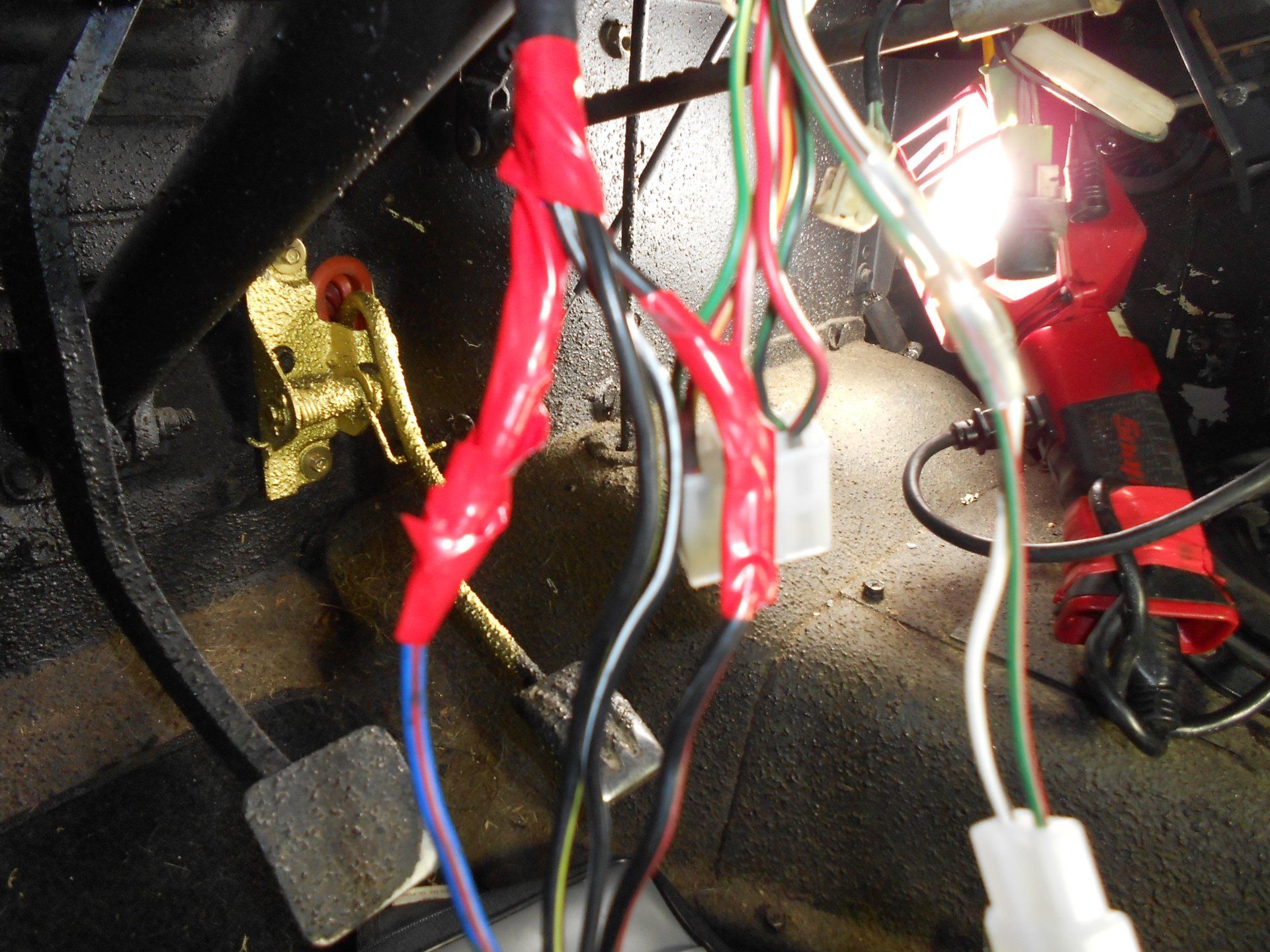

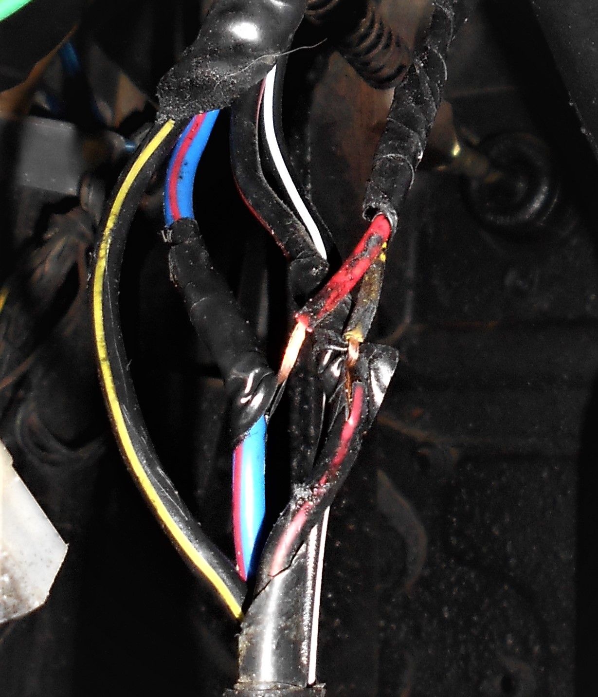

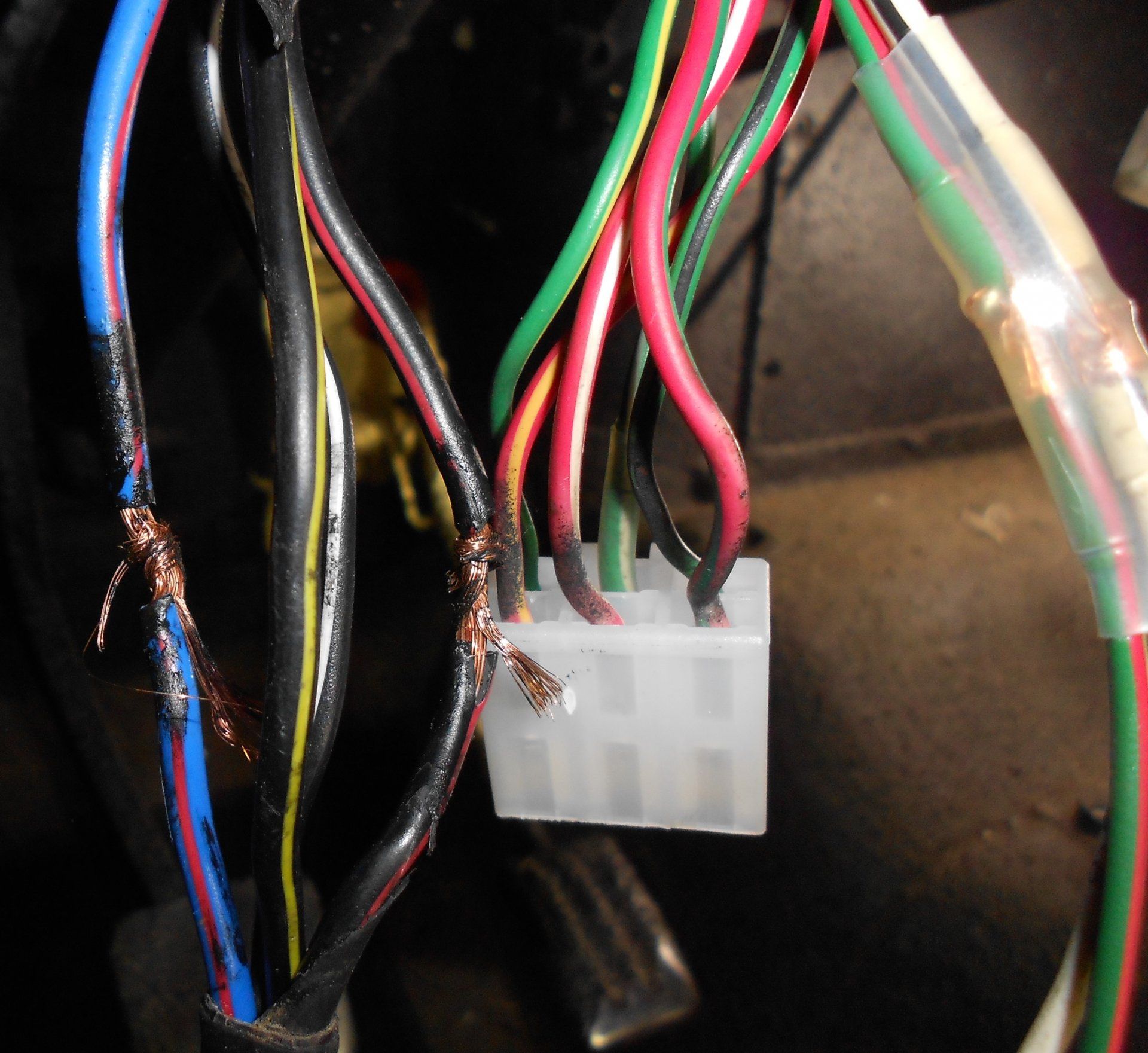

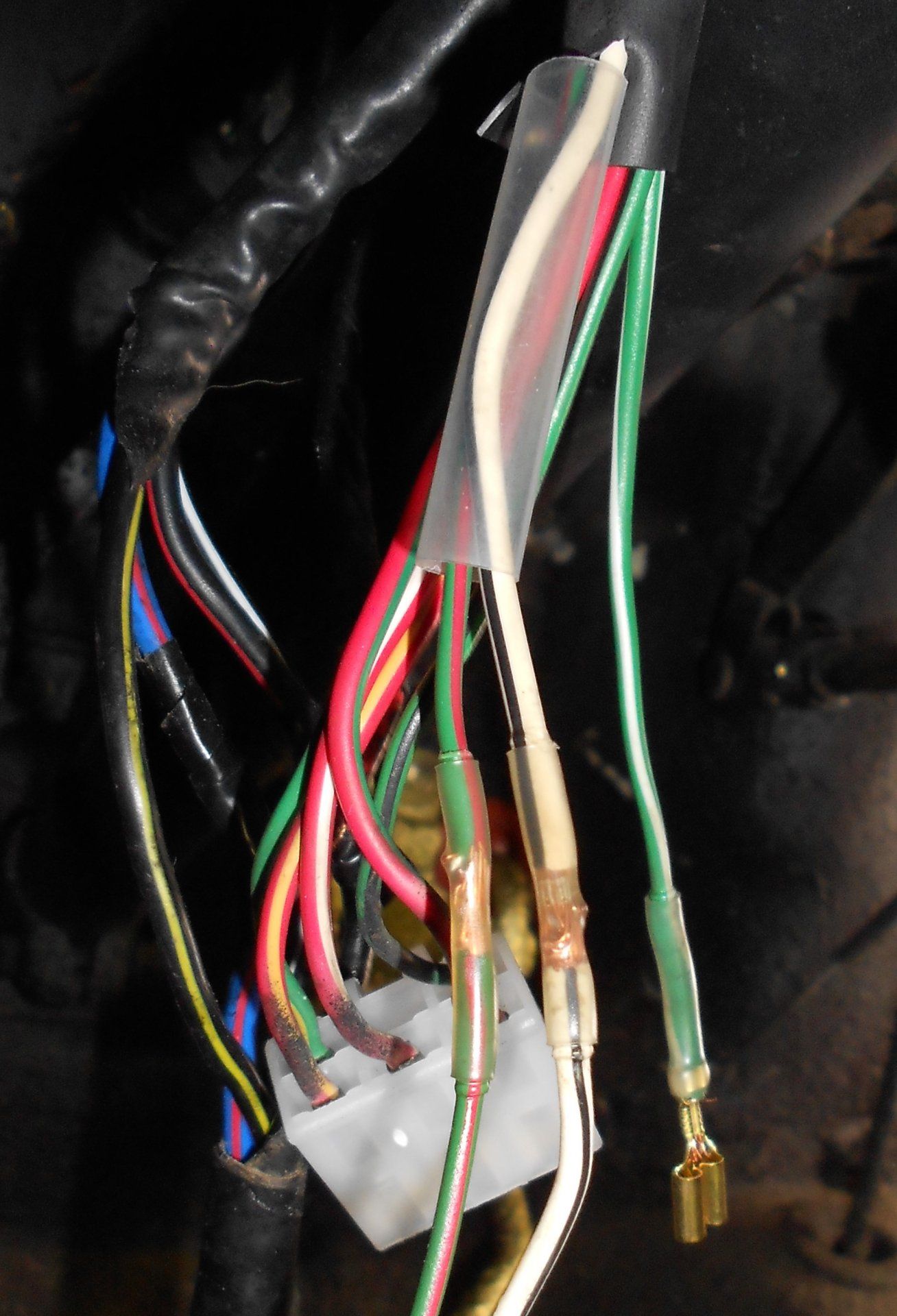

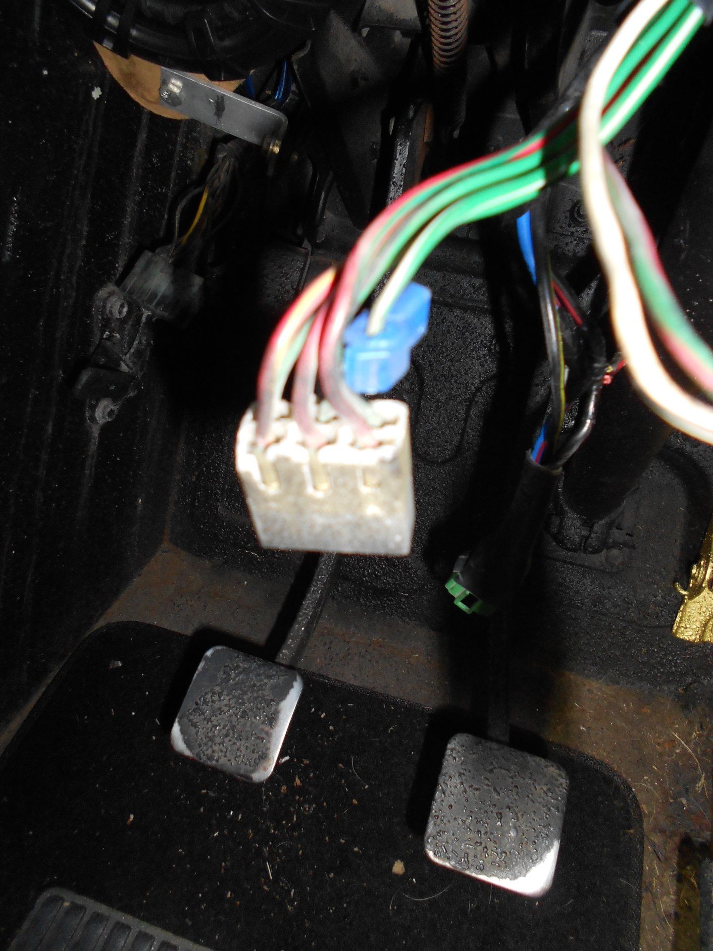

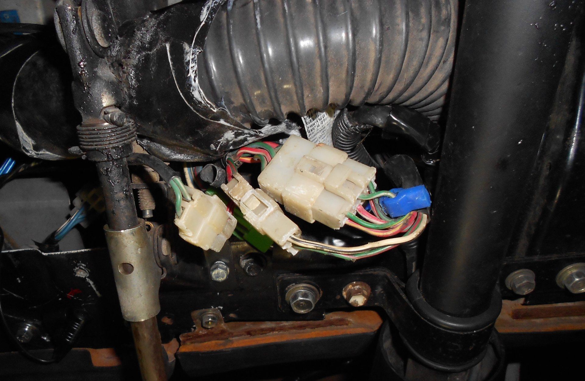

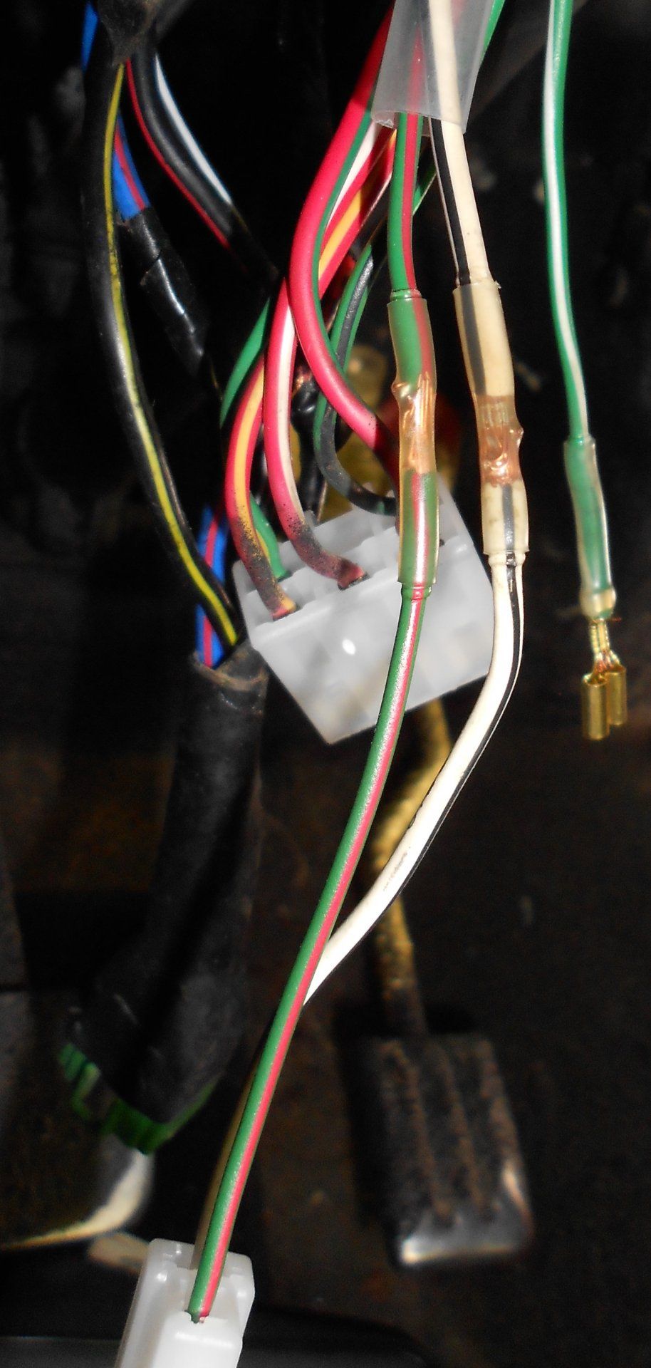

i see this more ofter now at my shop
its a huge labor of love to remody it 1 wire at a time
it can cause all his symptoms above inspect all these under dash plugs very very well
UV rays cause this over age and time i have been told

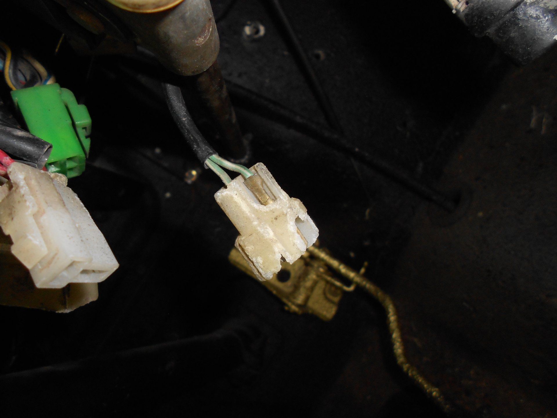

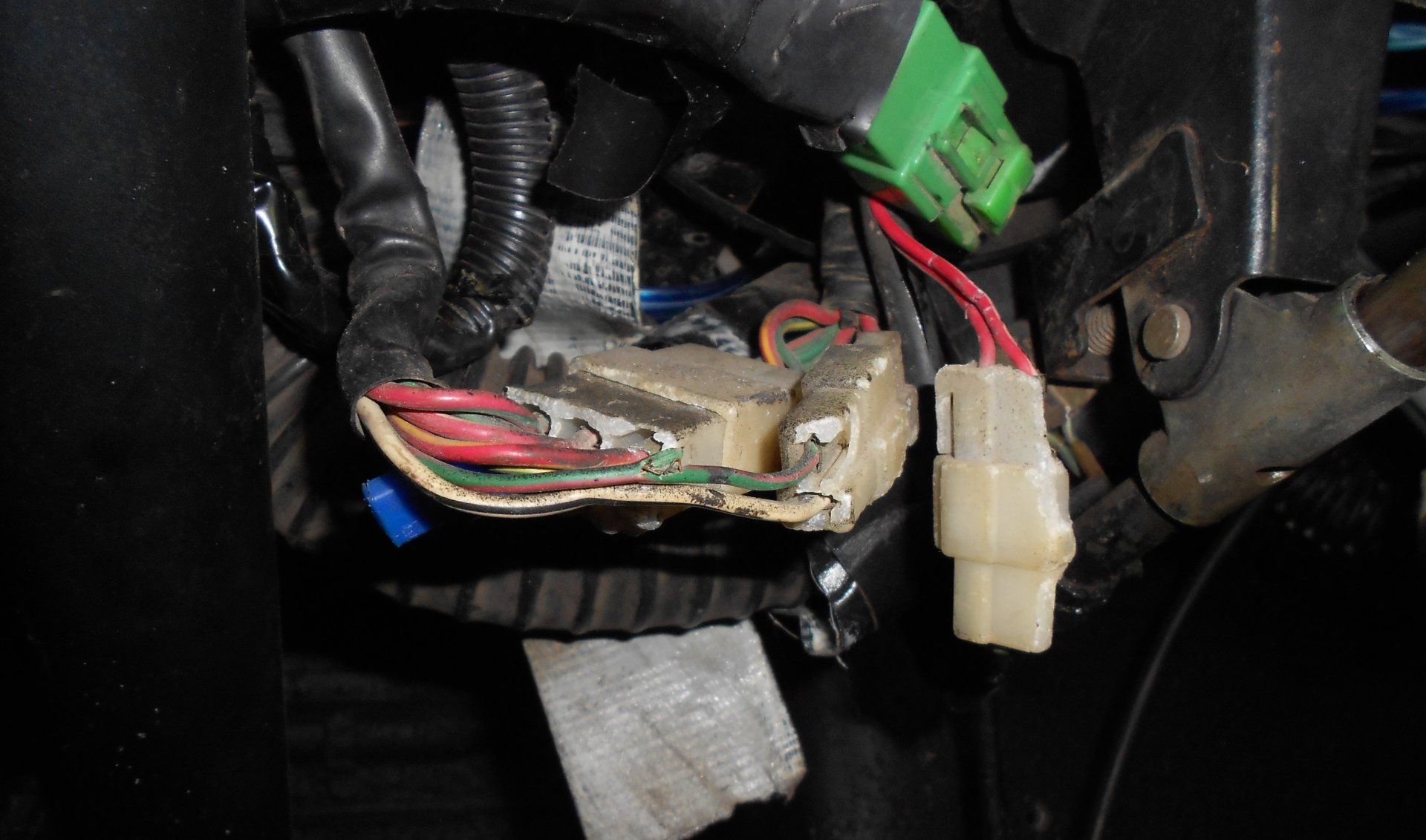

also a possible Internal or external HAZZARD switch stand alone issue too ..............
dont overlook this possible direct cause topic in any way ............
this should be your 10/77 later Hazard switch , photos below of a NOS specimine in my LAB collection for TECH Reference to assist you .............
i help folks with refurbished and restored and NOS hazard switches hands down more then any other switch on any year land cruiser
all years hazard switches can be problem matic fyi
this TECH images proper ID shows the 7pin connector yazaki 2.8 series updated plug , you will be looking for here NO other plug connector under dash even resembles this in visual detail
unplug and inspect in detail male terminals on switch side for arc, melting , burned up it may be clear ad day or minute and hard to tell have sen all extreme levels here
nest look for any melted wires in top switch circut board where solder joints are
any internal short circuit i have ever seen here will leave smoking gun evidence out side like i outline above , so NO NEED to take switch apart ....fyi
good hunting
