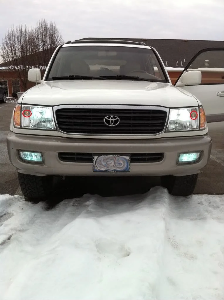

@options2 Awesome thanks! By driving lights are you referring to the lights in the side markers?
Sorry missed this. I mean the ones in the headlight assembly as shown below. They are also the ones that flash when unlocking or locking the truck with the factory remote. This pic is old and before I changed them

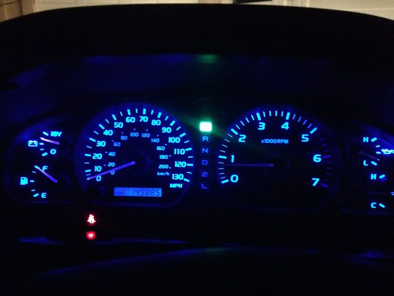

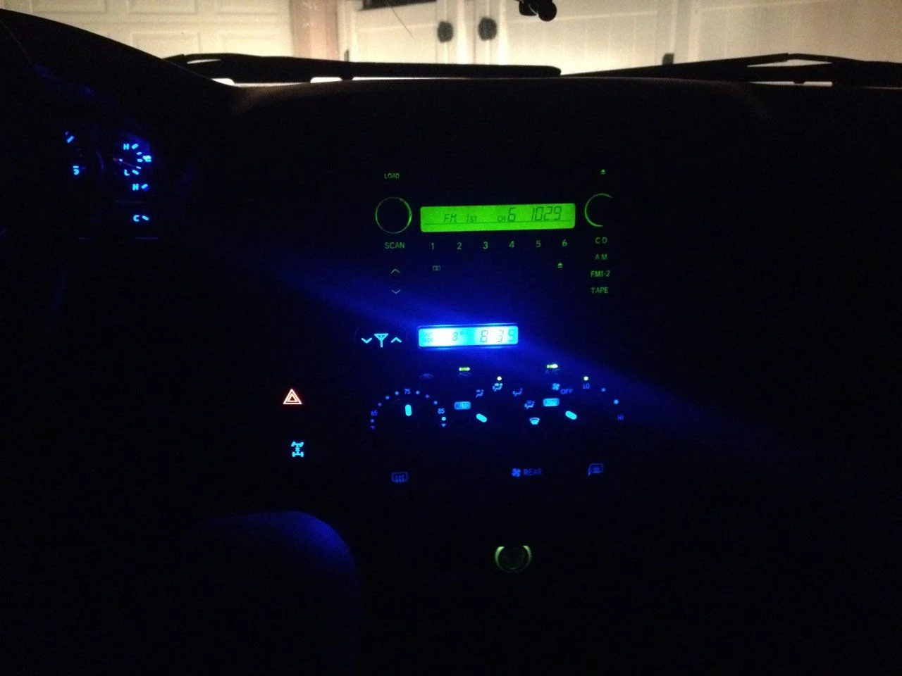

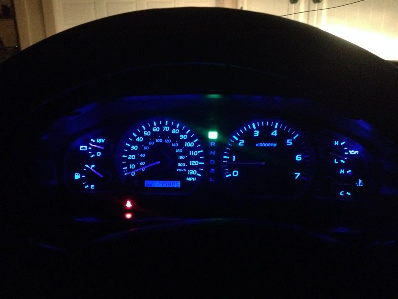

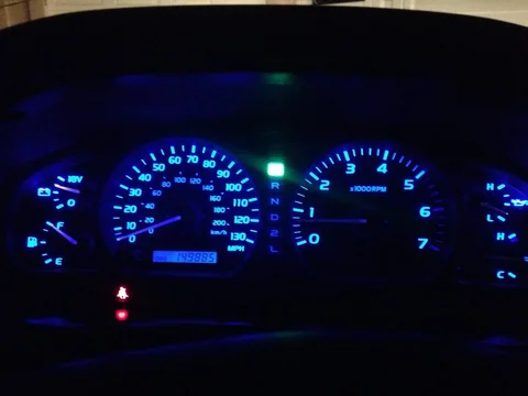

Just finished up changing all the lights in my cruiser over to blue LEDs and figured I would post up these pics, as I hadn't seen photos of an all blue gauge cluster yet.
Thinking the clock is a little too bright and might go back to put some wax paper behind it...... A little tired of messing around with dash pieces for right now though!

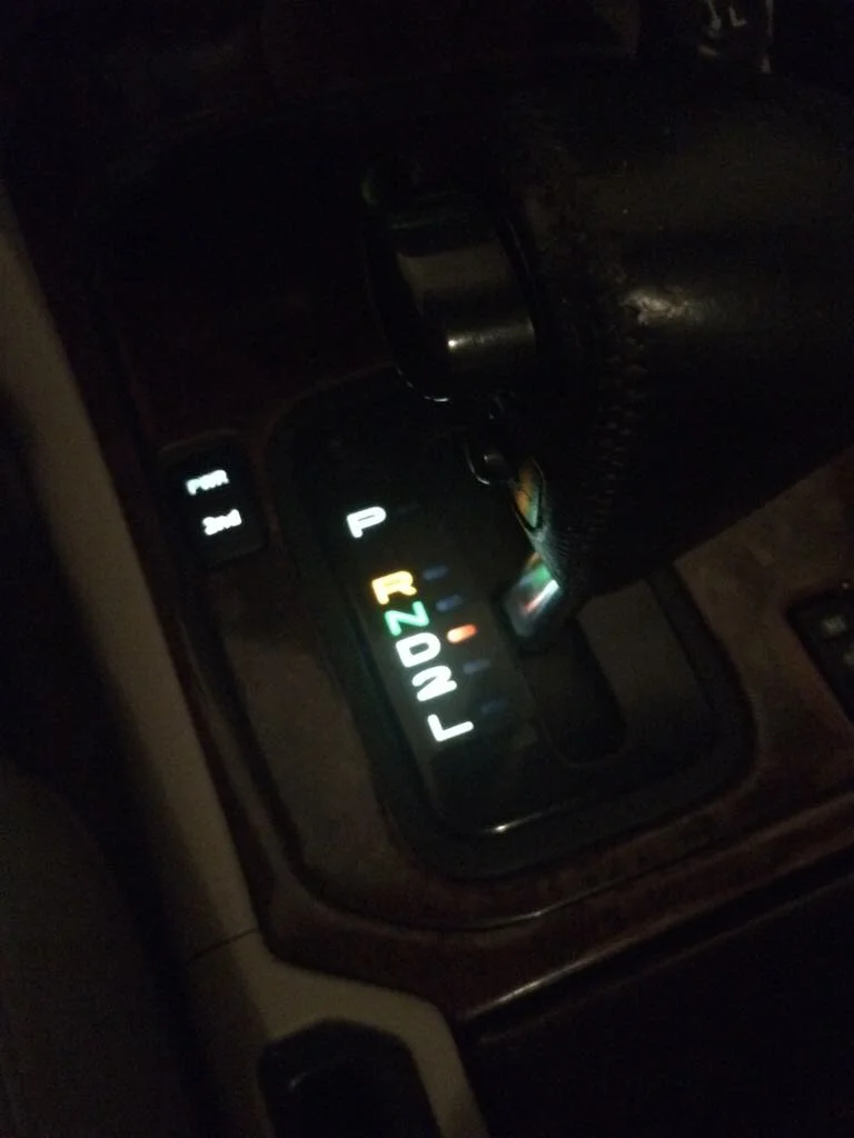

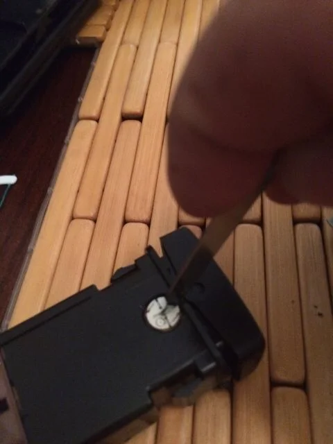

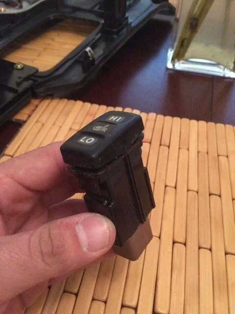

Just did my center console.
The switches pop out. Look for the white button. It's where the bulb is. Using a small flat head, turn and pull the bulb with a tooth pick.
Here is where the bulb for the shifter is. Simply twist, pull out swap bulbs and reverse the process.
Final results.
