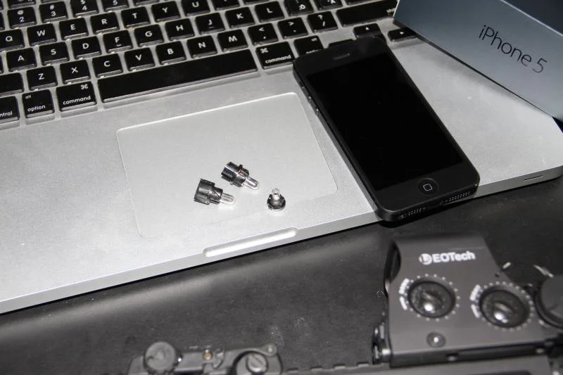

This has to be one of my favorite mods I've done to my truck. Makes night driving so much more enjoyable to be able to clearly see my instrument panel. If anyone is considering doing this and is on the fence - do it - you won't regret it. And it's cheap and really easy to do as well.
So do the blue and black bases pull out of the cluster and the light snap into those? My D light is out, didnt like it at first because I had just bought the thing, now....I like it.

Whats the EOTech attached to?
New trigger too I see......atleast you got the good stuff
Quit the tease. :D
